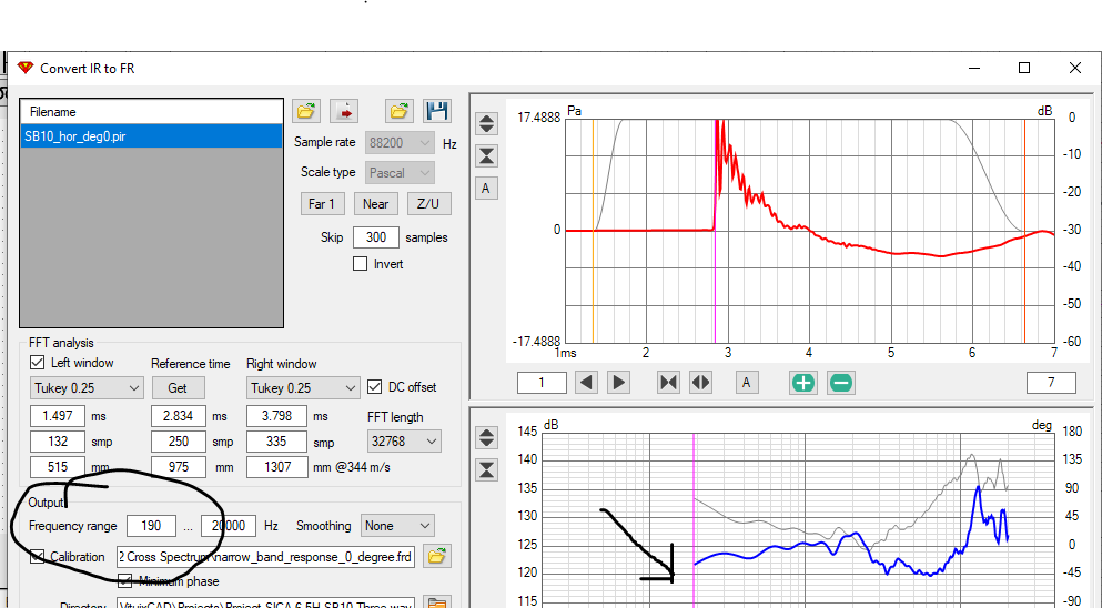

I don't follow, I am talking about measurements that have been done in the past. So older datasets.
I also don't follow what you mean with "measurements instructions"
Measurements are done with ARTA as usual.
Although these days the only change I am making is doing the time window in VituixCAD. Which still gives extrapolated and false data below the time window frequency.
Joined 2003
Those settings are for the frequency response output, only the calibration file and “min phase” checkbox underneath are relating to the mic calibration.
Following the instructions for data generation, you would fill in the low frequency data with a near field measurement, so the extrapolated data in the windowed far field measurement becomes irrelevant.

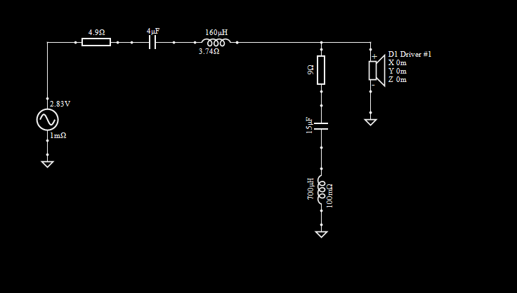

Hi, thanks for this wonderful software!
I'd like to ask how to lay out an RL circuit for this tweeter in the crossover tab.
I'm trying to shelve the response peak above 10k
This is my circuit so far
When I add an RL circuit in WinPCD I can flatten the curve like this:
PCD is unclear to me when showing the RL in the schematic and I don't know how to do the same thing in Vituix.
Can anyone help? Thanks!
