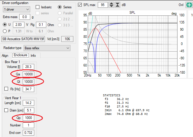

I have a question regarding enclosure tool. My issues is, that when I am looking for good bass-reflex box for different drivers, I always get f3 much higher than for example Madisound (like f3 of 36Hz for Satori MW19P-8), and for the same set of data (28 liters, port dimensions 50x150mm) Vituix is showing me 46 Hz :O
Similar story for other drivers I tested - Wavecor WF223 for the same parameters - 37Hz in BassBox, 42 in Vituix.
Therefore I wanted to ask what is from with the software or what I am doing wrong? Variances on the f3 and port dimensions are really high.
Any suggestions what can I do in order to see proper data?
