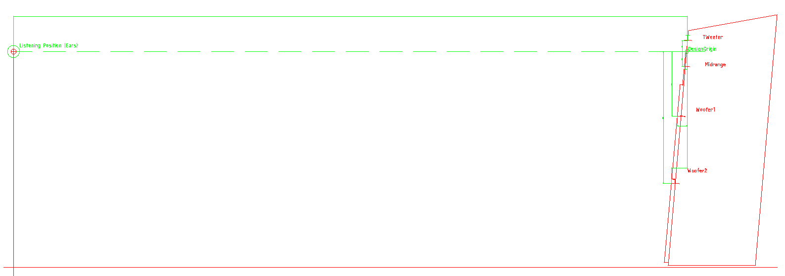

Understanding VituixCAD geometrical design conventions

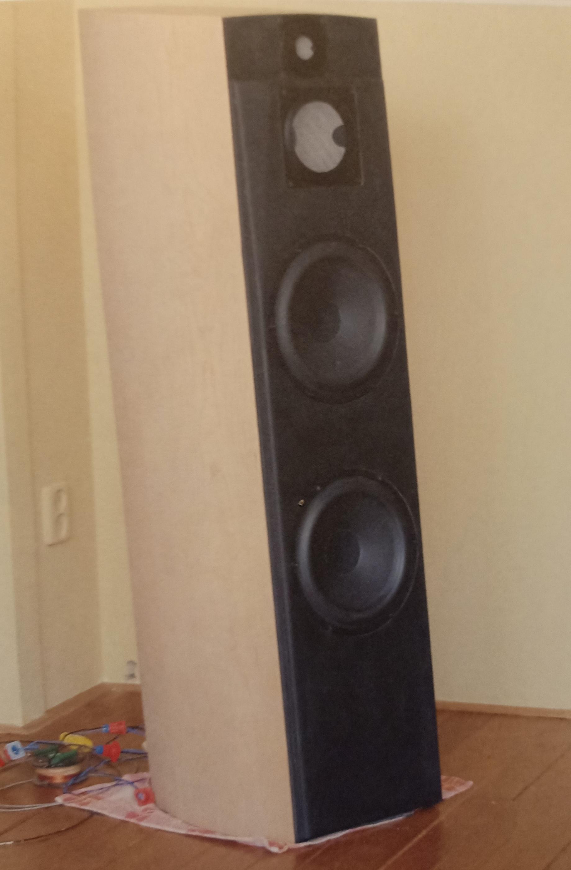

I am studying the VituixCAD system in preparation of measuring and designing the crossover, and right now i am uncertain regarding the tilt of the baffle.
As can be seen on the attached images, the baffle tilts backwards by 5 degrees in my way of telling.
If i get the geometrical design convention of VirtuixCAD correctly, it means a tilt of -5 degrees. Am i correct in this?
Also just to check, if listening distance is 3000mm at a height of 990mm above floor, list-dist is Z=3000mm and where floor is mentioned the distance is Y=-990mm. Am i correct?

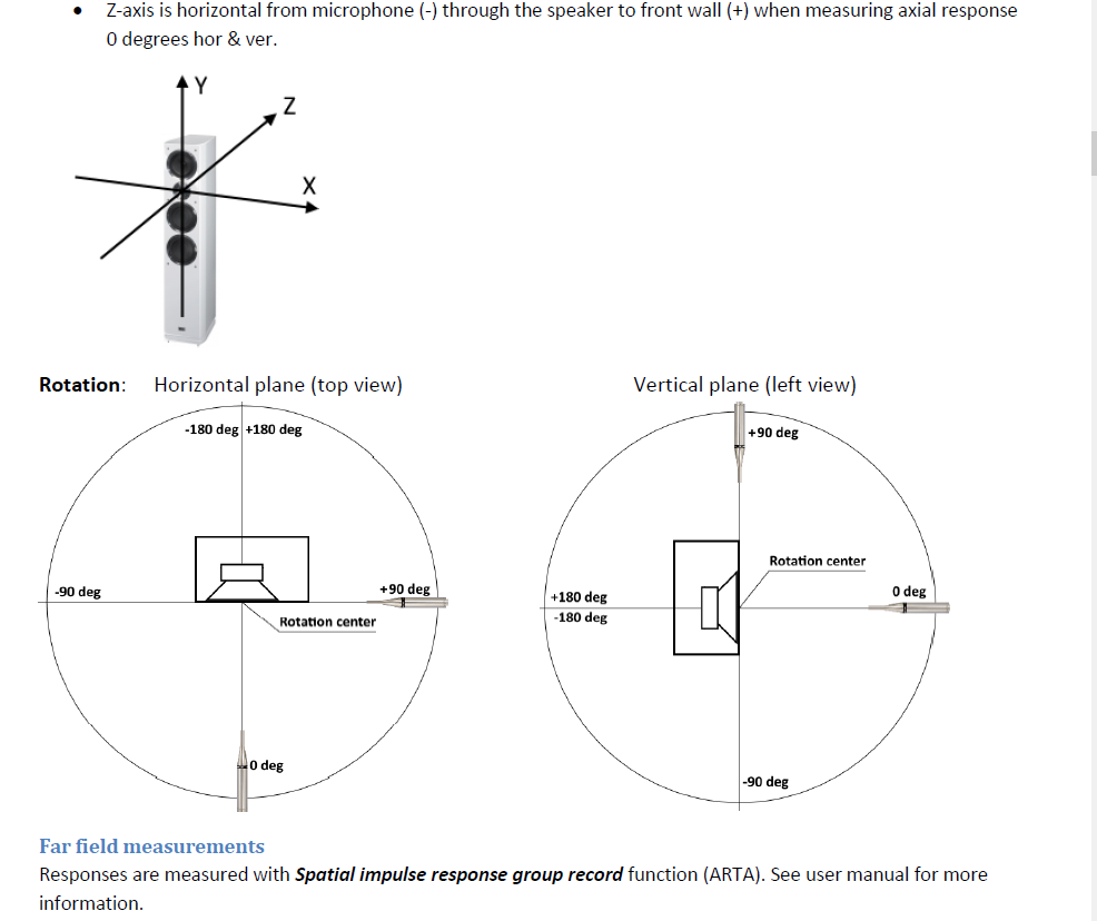

What is two channel measurement? Is it the same as what is described in the ARTA documentation, where one channel of the audio interface is used for loopback for accurate timing, and the other channel has the acoustic data from the mic?
Check posts #309 and 310 in this thread: VituixCAD v2 - Page 9
Thanks, clarified my question. So in my case it is +5 degrees.

Next step a turntable that can handle size and weight (80kilo) . Will be using a thick round table top of ~90cm with a center bearing and rollers near the edge.
Interesting project to finalize the design that started in 2006( the picture is from that year).

The cause of my confusion about the negative or positive angle comes from the picture as shown in the VituixCAD_Measurement_Arta.PDF. The angle convention in vertical plane , i would interprete that the angle of a baffle tilting back is a negative angle. But in the Diffraction tool, i simulated with different angles and a positive angle was needed.
