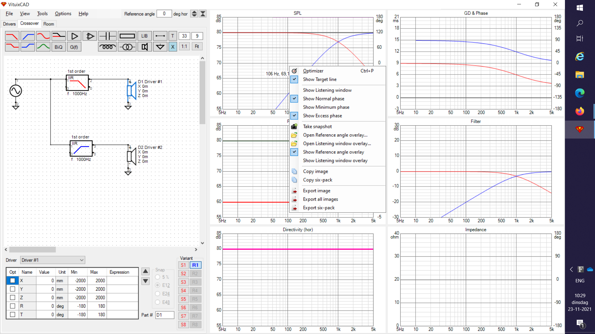

Right click on any of the graphs you want to modify to open a popup menu. Click "Traces..." on the popup menu to modify the traces on that particular graph.
Draki is showing traces window on the SPL graph so right click on the SPL graph and then "Traces...", top left of the six-pack.
