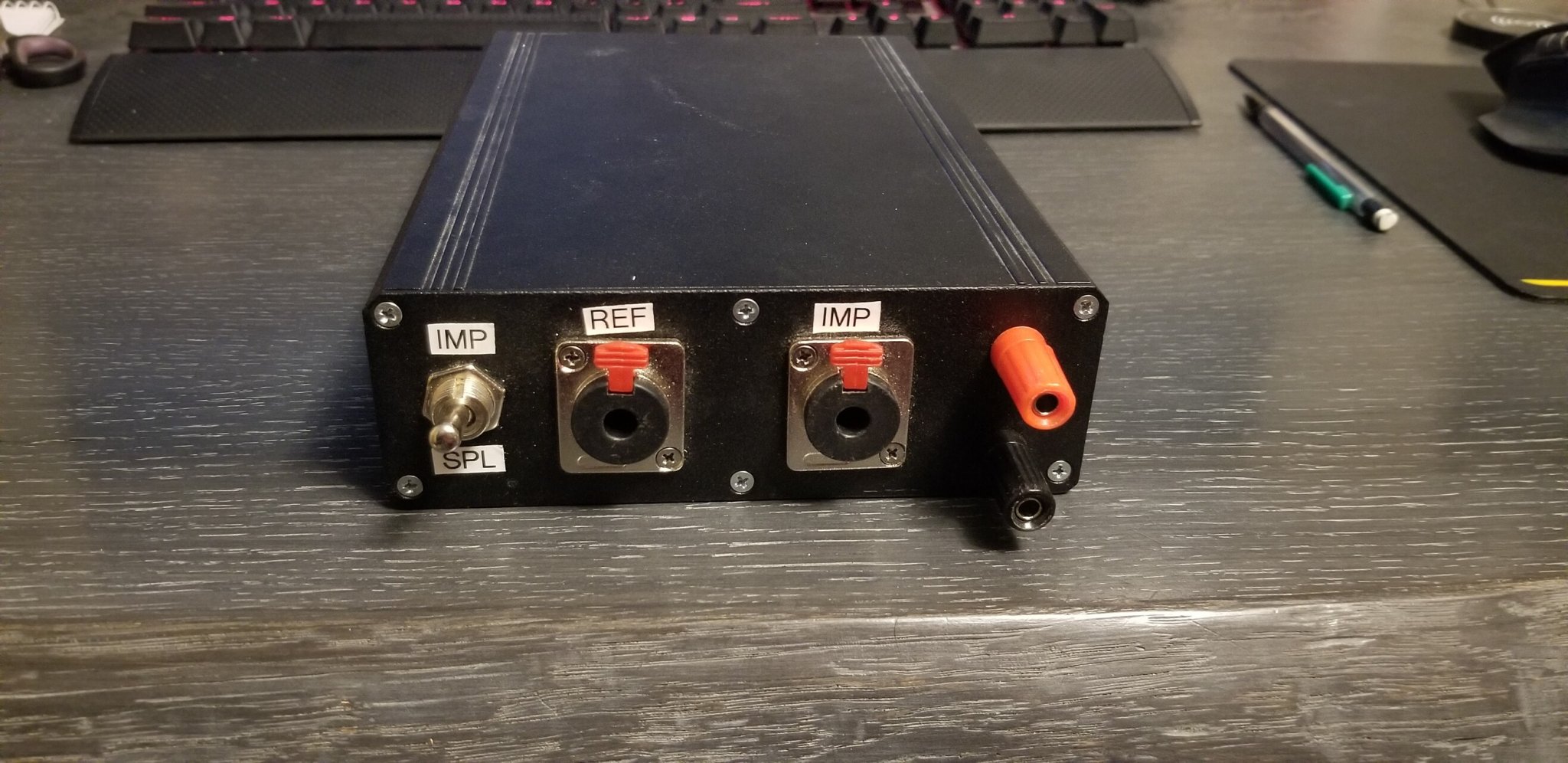

The jig that I use is just a simplified version of the ARTA jig here:
https://artalabs.hr/AppNotes/AN1-MeasuringBox-Ver2-Rev3Eng.pdf
I designed it to be used in conjunction with a USB audio interface such as the Steinberg UR22 or Motu M2 or similar. If you want the cheapest option out there that is "good enough", look at the Behringer UMC202 or UMC204.
It uses TRS connection, so it's just a few resistors and some connectors and some short patch cables to patch it into the USB interface. On a USB interface the TRS pins are not energized with phantom power, only the XLR pins are. The 10 ohm resistor should be at least 5W, the other resistors can be small basic 1/4W.
It is detailed in the ARTA jig document, but I have included a spreadsheet that calculates the attenuation provided by the probe resistors, so you can understand why the values are what they are and adjust them if needed. 20kOhm input impedance of the audio device is assumed, but you will notice that Zin from 10k - 100k doesn't make that big a difference in the attenuation result. Consult your audio device specifications for the input impedance. The voltage and power calculations really only come into play for high SPL testing such as distortion. For normal frequency response, generally <1W is needed.
It is important to use the jig with single ended amps only. Low cost class-D chip amps are generally BTL connected internally and cannot be used.
My recommended process moving forward to start into DIY speaker design is as follows:
1. Purchase a USB audio interface. I use the Steinberg UR22mkii, a low cost alternative would be the Behringer UMC series of products.
2. Purchase measurement mic. I use Line Audio OM1, look at Sonarworks SoundID for a low cost solution to get started.
3. Build the jig. Just a few resistors, connectors and some scrap wire can get you started.
4. Play around with ARTA/LIMP. All features are available to play with for free as shareware, you must purchase a license to save the measured impulse response which will be very convenient for VituixCAD.
5. Purchase ARTA License and have fun making speakers. From here you can start by following Kimmo's guide for ARTA measurements for VituixCAD.
