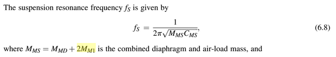

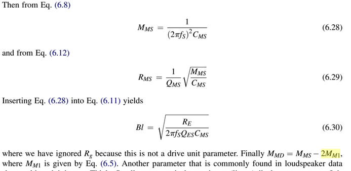

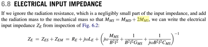

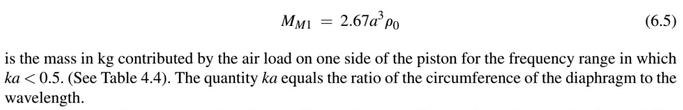

Calculating everything with Mms (published on datasheet) without splitting into Mmd and two possible/probably different air loads is quite common though clear simplification causing some errors and limits what can be simulated. VituixCAD plays with this simplification familiar also with some other tools such as WinISD and UniBox. IB simulation gives the same result as closed box with infinite volume.A short remark on correctness of simulation of Infinite Baffle in VituixCAD.
Especially horns and transmission lines require different approach. In addition, air load is frequency dependent so Mms = Mmd + Mm1 x some constant value is not fact with wide range of radiating areas and compliances.
Anyway, "Acoustics: Sound Fields and Transducers" by Beranek & Mellow says:
Generally speaking, the added mass is a slightly different representation of the radiation reactance. We recently discussed this briefly in the ath4 thread. Anyway, VituixCAD is great software, thanx for it !Especially horns and transmission lines require different approach. In addition, air load is frequency dependent so Mms = Mmd + Mm1 x some constant value is not fact with wide range of radiating areas and compliances.
Increasing Mms alone decreases sensitivity so simulation of other than simplified direct radiators have to be smarter. So much smarter that VituixCAD Enclosure tool might remain as isGenerally speaking, the added mass is a slightly different representation of the radiation reactance

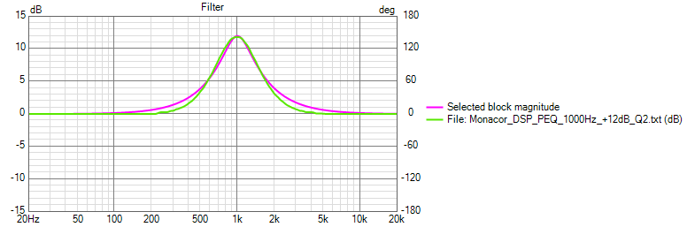

What DSP option in the system list in Options window should i use when using the Monacor DSM-48LAN?
Impossible say without measurements of few transfer functions or screenshots from their design software. Following responses are needed:
1) Parametric equalizer 1000 Hz, +12 dB, Q=2.0
2) Parametric equalizer 1000 Hz, +6 dB, Q=2.0
3) 2nd order shelving low pass filter 1000 Hz, +12 dB, Q=1.0
4) 2nd order shelving low pass filter 1000 Hz, +12 dB, Q=0.5
5) Bessel low pass filter 24 dB/oct, 1000 Hz.
What is sampling rate? Probably 96 kHz because promised band is up to 40 kHz.
Note1: More responses are needed if DSP has BW or Slope parameter instead of Q.
Note2: Cannot promise support if Monacor has proprietary biquad calculation (such as Lake or Hypex). Brands using other that RBJ compatible equations will be ignored.

Please check the following information:
Request 1 - Parametric equalizer 1000 Hz, +12 dB, Q=2.0
Request 2 - Parametric equalizer 1000 Hz, +6 dB, Q=2.0
Request 3 - 2nd order shelving low pass filter 1000 Hz, +12 dB, Q=1.0
Note: I couldn't found a way to select the Order and the Gain of the low pass filter, the option for Low Pass filter only allow Frequency and Q.
Request 4 - 2nd order shelving low pass filter 1000 Hz, +12 dB, Q=0.5
Note: Same as above
Request 5 - Bessel low pass filter 24 dB/oct, 1000 Hz
Notes:
Please inform me if this enough, if not, please specify whatever information you need, i'll do my best to get it.

Yes, Low Shelf was needed.
BUT there's severe problem with parametric EQ. Shape is not analog equivalent or RBJ compatible digital or dbx compatible familiar with some graphic equalizers. It's something else which cannot be supported at the moment.
Green trace is Monacor, and magenta is closest available with Q=2. So Monacor is out of the game without document how biquad coefficients are calculated.
Equations for peaking filter by RBJ. This is compatible with most of the DSP devices and apps:
Equations to calculate b0...a2 for Bell filter in Monacor DSP is needed.Fs (the sampling frequency)
