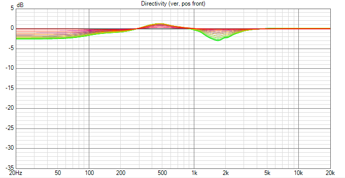

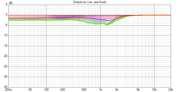

Is this normal? Screenshots attached of the same system, except one is using standard LR24 electrical for all filters while the other is using linear phase LR24 electrical. Pretty huge difference in off-axis behaviour IMO.
