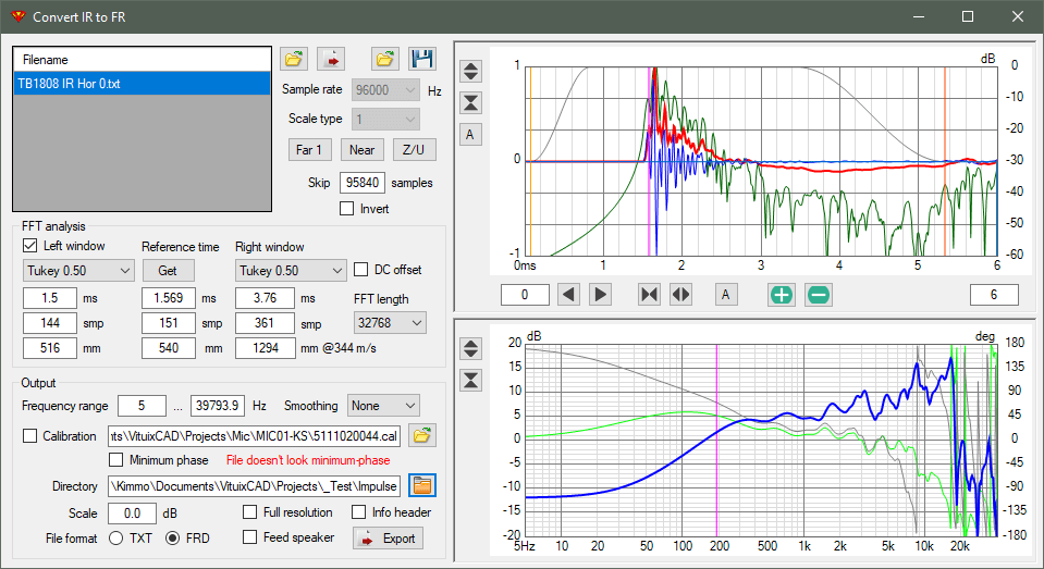

I've attached the specific impulse measurement for your reference. The extra 1 second of dead space appears to be embedded right at the start of the impulse response files where it says " -1.0000847343750001 // Start time (seconds)"

It works perfectly here though header is kinda illegal. Lines in red are meta data / comments so they should start with * or // or some letter.
96000 // Peak index
262144 // Response length
1.0416666666666666E-5 // Sample interval (seconds)
* Data start
9.746083E-6
1.7689896E-5
1.3315486E-5
Cheapest trick to skip samples in the beginning is using 'Skip samples' field
For example ~95840 in this case with 96k dummy samples in the beginning.

I agree that the file formatting from REW is not correct, however I don't think the way REW is adding in comments to the file is the main issue here. If I export to .wav instead of txt, the same issue exists.
I tried as well removing the "//" comments, but the file is not loaded properly if I do so, it is still an illegal MLSSA file, so VituixCAD is somehow parsing the file more correctly when the comments are kept within the file.
Skip samples is a solution, I am just trying to determine why REW is deciding to place 1 second of dead space behind the impulse, rather than export thew measured impulse from t=0. Skip samples is more of a bandaid solution for a problem that shouldn't exist, but that is more of a REW problem than VituixCAD.
For VituixCAD, I did a bit more testing, and determined the issue is with the ETC plot. With impulse starting at 1k samples, ETC is not displayed, and the click and drag functionality works if I turn off display of ETC, or skip 95840 samples. It is an odd issue, I only seem to be able to reproduce it if ETC display is enabled, then close and open the IR - FR window and load the file. Hope that's a good enough description to reproduce the problem.

Adding extra samples is mandatory in single channel mode because program adjusts location of t=0 by detecting peak maximum. IR could start quite much before peak max especially if (FIR) system has pre-ringing or some radiator or radiating part is in front of radiator producing the highest peak. This headroom is 300 samples in ARTA. The same method could exist also in dual channel mode (such as in ARTA) though reference channel sets IR to correct time position and any working system cannot forecast measurement before signal is sent to DUT. Program could also have full amount of reserve samples on the negative side for distortion analysis though it's not needed while conventional frequency response analysis. Just guessing possible reasons...I am just trying to determine why REW is deciding to place 1 second of dead space behind the impulse, rather than export thew measured impulse from t=0.
Yes. At the moment ETC has 32k FFT beginning at sample 0. I can try to locate that frame so that peak stays inside also with this kind of data.the issue is with the ETC plot.

Saving IR response as TXT in REW can work, retaining the measured time of flight.
In REW:
IR settings, set reference time to 0ms, left window 0ms, right window 1000ms.
Export IR, uncheck normalize, check Apply IR window.
Result is a useful TXT file that will import to VituixCAD with timing in tact. Only a small change to VituixCAD txt file parsing is needed to retrieve information like the sample rate from the REW impulse file, but it is perfectly functional in the current state.

2.0.83.1 (2022-02-02)
Convert IR to FR- ETC window is positioned according to impulse peak.
- ETC length reduced from 32k to 16k samples.

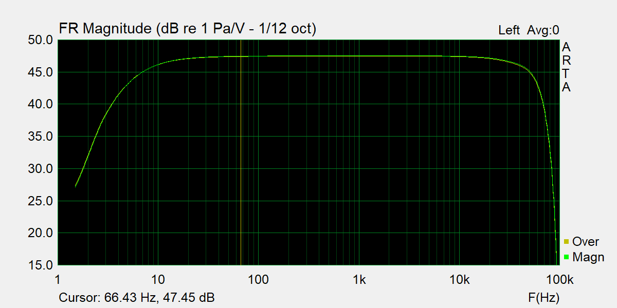

FWIW, channel comparison of a Steinberg UR22mkii, I think we can say "good enough" here:
