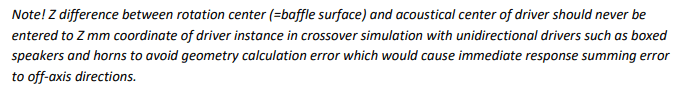

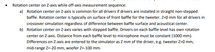

When i adjust the Z-axis of a driver in vituixCad, does positive numbers move it closer to the "mic"?

Pls see below (from the V2 measuring manual)
