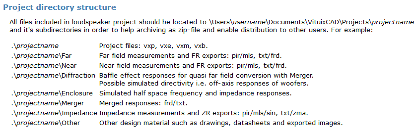

Relative paths will work more convenient, but otherwise it would already help just to point to a certain folder, instead of having to do every bit manually.
Sub-folder names are not important in that recommendation so data for each driver can be separated to own folder below projectname. Relevant thing is that all "project" files (vxp, vxm, vxe, vxb, vxf) which refer to separate response files are in the same folder or above the response files. Then all file references remain relative without rooted filenames, and whole project can be archived or distributed e.g. to different language region with different folder naming. Saving measurement files in different folder than Documents\VituixCAD\Projects\projectname\... is the most common mistake. Measurement data (far field, near field and impedance) is typically project-related due to box/baffle, and may have project-related reference time, directivity processing etc.
Few users have suggested "packing" response files to vxp to improve working with cloud or removable drives. xml could include them for sure, but there are few issues. Not severe, but it will double, tipple or more everything and would not help with performance when e.g. delay in Drivers tab is adjusted and whole data is read to memory.

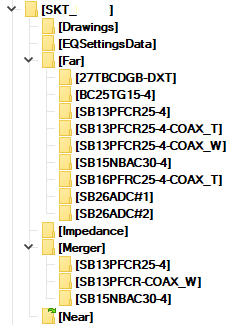

Here is my style for directory structure. That is one project with many driver options. All drivers have own directory for far field - of course because 37 off-axis responses/driver as raw and frd. Woofers and mids need merging so they have own directories. Near field and impedance files are easy to find and select from common place.
I guess the main difference is that a lot of people like to work per project folder and than have subfolders.
Instead of having subfolders with bits of the projects scattered all over them.
So in this example they would use a [SB13PFCR25-4] as the main folder.
Within that folder there will the [Far], [Impedance], [Merger], [Near] subfolders etc.
Or most of the time, they would have the speaker name as the main project folder, followed by the used drivers, followed by the measurements, merger, impedance folders etc.
Also, I have seen many people storing their main measurement files on an external location to keep it safe and organized (with a RAID setup as redundancy), instead of diving into the Documents folder of Windows.
Therefor I would not call saving measurement files in a different folder a "mistake", it's a very common workflow.

Yes, that is technically equal to recommendation as long as project files (vxp, ...) are in the project directory. I could even add this alternative to user manual.So in this example they would use a [SB13PFCR25-4] as the main folder.

It's a mistake if it does not support distribution without damaging the project. User Documents is one of the main directories which is / should be backed up, and raw measurement files are project-related - as already mentioned so there are no mandatory reasons to act differently.Therefor I would not call saving measurement files in a different folder a "mistake", it's a very common workflow.

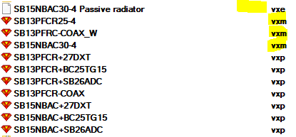

At least my projects usually have multiple speaker projects files (vxp) for different driver combinations so multiple projects compete renaming and copying/moving the same files to (possibly) different locations. Also vxm, vxe, vxb, vxf projects have references to external files so there could be quite a mess. For example project with previous folder structure has 11 project files (without vxb and vxf).
Duplicating inside vxp is still the safest option though it multiplies number of response files by number of project files (linked together). One option would be using the same packing algorithm with saving of cal/mic files. Error is quite small.
