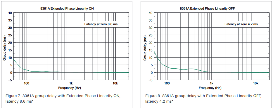

Some DSPs have limits for linear-phase crossover. For example designer has to use the same type and order for LP and HP though corner frequencies are adjustable independently. Also tap limit could prevent "optimal" result. It has happened at least once that I have not succeeded to create better sound with FIR compared to IIR. IIR was not too lame and weak, but had better sound balance and directivity features due to better tools for driver matching.FIR capable system can make very flat response, perfect timedomain
It's also possible that wide-band transients don't sound remarkably strong with minimum phase response. This has happened once. Side woofer concept is one possible reason. But usually simple 2-way is able to reproduce piano hammer properly no matter XO order while especially 3- and 4-ways with steep IIR slopes have never succeeded.
Latency requirement is one possible limit. For example Genelec has nowadays two latency options with better or worse timing. Not sure but I've probably listened the last one (before GLM was updated including both options). The first one looks typical achievement in DIY scene.

About zero phase, this article came out a while back;Some DSPs have limits for linear-phase crossover. For example designer has to use the same type and order for LP and HP though corner frequencies are adjustable independently. Also tap limit could prevent "optimal" result. It has happened at least once that I have not succeeded to create better sound with FIR compared to IIR. IIR was not too lame and weak, but had better sound balance and directivity features due to better tools for driver matching.
https://audioxpress.com/article/zero-phase-in-studio-monitors
Although the only reference is Flooyd Toole's book, it is in line with other research as well.
And also in line with my own experiences.
