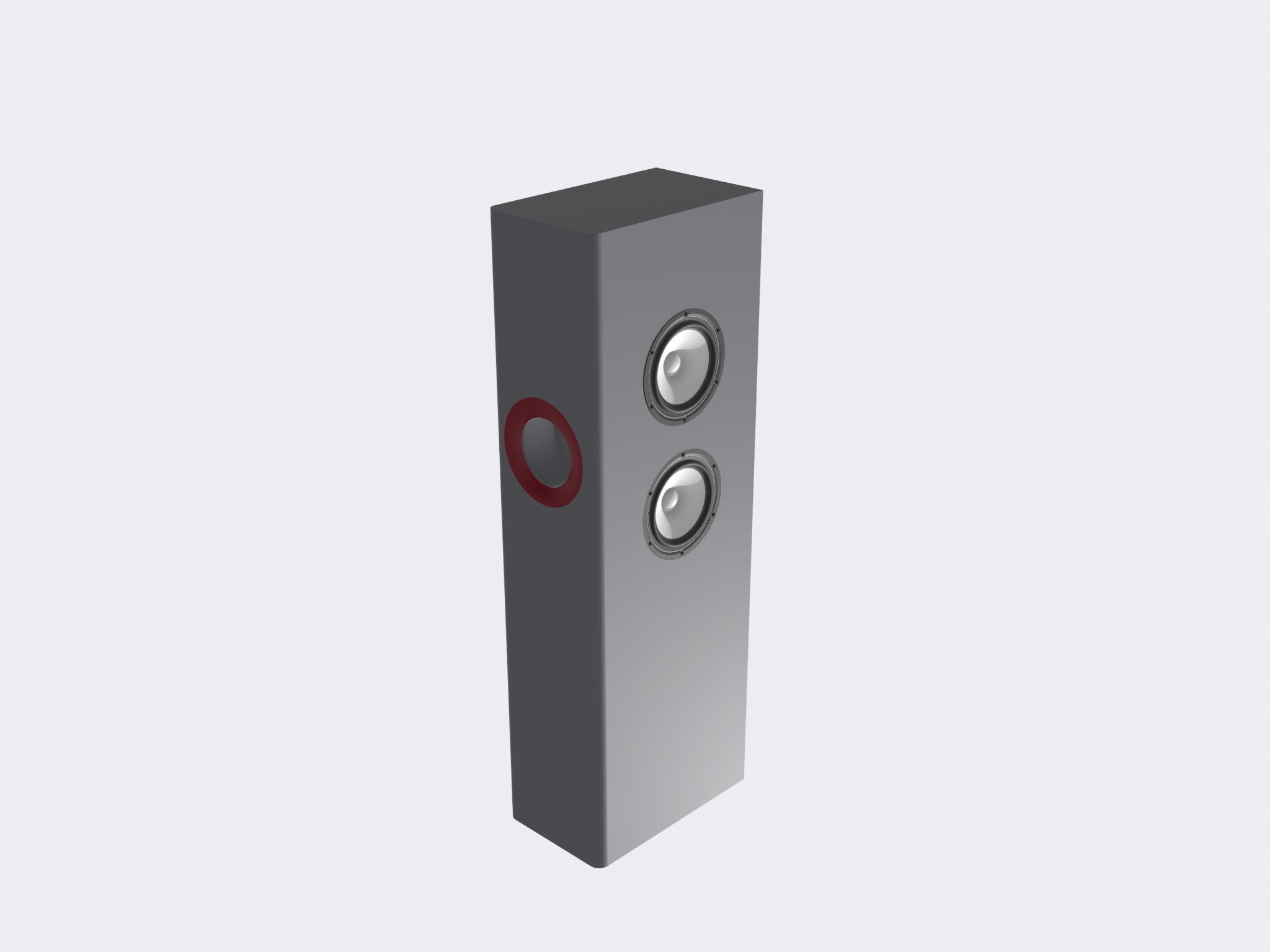

1. I do not have the drivers since I wanted to see if the drivers I have chosen will actually work together before importing them to India from the US (and incurring the customs duties and all the import hassles).
2. My idea to keep things simple was to use a full range and augment the low-frequency response using a woofer (or several woofers) below 200Hz or 300Hz. A mini version of the KEF Blade 2 but with simpler construction (see image below).
2. I used the FRD and ZMA files available via the SPL Trace tool and used the woofer's T/S specs available on the Loudspeaker Database and for the full range I used T/S specs published by Madisound (see links).
http://www.loudspeakerdatabase.com/SEAS/H1224-08_L18RNX-P
https://www.madisoundspeakerstore.c...Magnetic Arc Oxidized Full Range Matched Pair
3. I used WINISD to get the approximate box size and vent dimensions (46-47L). I chose a woofer that would work within my cabinet constraints (external dimensions of 46" H x 9" W x 16" D ) after leaving room for bracing and a smaller internal cabinet of 5L for the full range.

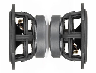

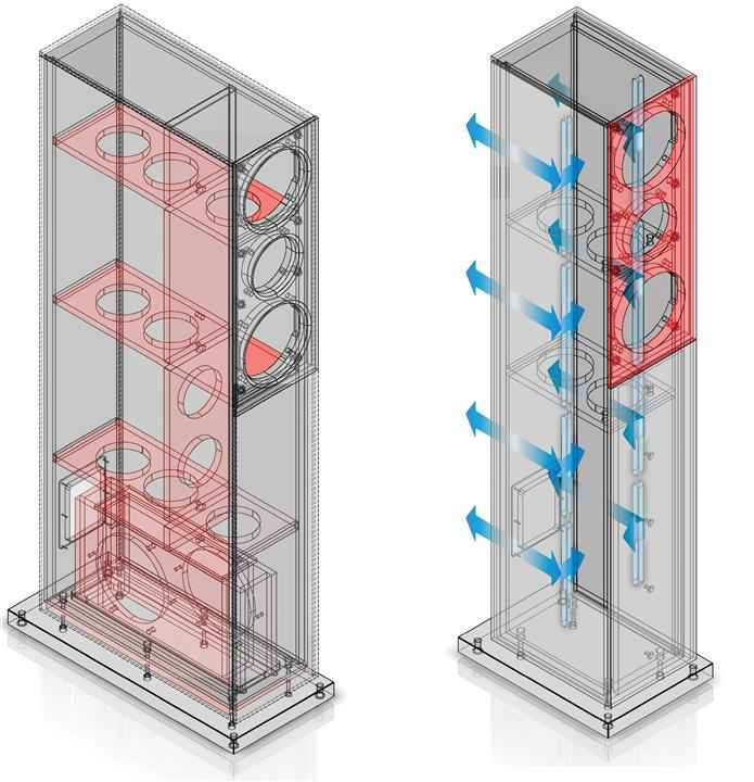

4. I understand that using 4 woofers in push-push (see image below) as used in the Audio Physic Loudspeakers and KEF Blade would mean that the baffle step might be limited if any at all. I am currently designing for a baffle step but am prepared to remove or reduce the baffle step circuit if it is deemed necessary once the speaker is built.
5. Using Vituix I now have a VXP file, a VXE file and a VXB file but the merger tool only accepts TXT, ZMA and FRD files. Does VituixCad have the ability to combine crossover response (VXP), box response (VXE), driver FRD/ZMA files, and diffraction compensation (VXB) into one curve?
I cannot find this option unless there is a different way to execute this.

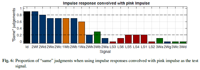

I have to read the full paper, but isn't this just GD around crossover?One of the latest studies.
Result with pink impulse:
I'm quite sure this will not end "practical ignorance" and selective blind and deaf faith in Toole et al.
Because it was already well known that it will cause audible issues at those higher frequencies.

Hi Navin,I cannot find this option unless there is a different way to execute this.
Thanks.
Navin
I hope that you have plans to acquire measurement gear, using manufacturer data has its limits in accuracy and reliability, and especially so for drivers aimed 90 degree to the listener. My recommendation for this type of simulation would be for familiarization of the tools, final design work of a speaker that you intent to enjoy for years to come should be completed with real measured data.
WinISD is not needed, VituixCAD includes a perfectly well functioning enclosure modelling tool.
The "export" buttons is what you are looking for in the Diffraction and enclosure tools to save response data. VXE/VXB files contain only the program settings, not the response result.
I've attached a document that I wrote a while back to help you generate response files using manufacturer data. Please read the first page to understand the limitations of following this process.

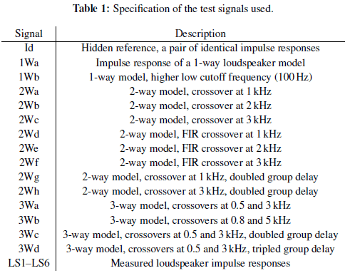

The only thing it shows is the audible difference of impulse responses.
As far as I can tell, they just listened to some different impulse "clicks"
(they also added some weighting filter to make it a bit easier)
That's how they at least describe it in the text.

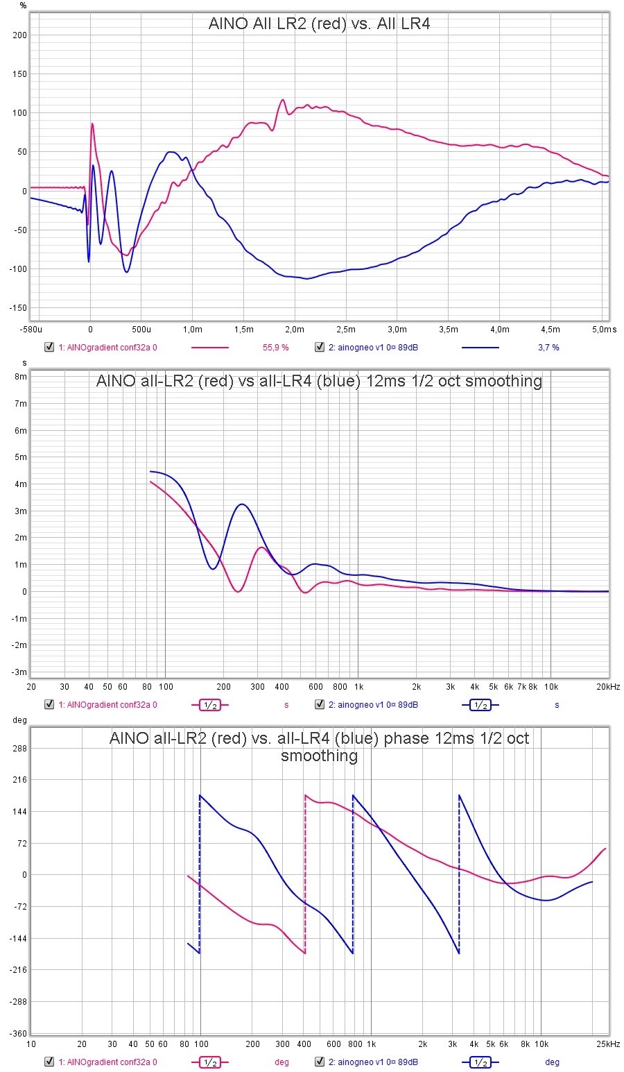

i am poor with maths, so I have found step response the best way to look at phase/group delay of a loudspeaker (basically impulse response). The audibility of how much and at what frequency is interesting topic. And if change is soft or sharp? It will take some learning to identify and differentiate GD problems. Room will always add it's own major mask.
So, IMO GD characteristics is secondary to SPL response including suppression of resonance peaks and excessive distortion of individual drivers. Everything in a loudspeaker is compromised!
Here my IIR-dsp 4-way with All-LR2 vs all-LR4. Delays set for smoothest SPL response and step continuity. These are indoor REW measurements from different sessions. Floor reflection effect is seen in 200-300Hz range. Simulations from VCAD would look nicer!

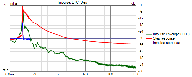

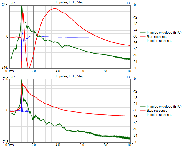

Try Envelope (ETC) some day. Y-scale in dBFS and smoothing 0.1 ms. It shows nicely both acoustical "noise" such as resonances, diffraction and reflections, and electrical delays in the same simple curve which is easy to read.I have found step response the best way to look at phase/group delay of a loudspeaker (basically impulse response). ,
