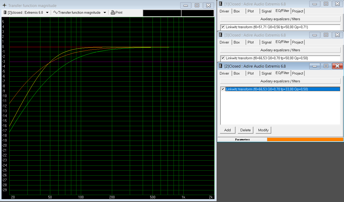

My apologies for not doing it in your program.
But for quick theoretical studies, I just find this other program much easier to work with.
Anyway, so since GD is by definition connected with the frequency response = Q-factor as well as amount of energy around Fb.
This means there will be a difference in response.
I have just attached some random system (not important, just first one in line).

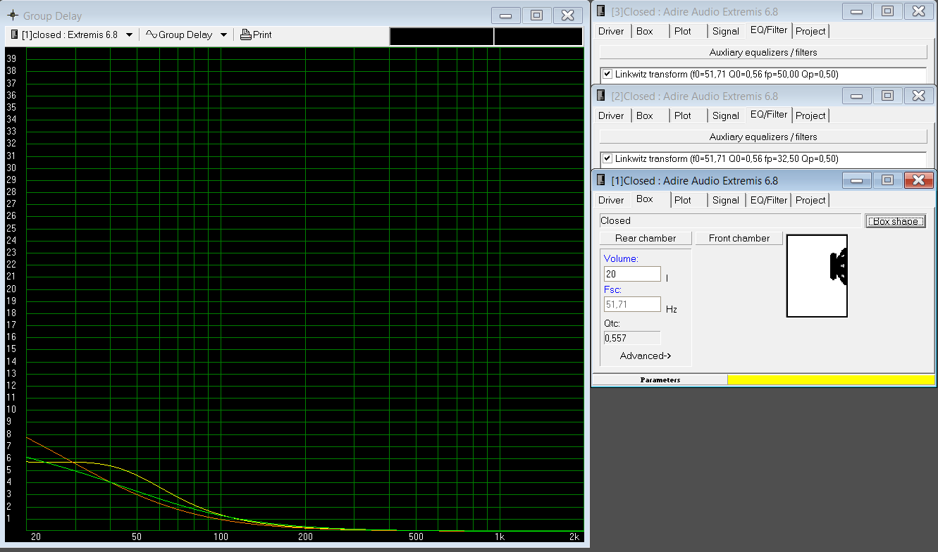

In this case the total system response is corrected with a Linkwitz-Transform.
A perfect tool to investigate certain scenario's.
In this case you can see how the GD is connected to the response of the system.
You can also clearly see how little the difference is in GD, but how much bigger the difference is in the frequency response.

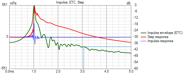

I've tried to learn to read ETC for some ten yes so far... poor success.
More material.

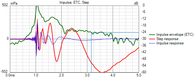

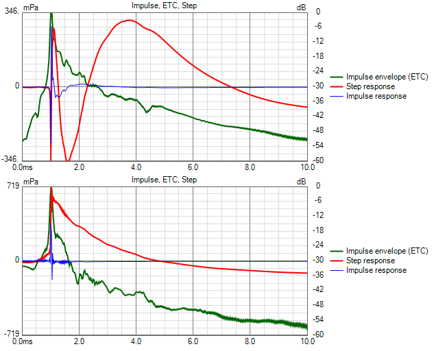

This is well-timed system. There is some diffraction because no waveguide and edge roundings are not maximal. ETC drops very fast with help of linear phase XO. Strong piano and percussion also with low SPL. Soundstage is okay, though would be better with stronger directivity or less diffraction.
This is probably the worst timing I have met IRL. ETC drops very slowly due to IIR XO with steep slopes. Very weak piano and percussion with any SPL, and soundstage scattered despite of large waveguide.
Excess group delay is easier to read but it does not reveal acoustical problems such as early reflections from stand and baffle/box so well.

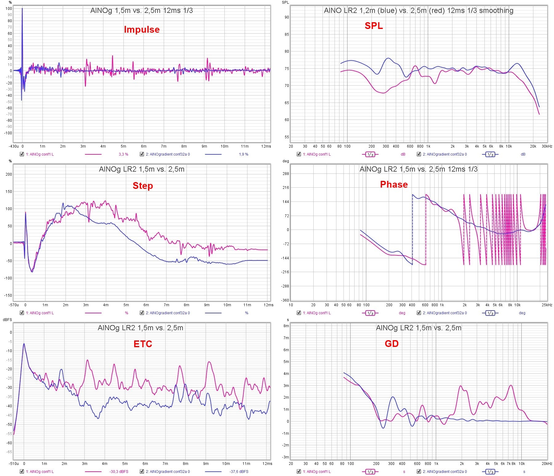

Here same speaker, same dsp settings (all-LR2, IIR, 4-way) measured indoors in same room at 1,5m vs. spot (2,5+table between speaker and mic). Every differences you see come from environment! 12ms gating and 1/3 smoothing. 0,1ms smoothing for ETC
This is why measurement conditions are so important!

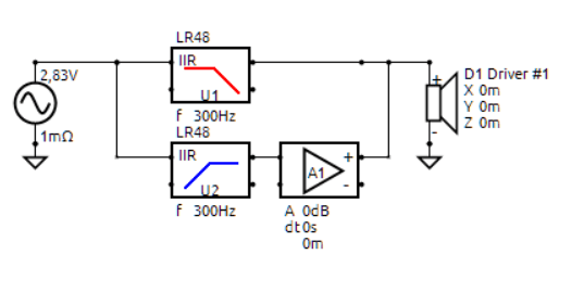

But practically speaking it's pretty easy to fix by using FIR filters (IIR can be used for the other filters even) or by delaying the other speakers. Which already has been said.
The reason why I'm repeating it, is because it gives us an opportunity to do some ABX testing.
Because it's just a case of making two identical filters in VCAD and put in in a DSP or EQ_APO or what have you and switch between the two.
In fact, it can be even done with the same setup, and by just adding this litter filter construction.(see attachment).
In this case we could even just apply this to some music snippets so people can test it (blind) on speakers as well as on headphones. We can use some VST filters or so for that (I use Ardour for recording my instruments, so will have a look)
