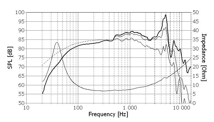

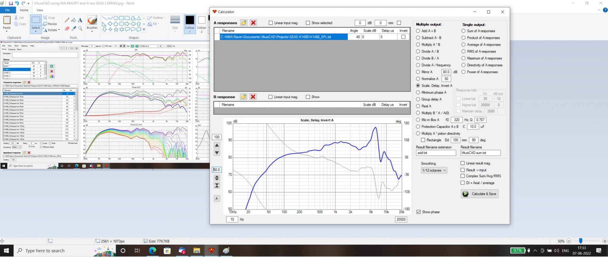

Thanks, Dcibel. Maybe I am doing something wrong. Can you please guide me?
If I use the Calculator tool the curve does not exactly match the published curve. For example, the published curve shows a peak at around 4khz and the one in the calculator tool shows a peak at around 6khz.

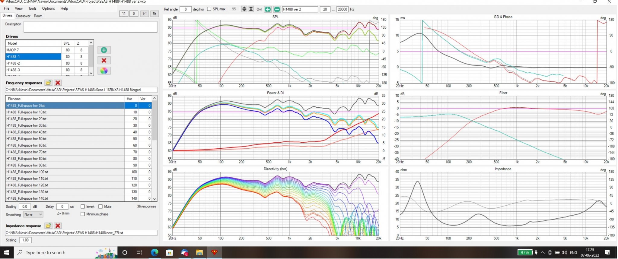

I meant that if we want to load the same data for woofers 1, 2, 3, and 4 I can't just copy woofer 1 to woofer 2. I have to load the frequency response and impedance response independently for all 4.
![VituixCAD using MA MAOP7 and 4 nos SEAS L16RNX.jpg VituixCAD using MA MAOP7 and 4 nos SEAS L16RNX.jpg](https://www.diyaudio.com/community/data/attachments/969/969995-0ce10e475c29bd4c2298685ec9ade532.jpg)
Frequency range in Seas image is not 10-20000 Hz. It's probably 10-15000 Hz. Use 10000 as freq. maximum because it's visible and certain. Then verify scaling by moving mouse cursor in SPL trace and look bottom status bar how program translates image coordinates to frequency and SPL values with parameters you have entered.If I use the Calculator tool the curve does not exactly match the published curve. For example, the published curve shows a peak at around 4khz and the one in the calculator tool shows a peak at around 6khz.

Error in set up of trace tool, simple as that. Follow what I said about best practice when tracing and try again.Thanks, Dcibel. Maybe I am doing something wrong. Can you please guide me?

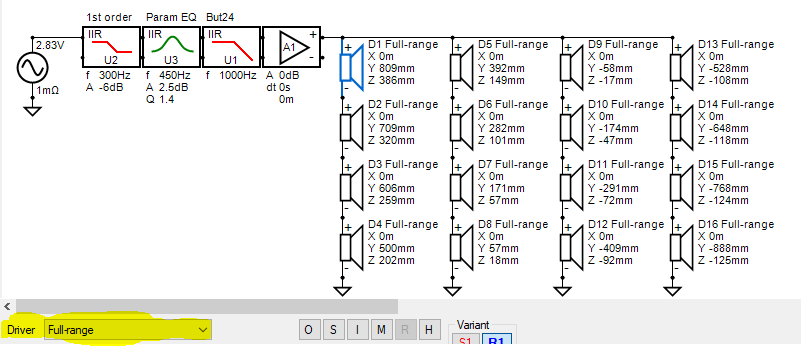

Driver information in driver tab is only needed for each unique driver, there’s no need to make multiple drivers with the same data, just one driver and multiple instances in the crossover as Kimmo has shown above.I meant that if we want to load the same data for woofers 1, 2, 3, and 4 I can't just copy woofer 1 to woofer 2. I have to load the frequency response and impedance response independently for all 4.
Here is an example with 16 drivers using the same response data. Each driver instance in XO is linked to response data in Drivers tab with Driver list box below schematic (highlight in yellow):
Aha silly me. I got it. I just have to choose the same driver in the "Crossover" part of the program! Thanks.
Thank you, Kim and Dcibel. By that token can I use 20-10,000 Hz since the driver's curve doesn't really start at 10Hz?

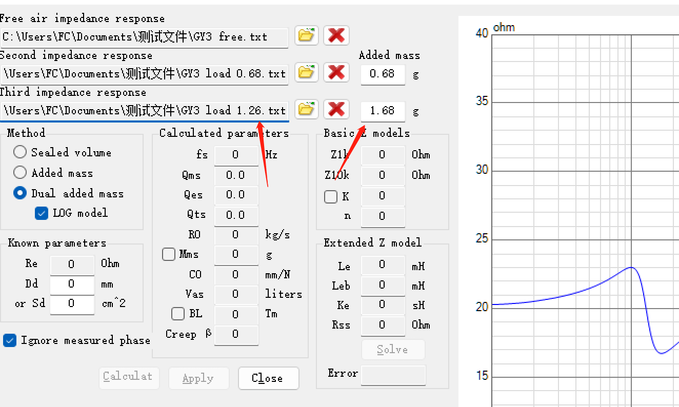

There was minimum limit of 1.0 gramms between two mass values. Minimum difference is now reduced down to 0.1 gramms in the latest build you can download test.My actual weight is 1.26g, but the software forces 1.68g and cannot be changed
As far as I recall it's recommended that heavier added mass should be ca. estimated/published Mms, and lighter mass ca. half of Mms. Your extra masses look very light which does not help to get accurate result if the driver is typical mid-woofer. Mms is typically between 2.5 and 9.5 gramms with 4"-4.5" size category so difference limit of 1 gramms has been okay so far. Method is not necessarily very accurate with very light cones such as 2"-3" full-range drivers. Measuring of T/S serves box alignment, and tiny drivers don't care much about box size. It's just "small".
thank you. It is indeed a 3-inch full frequency. Because there are no other driversThere was minimum limit of 1.0 gramms between two mass values. Minimum difference is now reduced down to 0.1 gramms in the latest build you can download test.
