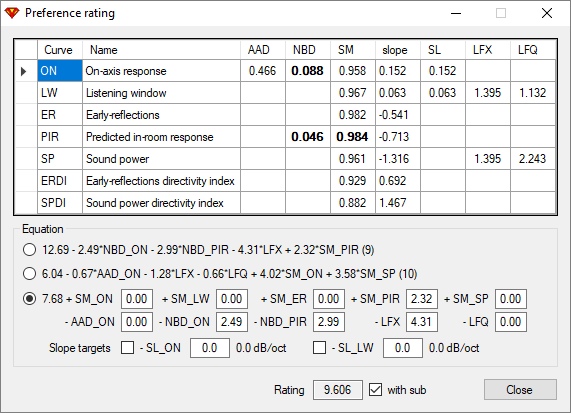

Dear @kimmosto
Thank you for ongoing great updates and thanks to the folks for number of nice requests as well.

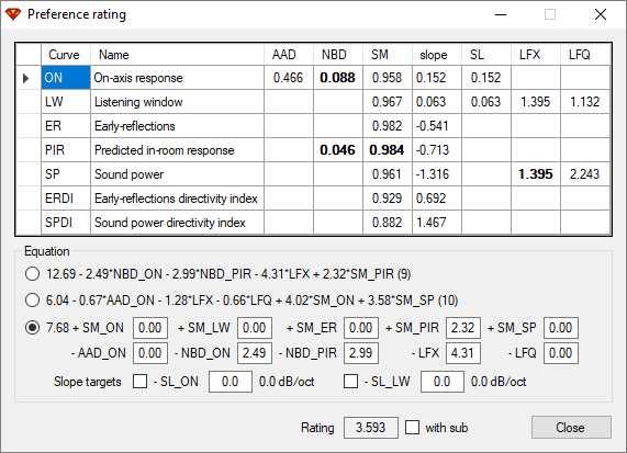

Feature request (if I could)
I'd like to use the "Custom equation" in the "Preference rating" with the same constants as the (9) equation but without sensitivity to the slope.
But I can not manually set the first constant.
It looks strange a bit as well because checking "with sub" returns a perfectly good score so the constant might be adjusted to set the full score of 10 with sub.
So please consider implementing the text box to the first constant of "Custom equation" or maybe fix the bug of constant without checking "with sub"?

![1658814863720.png 1658814863720.png](https://www.diyaudio.com/community/data/attachments/983/983191-d9b09b8a69a42d6012a4c095bf29f64f.jpg)

![1658814782083.png 1658814782083.png](https://www.diyaudio.com/community/data/attachments/983/983190-2a44aabecfd967890a33cda8b2f607de.jpg)

Could you tell or link how "with sub" is calculated on ASR? I've never seen/found their spec. for it, and nowadays I don't give a sht what happens there.with sub
VituixCAD has still original "LFX=1.162 and LFQ=0.5 when 'with sub' is checked" though this does not work anymore with equation 9 due to existing slope-sensitive calculation directly by Olive's patent. I guess constants for "with sub" are a bit different on ASR though they have eliminated some slope insensivities too.
I can do that though first constant may need some minimum limit to eliminate negative rating. Generally, adjustable first constant does not harm optimizing which is primary purpose of 'custom equation'.So please consider implementing the text box to the first constant of "Custom equation" or maybe fix the bug of constant without checking "with sub"?
Drop of rating when 'with sub' is unchecked is already fixed (will be published later). That "bug" was also harmless while optimizing, and normally 'with sub' should be checked while optimizing to avoid too high gain at sub frequencies.

Yes, currently just "LFX=1.162 in equation 9 is generally regarded as "with sub" just because the full score hits 10.0, as long as I know.Could you tell or link how "with sub" is calculated on ASR? I've never seen/found their spec. for it, and nowadays I don't give a sht what happens there.
Equation 10 is rarely used (I personally have never seen it) so I don't know but I think LFX=1.162 and LFQ=0.5 in equation 10 are also appropriate.
Some use f6=20hz because f6≒14.5 Hz is a bit impractical though.
(looks not maintained anymore but Loudspeaker Explorer is using f6=20 as the perfect sub)
By the way, interestingly, Dr Sean Olive himself said that if he could do the research over again, he would like to scale the equation so that the highest rated speaker reached 10.0 or 100.
Thank you for quick fix!I can do that though first constant may need some minimum limit to eliminate negative rating. Generally, adjustable first constant does not harm optimizing which is primary purpose of 'custom equation'.
I personally do not need the first constant modification if the bug is fixed.
2.0.88.2 (2022-07-30)
Main
- Absorption dB of Front wall duplicated as read-only for Left wall in Room tab.
- Multipliers of LFX and LFQ included in first parameter of custom equation to avoid drop of rating when 'With sub' is unchecked.
Quick reminder for @Noviceman that multipliers of equation 9 or 10 can be copied to custom equation by pressing Shift or Ctrl key while clicking Equation 9 or 10 radiobutton.
