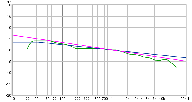

Shure target curves are interesting stuff, in below Toole's JBL study for the trained lister curve (green) is overlaid VituixCAD default (pink) and one called 7dB target curve (blue) used as default target in a APL Audio auto EQ tool (it falls exactly 7dB between points 30Hz and 30kHz). Guess they interesting references and also some relative close, that said in my ears its very sensitive stuff if one play around tilt them tiny 0,1dB at a time. Have hanged on those two target curves below should anyone be interested.
attachment.php
  • 7dB_target.zip
  • JBL_Toole_curve_trained_listener.zip
Toole's JBL study for the trained lister curve (green) ... and one called 7dB target curve (blue)
Those are steady-state room response curves which is different than power response.
7 dB curve could be valuable with VituixCAD if power response is calculated to half space because slope is only 0.7 dB/oct.
Toole's curve is close to typical power response target. I suppose listening distance has been long and room damped or DI jumps at high frequencies. Looks also that Toole's test group has listened classical/acoustic music because very small signatures of conversion from large room and typical mic position to smaller room and shorter listening distance are visible.

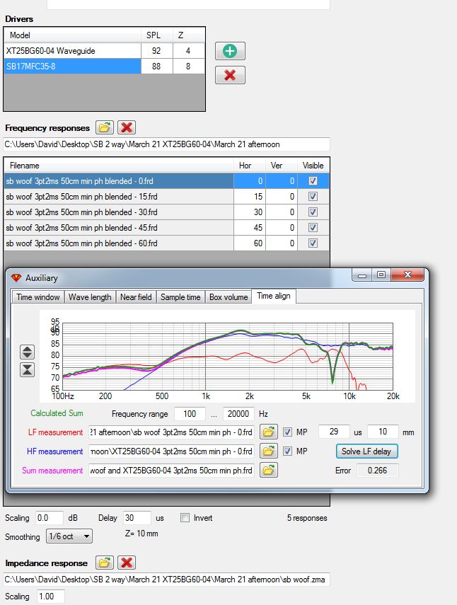

Question about entering the Z offset in the driver setup,
When I use Jeff Bagbys PCD to check driver offset, my tweeter is 15mm behind my woofer (tweeter is in a waveguide).
Is that entered as a positive or negative?
When I use the Auxiliary offset solver, I get a woofer offset of 10mm.
Is that entered as shown?
Why the difference?
Measurements were made on tweeter axis at 50cm, sweeps were recorded with 3ms gating.
Thank you,
David.
If woofer's delay is entered as 0 us, tweeter's delay is positive 43 us (15mm).
If tweeter's delay is entered as 0 us, woofer's delay is negative 43 us (-15mm). This is better way.
Why the difference?
Yes, but somehow the result does not look correct. LF delay should be negative if tweeter is behind. I will check calculation and sign later this evening. Could you send those three files by e-mail for testing?
