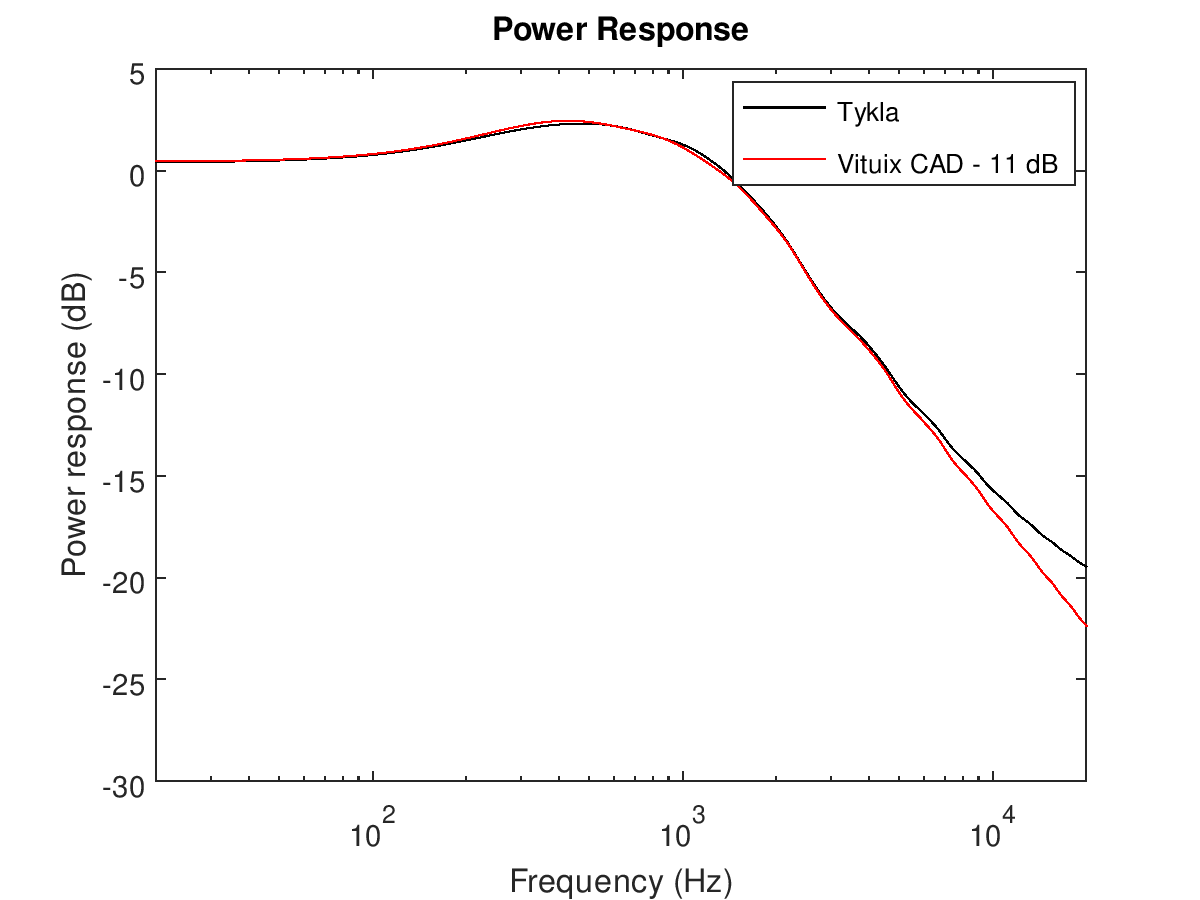

Kimmo, my number one question was if you could provide the formula you used for the calculation of the power response in Vituix. I was trying to understand properly how the calculation is done in Vituix. Until now, you did not provide this information. I don't understand why you don't want to provide this background information, but there may be reasons (whatever they are).
I would expect that Vituix uses the method described by Tylka, and in particular equation (3) (see my earlier references). Hoever, I believe your comments about the workings of the Vituix calculation do not match the Tylka formula (as explained here).
As a follow-up, you also discussed the question "Does Vituix give the correct result?". This is of course also important, but it was not my primary question. "How does it work?" is a different question than "Does the code give the correct result?".

I have to admit that I am not familiar with the theoretical power responses of these things. I therefore took another route in order to dig in a bit more:
(A) I used the Vituix diffraction calculator to generate a data set of polar SPL response data at horizontal and vertical orbits, with an angular spacing of 5°. I used the midrange model of Monkey Coffin baffle for this, simply because I had this at hand, and since this seems to be closer to a real-world situation than a theoretical omni / cardiodid / dipole.
(B) I implemented the Tylka method (equation 3) to calculate the power response. I used GNU Octave for this. The "weighting" coefficients (as Tylka calls them) I got from my code are identical to those given by Tylka, so I guess my code is not all wrong. The code should also work out of the box in Matlab, but I haven't tried.
(C) I calculated the power response using the Tylka method (equation 3) using the data from step (A).
(D) I calculated the power response using Vituix CAD using the data from step (A).
(E) I compared the power response curves I got from Tylka (step C) and Vituix (step D). See attached plot comparing the two curves.
The result is that the Vituix curve is about 11 dB higher than the Tylka curve. This could be related to different normalisation, for instance due to a 4pi term (note that 10 x log10(4*pi) = 10.99). Not a big deal so far. However, while the two curves are nicely consistent from 20 Hz to about 4 kHz, they diverge at high frequencies. Could this be due to a difference in the Vitiuix implementation as compared to the Tykla equation? Given our earlier disussion here, I wouldn't be surprised if this was related how the "weighting" in Vituix seems to be different than described by Tykla.
A ZIP file with the Tylka paper, my code, the test data, and some additional plots are available for download here (sorry, the file was too big to upload as an attachment to this post). I tried to comment the code as much as possible in order to make it easier to understand. I guess this should be useful for you to study the differences between the Tykla equation and the Vituix code.
Please do not expect that. Tylka has not invented DI and power calculation and VituixCAD is older product than Tylka's paper. He has just one possible implementation which is not the only one. I've already mentioned Beranek & Mellow few times. Those guys represent simpler method which gives good result when pressure measurement directions are toward middle position of each sector. For example with angle step of 5 deg, measurement directions would be reference angle i.e. 0 deg, 2.5 deg, 7.5 deg, 12.5 deg, ..., 177.5 deg. That enables very simple weighting with sin() function only assuming that angle step is constant and whole sector 0-90 or -180 deg is measured.
But my life has been more complicated due to users who want "think" and do as less measurements as possible to save e.g. 5 minutes per project. So calculation in VCAD has developed over the years from very strict n' bureaucratic "measure all or I don't show you anything or at least calculate wrong" to more flexible which tries to struggle against laziness and ignorance and give some valid power & DI results. So program is packed with few workarounds, sleeve constants and custom functions which cannot be explained with simple row of Greek hieroglyphs. For example direction weighting is done with integral sine.
With this background, not much comments about your comparison. Result of VCAD looks more accurate because directivity of ideal piston increases quite constantly at HF.
I am not sure, but I suspect "the name calling" thing is in relation to my post 1162. If my post came across in an unpolite way, that was not my intention, and I apologise. However, can't see how I was unpolite or insulting in any way. I would therefore be glad if someone would explain to me what was wrong so that I can do better next time.
I am totally aware that Vituix is a great piece of software, and I applaud the creator for that! See also my recent post here.
Sure. The Tylka paper is just easy to get. For his equation (3), which I thought would be the basis for Vituix, he refers to a paper by Davis published in 1973. I guess that was before Vituix was born :)
Could you provide a complete reference so that I can look it up?
I am not sure. The test data are not only the result of the directivity of an ideal piston, but also baffle diffraction. Take a look at the polar plots included in the ZIP file linked in my earlier post.
I have the book which is copyright material. But there is just basic version equal to Tylka (1). Calculation example with Genelec 8030A is built so that simple weighting with sin() function gives good result. Tylka (3) and weighting by circular area on spherical surface (section 4) is more sophisticated implementation. My home made integral sine weighting tries to do the same, though I could change that to area calculation which is probably faster.
Power should drop 6 dB/oct with ideal piston, regardless of additional box effects. Anyway, calculation principle in your test could be fully okay though result was not (yet). Response data without very dense dips would be better for this because it does not require so high frequency resolution and exactly original frequency points. Also VCAD collapses with 8" ideal piston at about 22 kHz due to very dense response dips. Frequency axis with 48 pts/oct. limits some things.
11 dB difference is scaling to total power. It's just visually different than average power or whatever the correct term is for power response which is usually located below axial SPL.

Essential is to take care that weighting factors for -180, +180 and 0 deg are compatible with number of pressure measurements (responses) in calculation. Those points have clear risk of duplicate data. For example weighting factors by Tylka look that 0 deg response in vertical plane should be skipped because factor is two times higher than relative area. Probably all -180 deg measurements too.
Sure. This actually applies to ALL points. The Tylka paper explains this nicely in the equations 10-12 and the text on page 7. Tylka also notes that the points that are redundant because they occur on both the horizontal and the vertical orbit (at theta=0° / phi=0° and at theta=180° and phi=180°) must be treated such that they are not counted twice. The details of how you implement this will depend on how your code works. I implemented it exactly the way it's done in the Tylka paper.
Weighting factors for conversion from dual plane to full sphere, with the latest built of 2.0.15.3:

180 deg is half compared to 0 deg because the same direction is looped twice per plane in VCAD.
Method is still integral of sine instead of Archimedes' Hat-Box Theorem.
These are pretty much identical to those in the Tylka calculation. Here's the difference of your coefficients to those in Tylka (VCAD - Tylka):

With the exception of the last one, this is negligible. I guess you know best what to do with the last one (180°) in your code. But I am surprised it is not treated the same way as the first one (0°).
Edit: in the Tylka calculation, the first value (0.000237...) is already divided by two because the 0°/0° point is both on the horizontal AND the vertical orbit, so the point is counted twice. Therefore the coefficient is divided by two, resulting in 0.000237... . So I guess since your code uses the same value, the 0°/0° point is also counted twice. Since the 180°/180° point is also counted twice in your code (like the 0°/0° point), I believe you shouldn't divide this value by 2 again.

180 deg = 0.000118972302267775
Result is usually exact but method needs averaging workaround close to 0 deg if next measurement directions to different sides (+/-) are not symmetrical.
