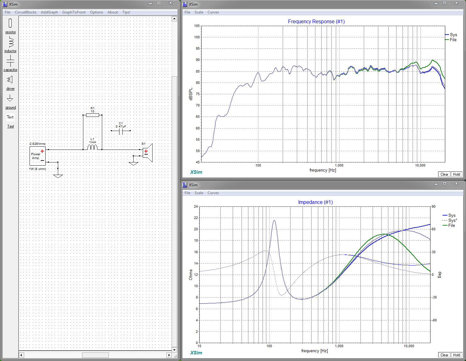

This was the BSC filter I used - it attenuates the HF quite a bit so sensitivity of speaker is down to maybe 76dB at 2.83v at 1m overall but gives a very nice balanced bass presentation. The 0.47uF cap is optional and boosts the HF a bit for more sparkle. It is 1mH and 10ohm in parallel.

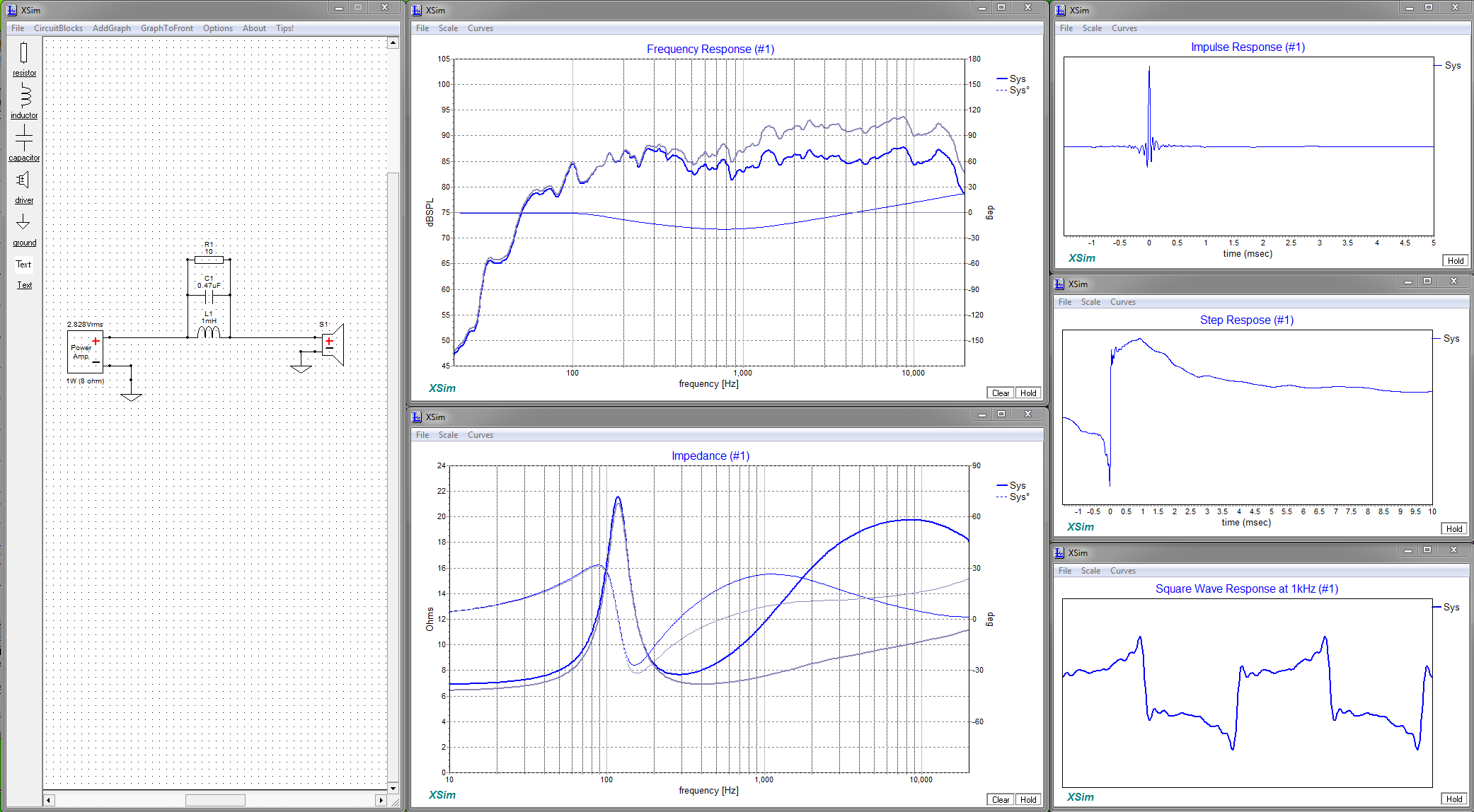

xrk971,
Visuals to BSC talk : ) in that traced your post 67 plot without BSC to a frd file and combined it with TC9 zma file had on HDD.
At first plot graphs grey trace is without BSC network and blue is the corrected system, at second plot blue is without capacitor grey is with 0,47uF and green is 1,5uF.

Thanks for the sims Byrtt! It looks like the 0.47uF is not doing much so just leave it out. If you want a HF boost then the 2.2uF seems like the value to have. I guess 1uF would have some audible effect as well.
