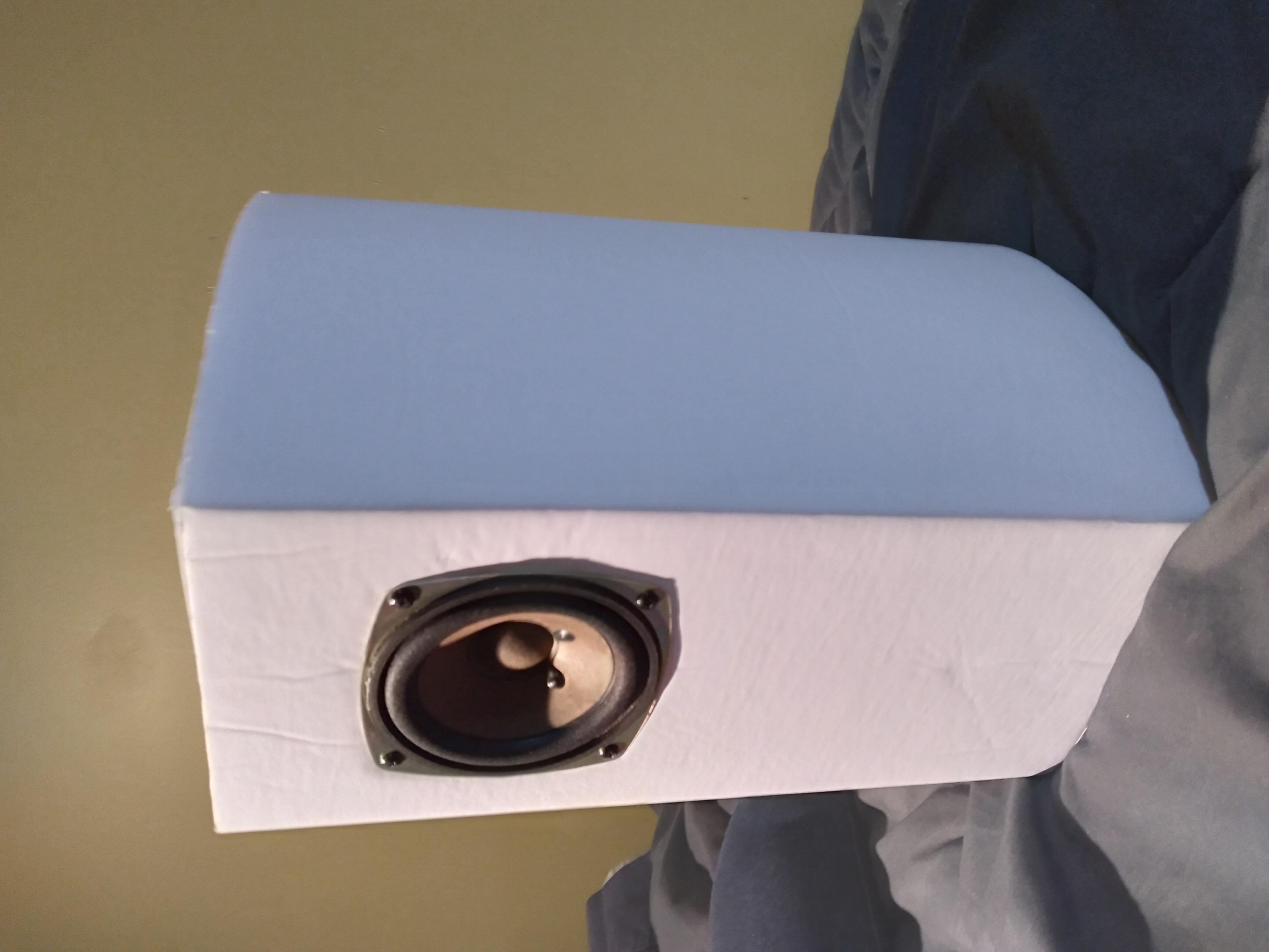

I used an old Sony speaker I had on hand, as the tcf9d is on back order at PE. I'll replace it when they come in. I lined the speaker baffle with a strip of 1" cotton batting that I pulled as wide open as I could to dampen reflections and put a small amount of polyfill in both chambers. I will also post some pictures of my Nautaloss I on that thread.
xrk, I tried it with my phone and it sounded great! The bass was very substantial, and the mid-range was very present. Of, course, I don't hear highs much at all, but what was on the particular piece I played was strong, too. I'm very satisfied, but will probably replace the speakers on this and its match with a better one, like the tc9fd, or even the 6.5" poly cone. The speaker hole is too big now for the tc9fd, and I don't want it to look patched. I actually had the 6.5" in mind when I chose the width of the speaker baffle -6.5", with 8" as the width of the widest point of the baffles. Thanks again for your guidance.

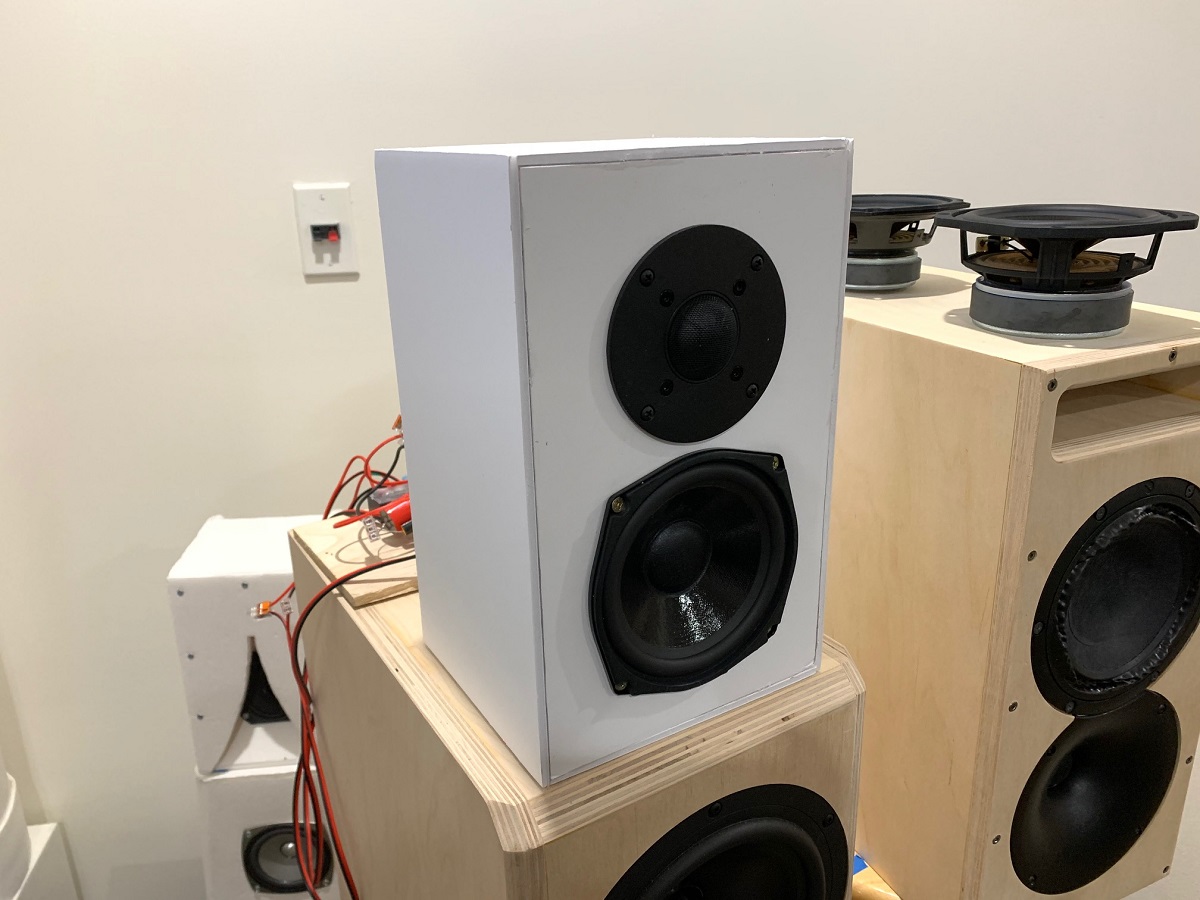

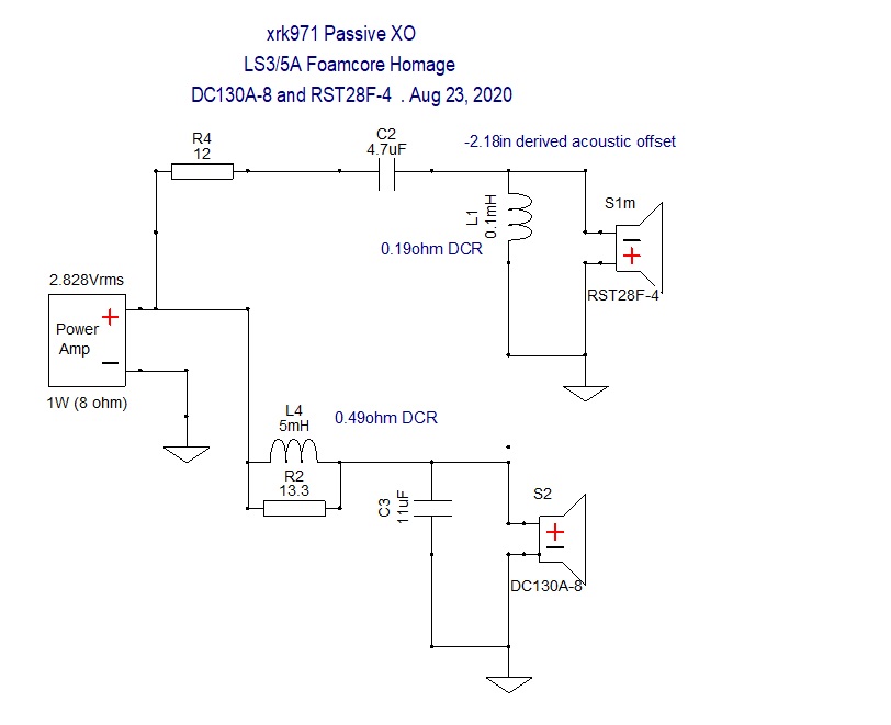

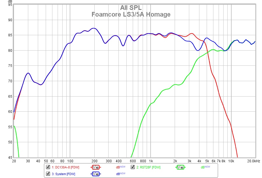

If you have 7in to spare for cabinets - these are also fantastic sounding. Like studio monitors.
RST28F and DC130A Foamcore Homage to LS3/5A

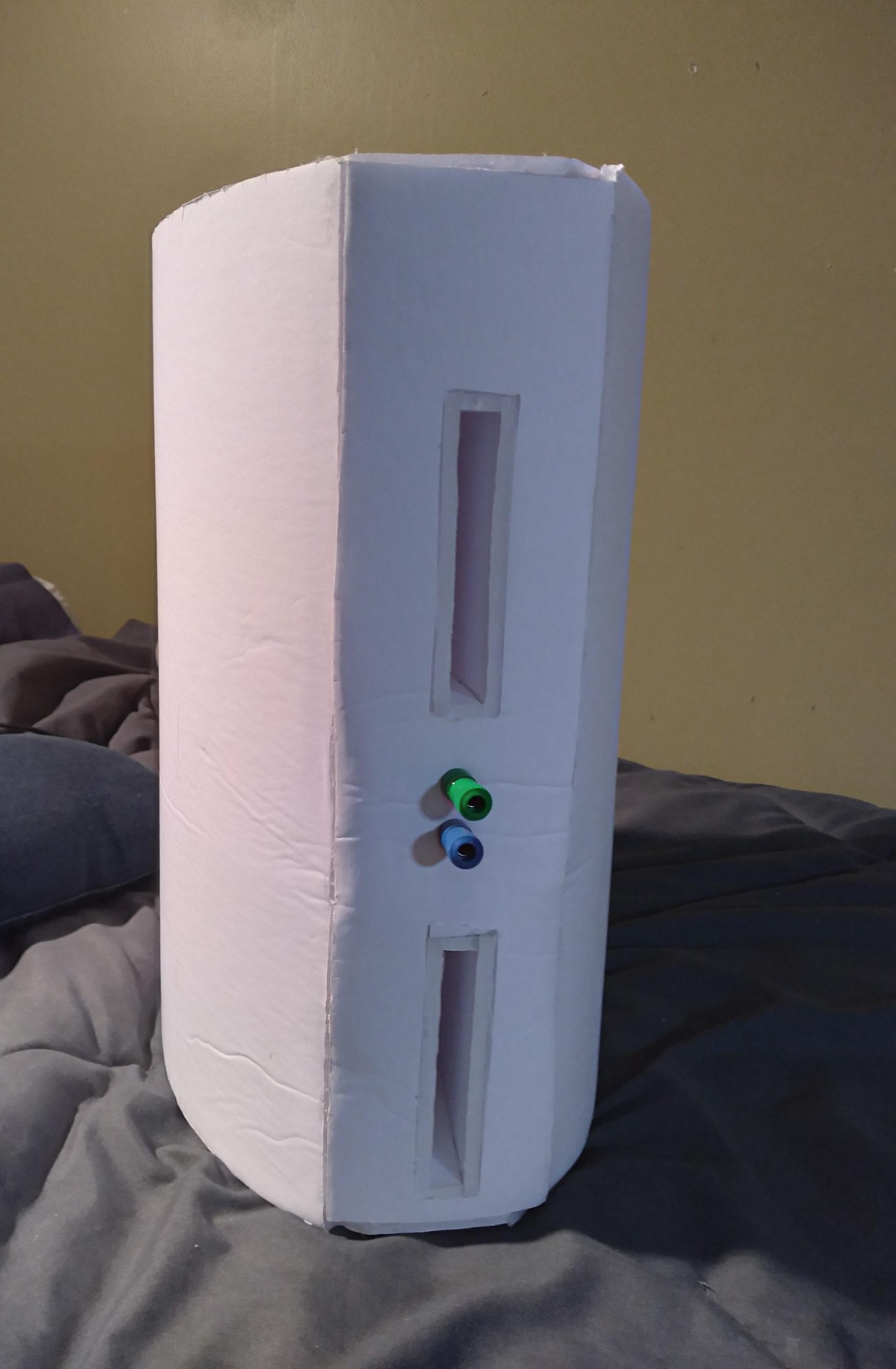

I and my son-in-law's mother both live with my daughter and her family, so the garage is full of our stuff, so a good bit of my workshop is in my bedroom. That means that pretty much every square inch of it is taken up. The only place for the TV speakers is either hanging off the edge by the TV or under the edge of the TV. Under the edge is actually the best place, as the gap there is exactly the right height for the speakers to fit on their sides. Against one side of the armoire (TV cabinet) is where the right channel stereo speaker is. Believe me, I've weighed all my options, and the Viva's are the only options I have.
These look really cool! I was thinking, if you made the front and back, top divider and bottom in 12 mm mdf, added one thin window brace per side and use two layers of foamcore with butyl caulk between for the curved part, wouldn't that make for a pretty sturdy little speaker? You could even glue up the sides curved over the cabinet with straps and glue them to the "skeleton" later. A little putty, a lot of sanding, and a coat or three of matte black spray paint followed by som polyurethane (maybe poly on the inside to stiffen more, followed by lagging?). Good stuff! Has anyone tried to model this for different drivers?
Btw not saying I'll do this today or tomorrow though...![]()
That would work well. You could even use bendy plywood. Probably no need to make constrained layer damping. Just add layer of foil covered mass loaded butyl sheets to the inside. On the outside, cover with thin wood veneer. This can be modeled with other drivers, of course. There is a DCR Akabak script in the Akabak howto thread.
