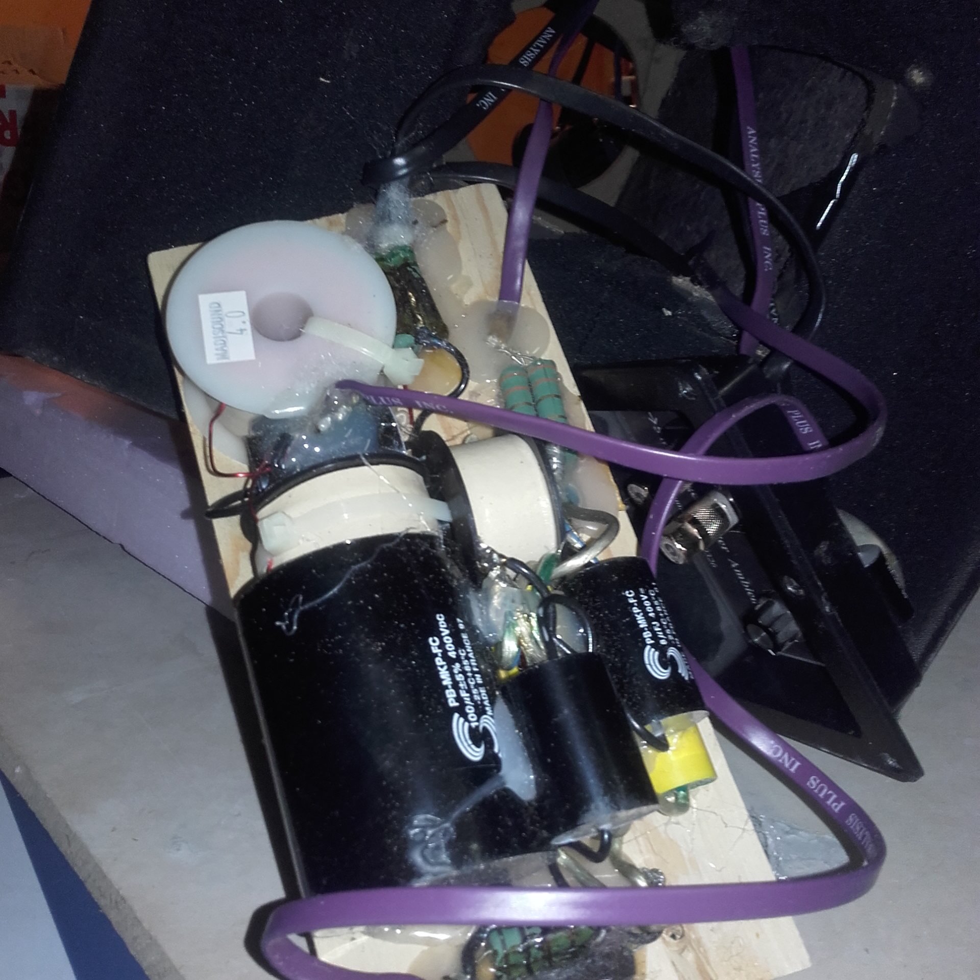

(YES)What the VR-1 crossover looks like.
There's a 10ohm and 4ohm resistor but the values for the two caps I'm not sure about.
Normally you'd see uF values, not J which I believe means tolerance.
So are these 10uF and 4uF caps??
Having seen some high quality test results of the un-modified VR-1's, and these caps. being good quality poly-caps,
I highly doubt the need to replace them OR the need to modify the speaker in any way !
This thread now seems a little pointless.
I see another irony in that modified filter -those Soniq caps, if memory serves, are allegedly constructed in such a way that they have an 'internal bypass' already built into them making additions in that line a bit pointless, even if you buy into that particular idea -especially with the same cap type. Either way, as noted, I'd leave them alone. The components in there appear to be fine, as you'd expect, and although a well-designed speaker, they weren't titanically expensive when they were current about 2 decades ago.
I've read the reviews and looked a the XO and I'd not try and "improve" what is there, what I would do is add a .5 woofer so the little speakers sit at the correct height, a couple of 8s in a tall box would work for me and maybe about the same cost as the esoteric capacitors

Improvements? Well this upgrader has struggled to fit in the new huge capacitors:
Personally I'd be more interested in checking for good connections, deal with any corrosion, and confirming there is no voice-coil rubbing, and even check the ferrofluid in the tweeter, if used, is in good shape.
Best, Steve.
