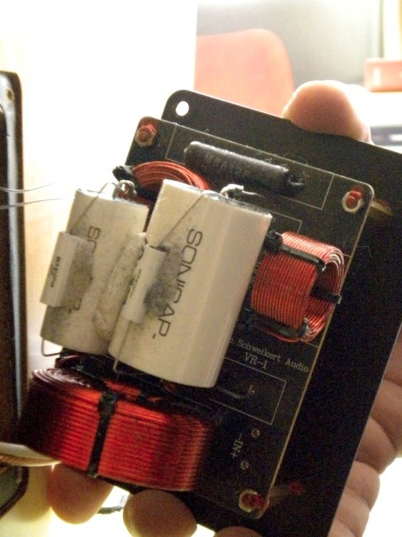

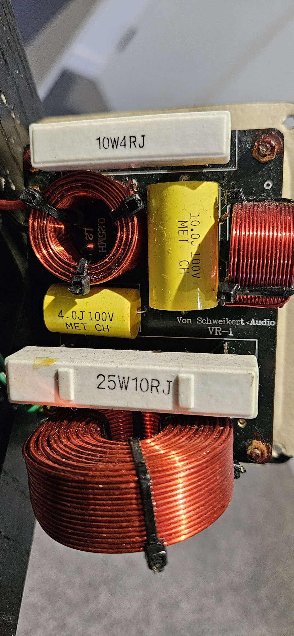

(YES)What the VR-1 crossover looks like.
There's a 10ohm and 4ohm resistor but the values for the two caps I'm not sure about.
Normally you'd see uF values, not J which I believe means tolerance.
So are these 10uF and 4uF caps??
Having seen some high quality test results of the un-modified VR-1's, and these caps. being good quality poly-caps,
I highly doubt the need to replace them OR the need to modify the speaker in any way !
This thread now seems a little pointless.
I see another irony in that modified filter -those Soniq caps, if memory serves, are allegedly constructed in such a way that they have an 'internal bypass' already built into them making additions in that line a bit pointless, even if you buy into that particular idea -especially with the same cap type. Either way, as noted, I'd leave them alone. The components in there appear to be fine, as you'd expect, and although a well-designed speaker, they weren't titanically expensive when they were current about 2 decades ago.
I've read the reviews and looked a the XO and I'd not try and "improve" what is there, what I would do is add a .5 woofer so the little speakers sit at the correct height, a couple of 8s in a tall box would work for me and maybe about the same cost as the esoteric capacitors

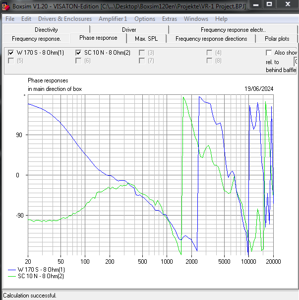

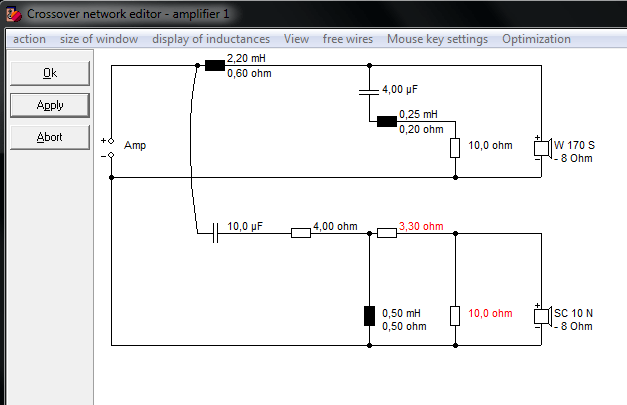

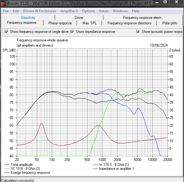

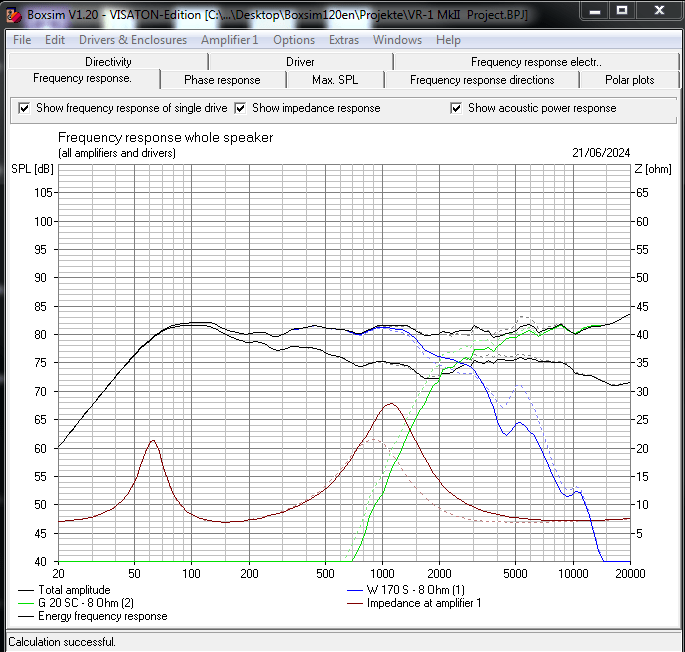

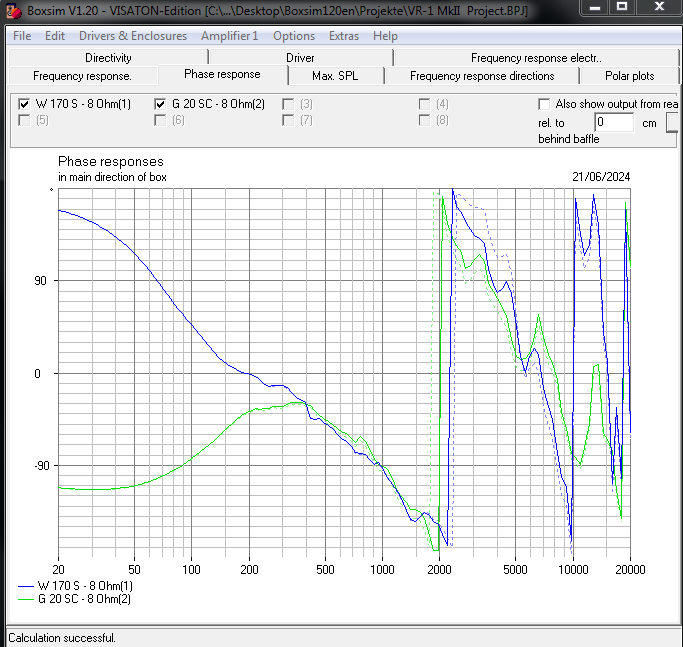

I did a rough sim based on what I know here, and the red resistors are a modelling device:
Leads to a response a bit like this:
It's a flat power 90 degree phase Butterworth response, of which I quite approve. The bass circuit is something often employed with awkward Scan 6" drivers.
The tweeter crossover might sound cleaner with a higher order design.
The tweeter response is possibly improved by adding a waveguide design which I didn't do in the sim.
Improvements? Well this upgrader has struggled to fit in the new huge capacitors:
Personally I'd be more interested in checking for good connections, deal with any corrosion, and confirming there is no voice-coil rubbing, and even check the ferrofluid in the tweeter, if used, is in good shape.

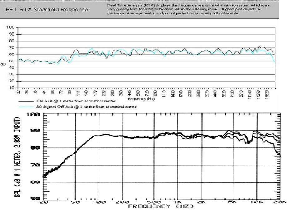

But the VR-1 xover-point is 2,5 K, not 1,5 K as your simulation shows.Leads to a response a bit like this:
Tuned to around 30 hz.
Here is 2 different review mesaurements in-room....prytty close.

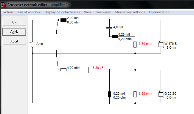

Anywhoo, whilst @luigi seems to have "ridden off into the sunset " as the Americans say, I have been beavering away at that 6" plus 1" VR-1 speaker, a style which I have always found very troublesome indeed.
I may have found a notable improvement. Not boutique capacitors and resistors. No.
It relies on a 4 ohm tweeter, which I have used an 8.2R on the usual 8 ohm jobbie to simulate. And I have made the tweeter coil L3 smaller, which was obvious from the pictures in hindsight.
This looks quite good! And will work with an 8 ohm tweeter with that 8.2R resistor added.
I ran a sim with 6.8uF tweeter capacitor instead of 10uF, and 3.3R in the LCR instead of that outrageously over-specified 25W 10R.
All looks better:
The tweeter gets a gentler rude, so less distortion, and the 5kHz midbass breakup is suppressed more. It never occurred to me to try a 4 ohm tweeter in this sort of thing.
So that is what I would change. Can't be worse, can it? It is a bit more phase-aligned Linkwitz-Riley, of course. So will have a dryer more analytical sound.

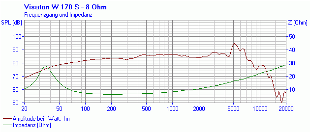

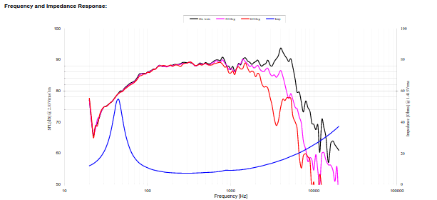

@Moondog55, nowhere did I say that these were Visaton drivers. Clearly they are not.
But 6" paper woofers are much of a muchness.
Peerless 830875, which is quite popular:
The main issue is dealing with the peaky cone breakup around 4-5Khz. In which case LCR notches are notches. If the LC notch frequency is known, only the depth or "Q" via a resistor R is a matter of choice.
Bafflestep coil is also a bit of a matter of taste.
