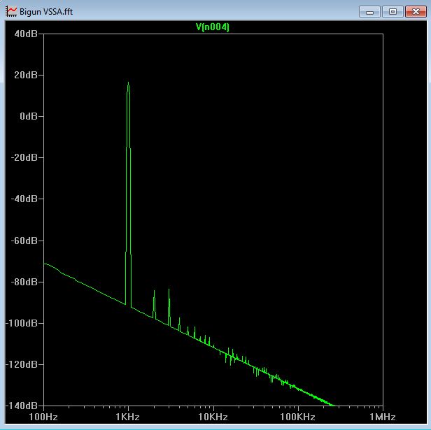

This what I've got with Bigun file.This is at quite low level, at higher level it is much worse.
dado
For such a simple amp it is still all very good, at your first sim at 1 kHz, H2 still -100dB.
Normal home usage with moderate to high efficiency speakers will do fine.
VSSA is ideal for an active speaker (2-3 channels per speaker), low parts count, direct connection to drivers, active crossover, etc.
If you would like to get lower THD add appropriate driver, plus two output pairs more ...

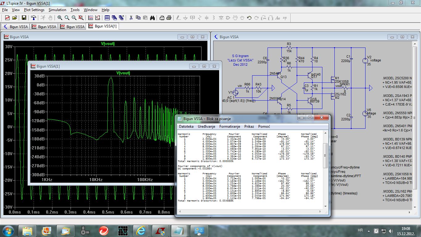

I setup the circuit from your diagram.
The DC-offset is very small, 12 mV.
The first thing I noticed is that circuit needs some compensation to be stable.
This was fixed with one 22pF from base to collector of KSA1381 and likewise 22pF around KSC3503.
The THD distortion at 1 Watt is remarkably low for such a simple amplifier:
THD 0.0002% at 1 Watt RMS.
Very nice amplifier![]()

This is THD20k before clipping(this amp clips at 28 V p with +-35 V of power supply)).
dado
WOW that's very good, H2 almost -90dB just before clipping at 20 kHz. Very good simple amp this VSSA is. Thanks dadod
