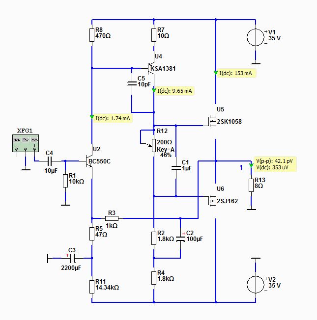

For those who want to experiment with really simple power amplifier:
OK for few parts more you get VSSA symmetrical amp with, as you've already said, better performance.
I make symmetrical amps only, that's my choice and I will stick to it in the future.

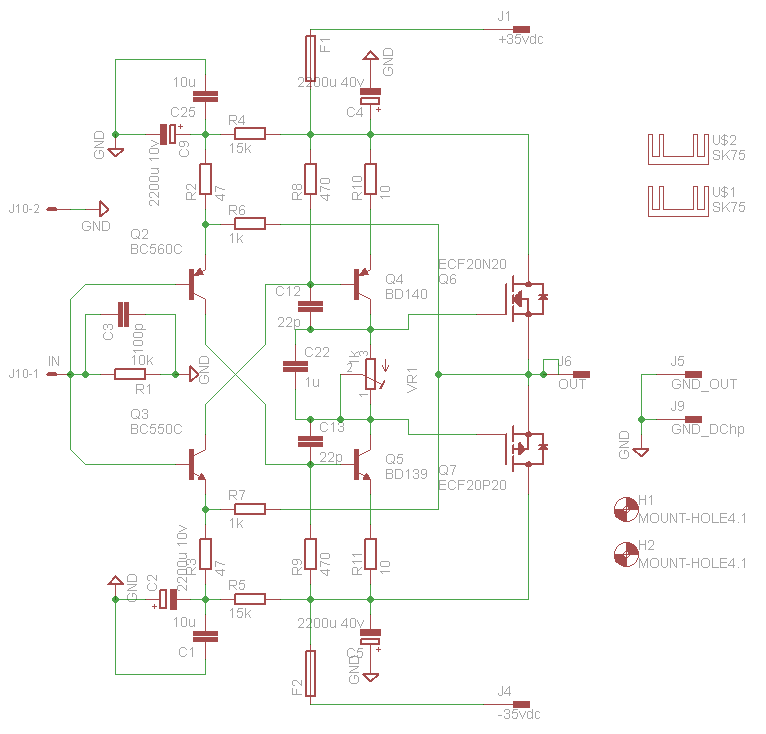

Hi LC,
To switch to 16A output devices, is swap from 2SC3503/2SA1381 to BD139/BD149 sufficient?
Marc
VAS BJT's are more like hFE, fT and Vce max parameters importance, since collector current is only 15mA and power dissipation around 0,5W. So any high performance NPN/PNP complemenary pair in TO-126 case is just fine here.
VSSA - Very Simple Symmetrical Amplifier, something in between SSA and TSSA. Similar schematics posted a lot of times but not exactly the same.
With only six transistors you can get genuine current feedback, high bandwidth amplifier, capable of driving 4 ohm speakers. PCB can be very simple and small too.![]()
I do not know how to say this. But such a circuit i have rejected as the VAS transistor current accelerates very fast to dangerous level without very good cooling.
As they get warmer they get higher hFE and lower VBE drop -> more current -> hotter -> higher hFE, lower VBE -> more current -> hotter ... Get the picture??

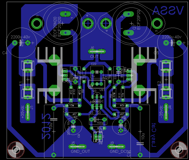

Hi LC i playing at this time with eagle...
First for TO3 as ia had layout for TO3 Lateral SSA. Will show you as it been ended. After it's easy to swap to plastic case.
Marc
Yes but there's certain limit level of input collector current reached when it is thermally stabilized. 15k resistor defines max input collector current, also VAS collector current rising itself will stop when heatsink power dissipation reaches certain temperature. It is perfectly normal process as long as input is stable and not forcing VAS current over the limits in a cummulative process.
Of course as I already mentioned in post #39, VAS BJT's needs them, could be one common or two separates.I just wanted to say that cooling is necessary on the VAS like 20K/W heatsinks

Here first attemp...107*93mm; Size could be smaller but 10µ polycaps and 2200µ 40v too. I have some improvement in mind to deduce pcb dimensions
Marc
