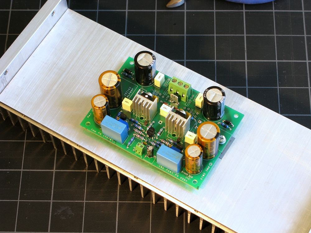

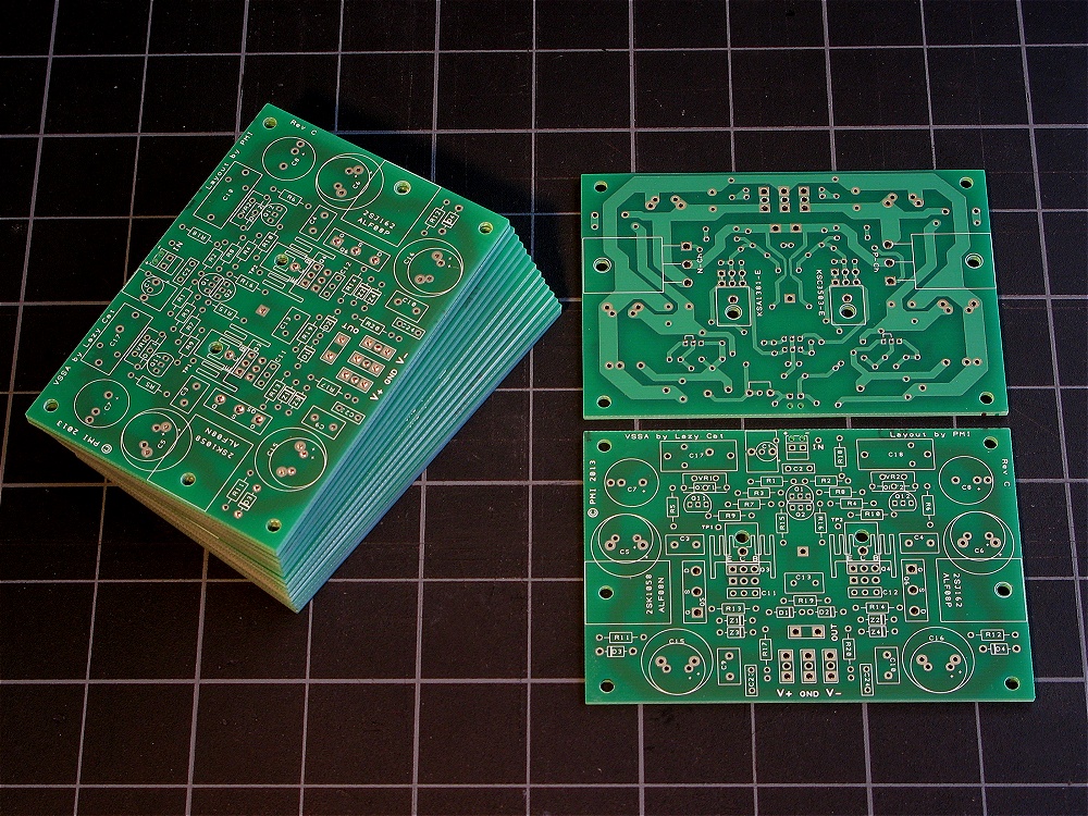

I have been encouraged to put the technical information for this board and layout into a separate thread. I am hoping that this will become the build thread for the Rev C circuit board, and for anyone who has my earlier Rev B version.
To give credit where it is due, the circuit design is from Lazy Cat's main VSSA thread, and inspiration for the through-hole version from Shaan and the PeeCeeBee thread. Most technical discussion and original schematics can be found there.
Schematics and BOM for the latest version will be posted here.
*** Revision C Latest Schematic and BOM ***
*** Dimensions and Mechanical Drawings ***
*** Notes on components and costs ***
This is my third VSSA version using all through-hole parts. 4th including the SMD modules from Lazy Cat... !
The main differences compared to the last revision are options for higher supply voltage and power, and options for better component and heatsink selection.
New in this revision:
Some of the test results have already been posted to the PeeCeeBee thread, the rest will be posted here soon.
I will do my best to keep this thread updated with test results and documentation, but new options and ideas appear in the PeeCeeBee thread almost daily, so please check there as well.
My thanks to Shaan, Lazy Cat, and various other people for their suggestions.
Special thanks to Ivan Lukic for his feedback and helping to move things along.

*** Latest Update: 4.11.2013, First production boards have been ordered, ***

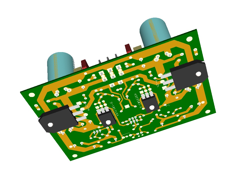

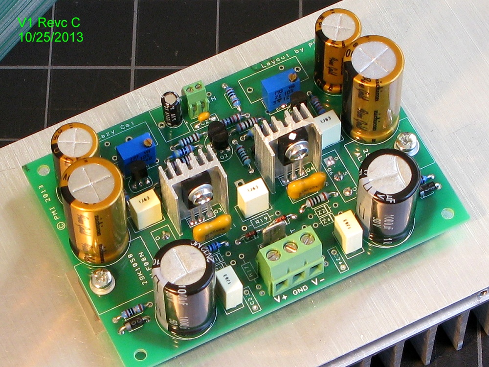

- Up to 100W/channel w. +/-45V supply and specified components, and 125W/channel w. some substitutions and higher supply rails
- More space for larger electrolytic decoupling and filter caps
- VAS transistors top-side or bottom mounted (see 3D models below for comparison)
- More space for bigger top-side heatsinks, or a common VAS heatsink.
- Optional Jfet CCS (recommended above about +/-37V supply voltage)
- TO-3P (Renesas Latfet) or TO-247 (Semelab Alfet) devices supported
- Pads for protection diodes for ALF08P/N16-20
Links to previous threads:
http://www.diyaudio.com/forums/vendors-bazaar/225747-vssa-lateral-mosfet-amplifier.html
http://www.diyaudio.com/forums/solid-state/231662-peeceebee.html

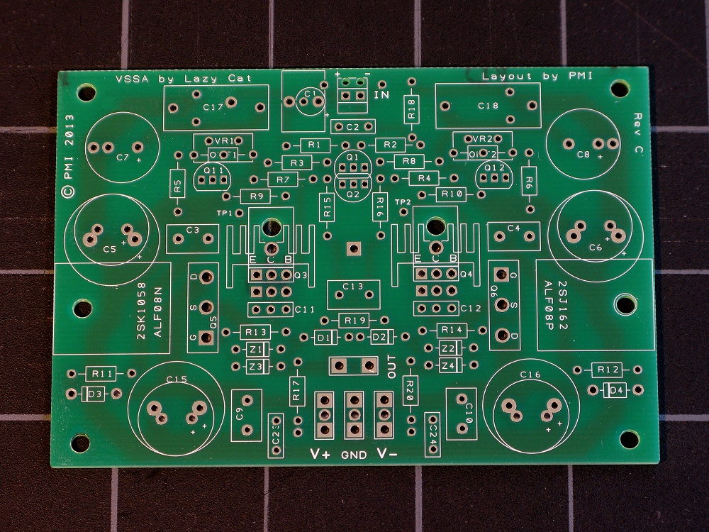

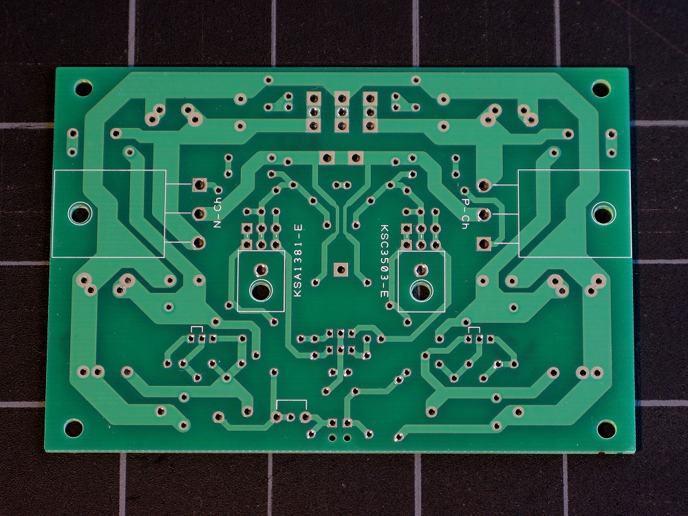

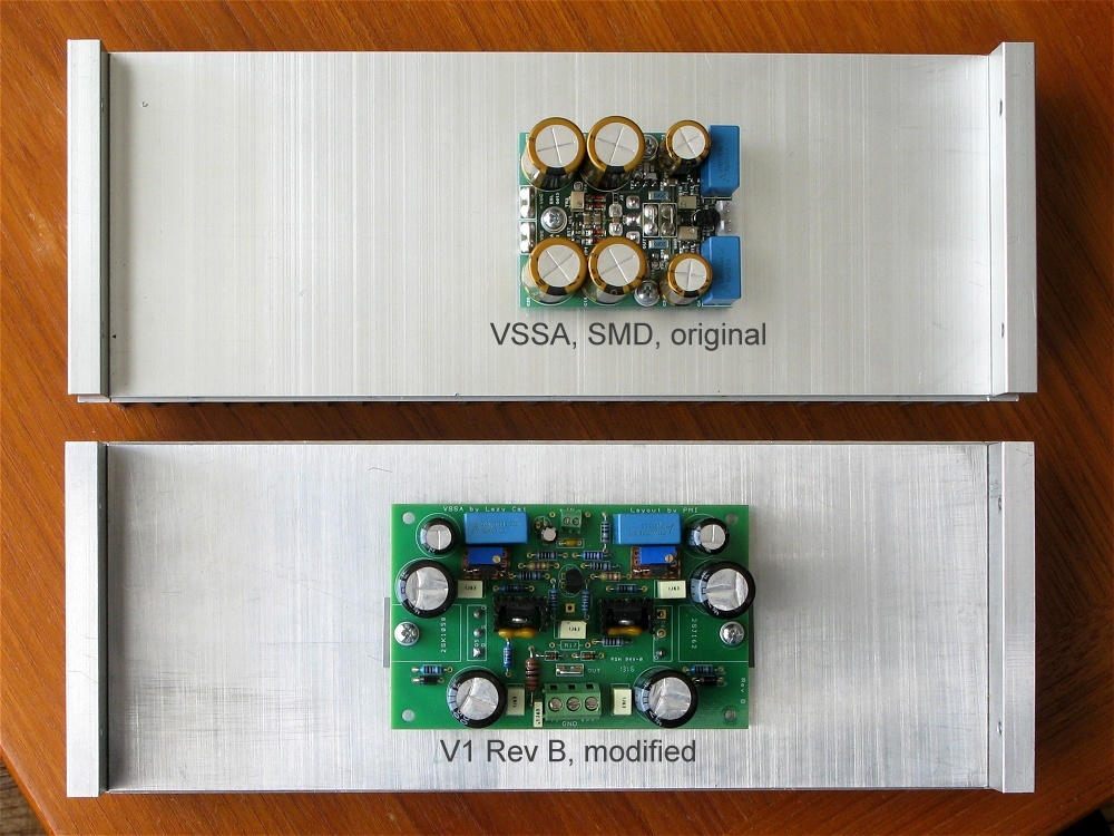

I should take this one first...PMI, how does this differ from LC's design apart from the obvious (TH in preference to SMT).
LC intended the VSSA module to fit into small spaces from the beginning, powered speakers, small multi-channel systems, etc. (so stated in his thread). I like space between components for rework, test leads, temperature probes and fat fingers...
The pic below shows the previous version and LC's module, mounted on same size heatsinks, side-by-side.
- Input filter. Perhaps not required, but it is there, and I use it. LC's VSSA board is direct coupled.
- Component values in the input, feedback, and CCS are a bit different.
- VAS transistors are on top-side by default, on their own heatsinks, bottom-side as an option.
- Output bias is set by two diodes, and if necessary can be adjusted with a parallel resistor, identical to Shaan's circuit (there is no TLVH431).
- Finally and most important - the output is two conventional devices, N-channel and P-channel. LC designed for a single device with two complementary dies packaged in one TO-264.
The latfets clip as close as 3V below the rail (tested). 100W is clearly specified in LC's documentation for VSSA, with one TO-264 package, and 45V rails. So, if you have a correctly rated heatsink, and manage to keep two devices cool, it should do just fine.Also wondering how you get 100wpc from only one pair of outputs. How does the power scale into 4R loads?
You also need a reasonably clean supply, 45V with lots of ripple on top will be a no-go.
I actually look forward to some discussion about components, power dissipation, etc. in this thread. I tried to start some in the PeeCeeBee thread and did not get far.
Yes, that, and the fact that even though there is just one circuit layer, the board is not strictly speaking a single-layer design, with plated holes, and solder mask top and bottom. However, it can still be built with close to the original PeeCeeBee schematic, at the lower supply voltages.@ PMI - I suppose the inclusion of these options was the reason for the 'encouragement' to take this off the PeeCeeBee thread?

1. I see some other CFA-amp use 2-3watt feedback resistor
see NX-amp by Bonsai
now where I can find these dale resistor
so 0.5watt is minimum if we go for higher supply (this what I thought).
2. Input cap must be there, I've omit it & blew some 10 ohm resistor because I play to much bass .
But I don't think that electrolyte the one you used is good enough, we need more option here. Big film caps also may act like an antenna...
3. 10ohm resistor dissipation (also on the zobel)
4. I'm curious what the sound with & without 10uF decoupling caps
5. Try to change VAS to another type to see how much the difference, like Jason used...
or may I change to to-220 device (driver transistor actually but easier to find) & what will happen...
Pete, sorry cos so many thoughts
more to come...
Regards
The 2.2K feedback resistor was fine at 1/4 watt, up to 35V supply voltage. Probably up to 45V, because it does not see a continuous signal at high power, just during peaks. There are some better resistors one can use, low noise, higher power, same lead spacing. I am not planning on anything bigger than 1W here.Yes the component selection is good start...

There are extra pads for bigger input caps, up to 15-mm. The Nichicon bi-polar electrolytic works well, and for testing, good enough.
The Zobel is split, so you can use two resistors. Pad spacing is also wider.
The schematic needs some cleanup, and some component values have to be updated. It will be posted here when I am done testing. The CCS works the same as the one shown in V1.4 of Lazy Cat's schematic. It takes the place of the resistor which has been variously posted as 15K, 18K, etc. in the other thread. It keeps the current close to constant ~2 mA over a wide range of supply voltage. You can just google "Jfet CCS" there are plenty of detailed examples and explanations, much better than anything I can post.Hi Pete,
