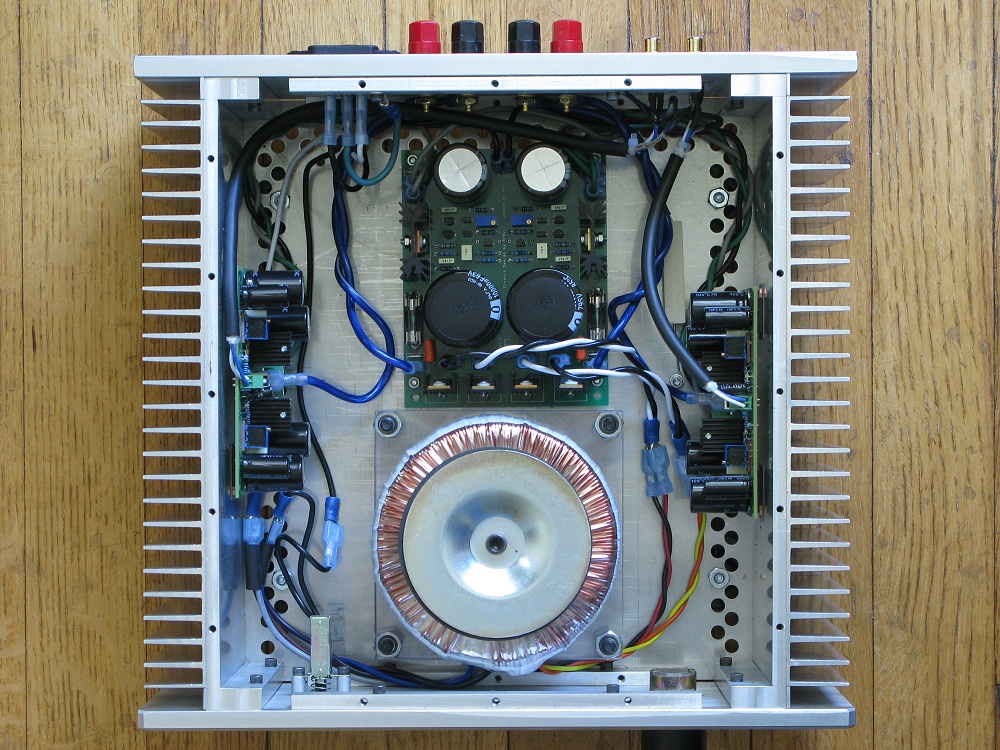

I've been playig my TO-3 VSSA on 4 ohm and 37V rails for a few days now without any issue that I can see. What should I be looking for to know if there is a problem?
Thanks, Terry
The magic blue smoke would be set free if there were an issue. The MOSFETs are really quite forgiving and rugged, given the dynamic nature of music I would not expect any issues with your set-up. For testing with full power sines use 8 ohm.
It's not even breaking a sweat. This is a very impressive amp. I just built a speaker switch so I could do an easy blind test with my amps. I have to tell you, the peeceebee doesn't take a back seat to any of my amps. I am using a B1 mezemerize and an X-BoZoZ for volume controls. I have been amazed how close all the amps are when their volumes are equalized. To my surprise, the peeceebee has a bigger soundstage than my Honey Badger. It really is an amazing design.
30~35V into 4 ohms, if you want to stay safe, but you could push it quite a bit, if you wanted to. With care, you can make some assumptions about the average current, and calculate back from that. most people want the extra power for dynamic range, not to blast out a continuous 1KHz sine wave at maximum power (chuckle).
Thanks for reporting. This gives me hope for my attempt to make a balanced version, my load is 8 OHM but each half will see half of it. I am using TO3 Exicons for that, very similar in specs with your K135/J50.

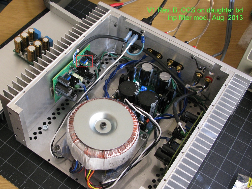

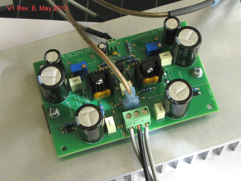

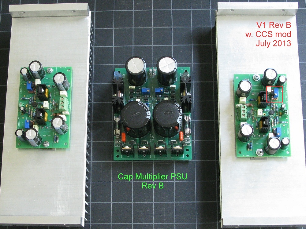

Several people have been helping, and I intended to have this revision about the same time as the CM PSU board, but ran out of time. (And I also wanted to play with Lazy Cat's modules... 😉) I have posted pics before, test results, and info for people who built the last version (see reposted pics below). So have one or two other people.
This revision diverged from the original PeeCeeBee topic too much to post the technical details there - however, my intent is to let anyone interested to etch the board from a pdf file, and build it with the simple components that Shaan proposed. I also needed a place to collect all the support documentation, and some of the component discussion, which was sort-of lost there.
