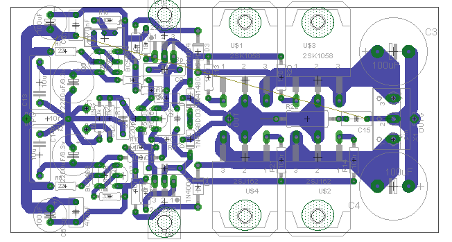

Stimulating some discussion...
PMI was hoping to make this a build and discussion thread, so rather than simply watch it plug up with requests for the goods (the PCB's that is) let's begin some active discussion.
I'd like to open perhaps with some discussion on the front end, specifically the transistor choice for the input pair and the CCSs that feed them current. We can also touch on the input coupling and filter section as well since some recent comments suggest there may be some value in adjusting these.
First off, I'm not sure which transistors have already been used by others aside from the ever popular BC550C / BC560C and my use of 2SA965 / 2SC2235 in my initial 'junk box' PeeCeeBee and then moving to some 2SA992F / 2SC1845F for better parameters like higher hFE and lower Cob. Any others we should be exploring actively?
I have personally done very little with JFETs. What are the current recommendations and selection criteria? I know we need and IDSS at least a little higher than our target for self bias with a reasonable source resistor value and a suitable Vds rating for starters.
Finally, the current values of the input band limiting filter set the high frequency corner at 1.6MHz. It has been noted that this is quite high. Would a lower limit more like 200kHz (10x the audio band) be more suitable?
I suggest we work at least somewhat methodically through the circuit to see how we can best optimize it with prudent active component selection and value changes of passives if warranted. It would be still nice to avoid difficult to source parts as was one of the goals back in the PeeCeeBee thread.

I have not had any problems at +/-45V. I can't run at 50V until I build the next pair of test boards with different input transistors, and higher rated feedback resistors.Pete, I'll wait for your higher voltage test with single pair output...
yes the VAS will be so hot & I don't like that hot, they are only 5-7w device
My 2 pairs output show instability with more than +/-40VDC...
Most of my measurements are taken at lower voltages, basically for convenience, but after your last post, I ran a few quick tests, using a bigger transformer (400VA) and a Variac. No measurements taken, just a few tests, because full power at 45V can't be sustained for long with what I have.
The waveforms do not look much different than at 30V. I ran up to clipping at 1KHz, 10KHz, and 50KHz, sines and squares, each test about 30~40 seconds, unloaded and loaded, checked the slew rate, etc.
Clipping behavior is nice and controlled, you could almost call it "soft" clipping.
I set the VAS bias to 12 mA at 30V, and with the CCS, it increases to about 15mA at 45V. I did not take the time to recalibrate at 45V.
No instability noted.
If anything, the 10 and 50KHz square waves look better loaded than unloaded, because there is no overshoot on the leading and trailing edges. This leads me to think the input filter bandwidth is set unnecessarily high (more on this later).

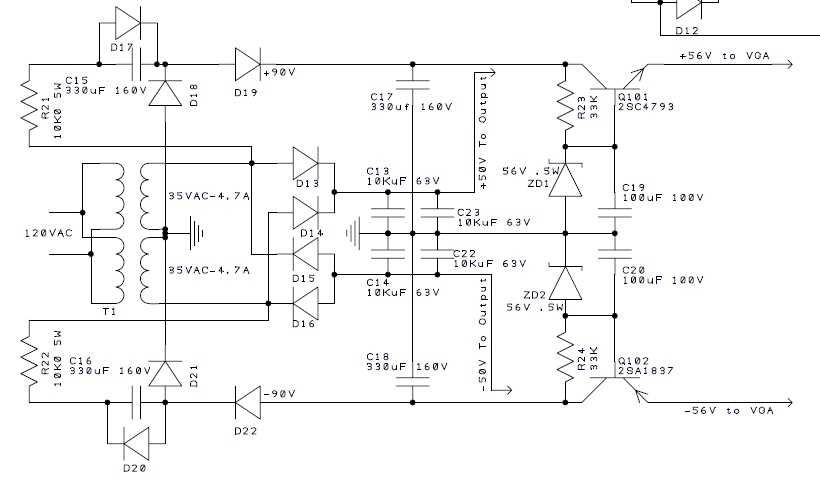

Power supply
Hello,
There has been some discussion around the power supply and I would like to show one potent option for it.
It has been shamelessly stolen from Steven Dunlap´s Krill schematic. I have used this type of supply with other amp projects with great success. Of course you may need to adjust some of the values according to the desired attenuation for input/vas. You may even add fancier regulator after the zener/transistor regulator.
Jarno
