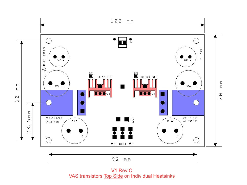

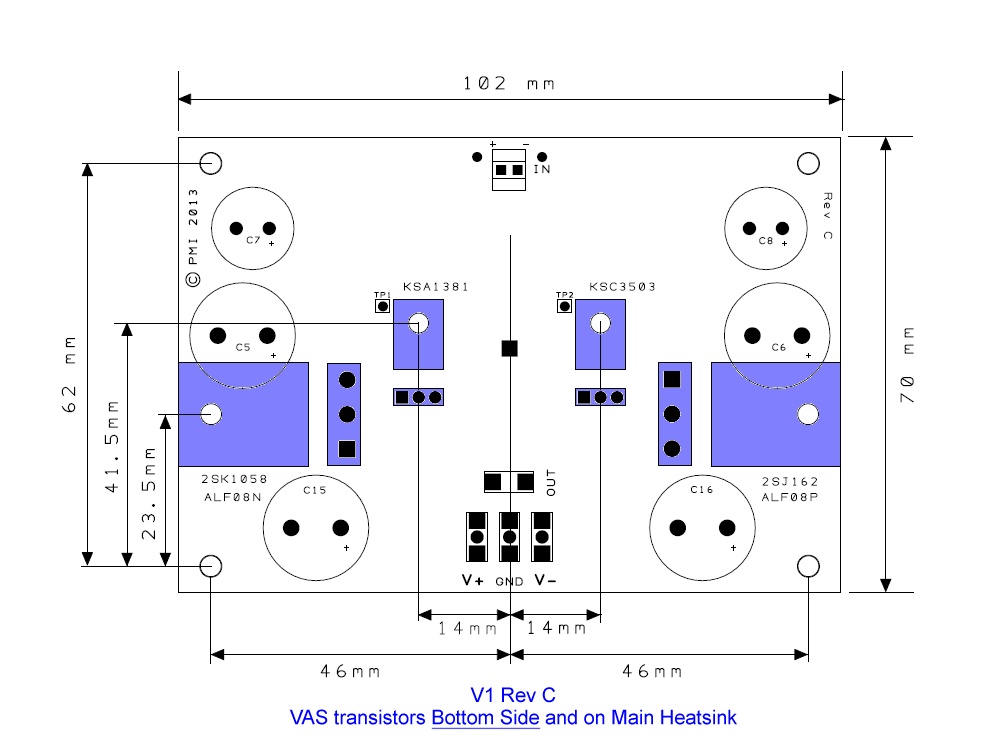

Dimensions & Mounting Holes
Outside dimensions of the circuit board are 102 x 70 mm (4"x2.75"). When the circuit board is vertically centered on a typical heatsink with external fins, the power devices will be offset toward the bottom for better thermal management. Ideal position would be with the latfet mounting screws 40~45% of the heatsing height from the bottom, and 55~60% from the top.
There are 8 mounting holes, most of them optional. The circuit board is stable, even if only atached to the heatsink using the two Latfet mounting screws.
Two aditional M3 screws can be used for added support. Not more than 4 total recommended, because alignment becomes more difficult with each additional pair. Two examples are shown below.
For best results, the version with the VAS heatsinks should be mounted so that warm air can rise up toward the top of the chassis without obstruction or heating the electrolytic caps. The version with VAS transistors on the main heatsink can be rotated 180 degrees if more convenient.
First Pic, VAS transistor top-side
Latfets: Blue hilite
VAS top-side: Red hilite, including VAS heatsinks
Second Pic, VAS transistors bottom
VAS bottom-side: Blue hilite, mounted on main heatsink.
