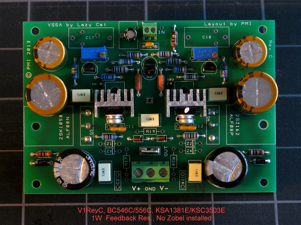

Project Status
As of yesterday, all of the basic testing I was planning on has been done. As time allows over the next few days, I will post as many test results as I have time for.
I have enough boards on hand to start sending them out to the people who have been patiently waiting for me to finish.
As of today, I have also ordered a couple dozen more to cover the next group. The boards are small enough that I can get them at a discount even in smaller quantity, so waiting for a bigger order is not really necessary.
This means those who expressed their interest earlier can get boards without much more waiting, and at the same time, it means I have to deal with fewer packages at one time - it will also help compensate for my usual rate of progress 😀:snail:
More details in a day or so.
If there are more requests after this, I will open a Group Buy thread.
In either case, I plan to get enough for everyone who has requested boards so far, plus a few spares.

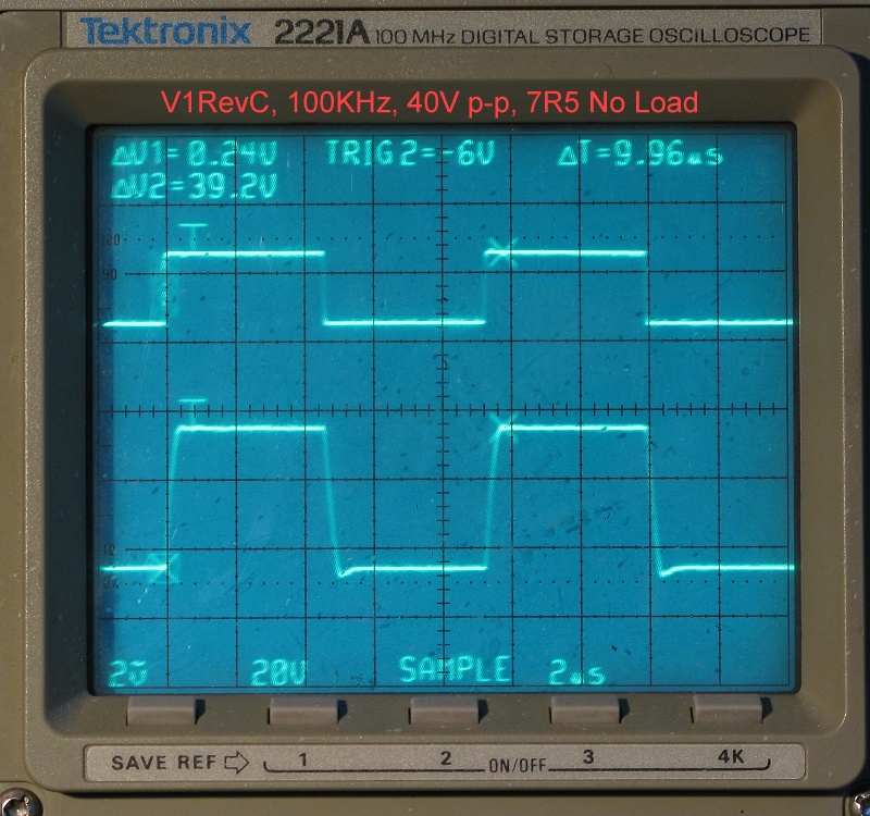

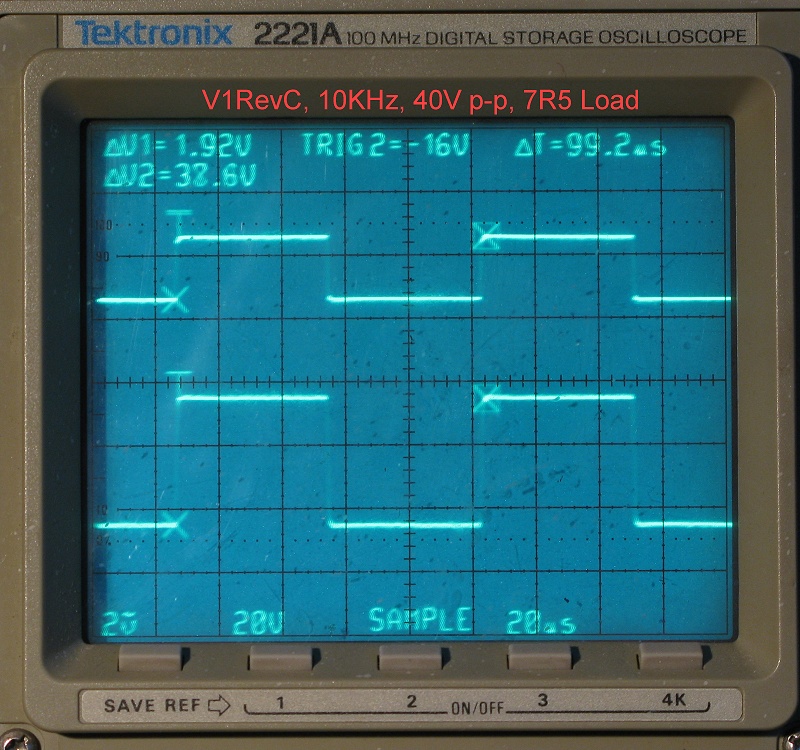

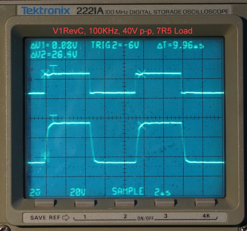

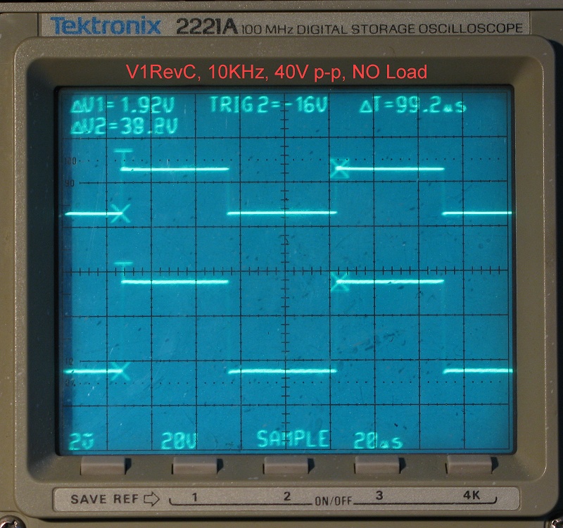

Test Results, Square Wave Sweeps
Test results from last weekend, using a board built to incorporate some of the earlier component suggestions. In other words, in the interest of disclosure, this is a tweaked board, incorporating suggestions and comments I have received, compared to the previous tests which were done with the base-line components listed in the BOM. It was built specifically so I could test the limits of the circuit.
Input filter is unchanged for these. Input transistors were hand selected and matched from the old-stock lot of BC546C/BC556C. Feedback 2.2K resistors are Vishay/Dale CPF1 (1== 1 Watt rating). KSA1381E/KSC3503E, matched to 5%, 22pF compensation caps. Zobel not installed. 10uF film caps, C17, C18 not installed.
Poweer Supply: +/-35.5V
Input bias: ~2 mA
VAS bias: ~17 mA
Total Idle current: 154 mA
The board is a little "faster" than with the first set of components, and square waves look a bit more symmetric, but the differences are almost not noticeable compared to the last tests. I ran the full sweep, 10 Hz to 100KHz, but there is not much to see below 10K. I am using 10K as the baseline, and to adjust the signal generator, scope, etc.
You have to look at frequencies above 20KHz to even detect a difference, or see something interesting, which is why I posted the 100K Hz square wave instead 50K, or 20K.
The overshoot at the negative edge of the trace in the unloaded 100 KHz pic is due to a tiny bit of ringing on the negative going output of the signal generator, not visible in the pics. (this may well be another argument for limiting the BW)
The 1W feedback resistor is not something I am proposing for a practical amp at this supply voltage, I simply need it to run continuous-signal tests at higher power, not to listen to music.
Bottom line, 10KHz results for this circuit look like 1KHz from other amps, and it takes a 100KHz square wave before it starts to show its limits... 😀

Here some of my preferences (wish) for modifications of your last layout:
1) support TO-220 bce pin out for VAS with mounting on top or below pcb - if possible;
2) feedback and input gnd together;
3) separate tracks for gnd return of input/feedback and decoupling caps. Star gnd;
4) at least 2 pairs of MOSFET output and be able to use double die device. I want more than 100 W and be able to drive low impedance speakers;
5) I prefer securing the output MOSFET with big metal washer than with the pcb;
6) possibility to connect a regulated supply for the front end including a tab for the regulator gnd to connect to the star gnd;
7) use bipolar caps for feedback. Good quality value only up to 1000uf so 2 in //;
8) 2 pairs of filter caps for the mosfets;
9) 2W feedback resistors size;
10) footprint to have compensation cap like the NX amp instead of 2 miller caps ( to experiment)
11) small value decoupling cap very close to output mosfets
I realize that the pcb size would need to increase significantly so it may not suit your objective....
Also it may be more work than you hâve anticipated....

The current layout was made so that the first main decoupling cap combo was balanced relative to the power and ground trace length, and the ground to the front end splits off from that point. The Diode and 10R were located at that point so the 10R effectively separates the rail near the main decoupling cap. The power supply return on the board carries very little current, compared to the +/-supply. This is not an argument against, but just an explanation of what was done, and why. I can certainly re-arrange ground traces as you suggest, but you may lose more than you gain.
1) I thought I allowed enough room this time (?) Still not enough to mount on a 180 degree turn? If this does not work, I know someone else will be disappointed... 🙁
2) OK
3) OK, but see above paragraph.
4) Double-die TO-264 already discussed, and supported, but w. off-board mounting screw, a bit elaborate but workable for a test board. About two pair, see below.
5) See 4.
6) a) already consdered, and space allowed for b) clarification needed.
7) Depends how big (?)
8) What value and diameter, i.e., how much bigger can you stand to make the board?
9) I intentionally left room for longer/wider feedback resistors. Note empty space between R15/R16 and C13.
10) OK
11) Already considered that. This is one of those places where an SMD part can be helpful, b/c you can locate one right at the leads.
The main departure is the double Mosfet pair, and double caps. That makes it a different design and different layout. The double-die TO-264 packages are attractive, because the two devices inside are matched from the factory, but availability is uncertain. Still probably worth looking into. I believe Marc has already posted one like that I really like, have you seen it?
