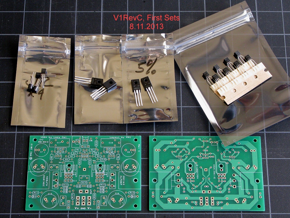

Project Status
First few sets of boards are shipping today. These are going mostly to a few people who have been following my posts in the PeeCeeBee thread for the last few months. If you are one of them, and depending on what you asked for, the package includes some or all of the following:
(2) Circuit Boards
(4) J112 jfets for the optional CCS
(2) Sets KSA1381E/KSC3503E, one per board
(4) Sets BC546C/BC556C (2 required, 2 spare) for operation over 45V
As of today, I also have a ship date for the first production order. I still have to check the FedEx delivery schedule, but that batch should be in my hands in about one week, and will start to ship around November 18.
