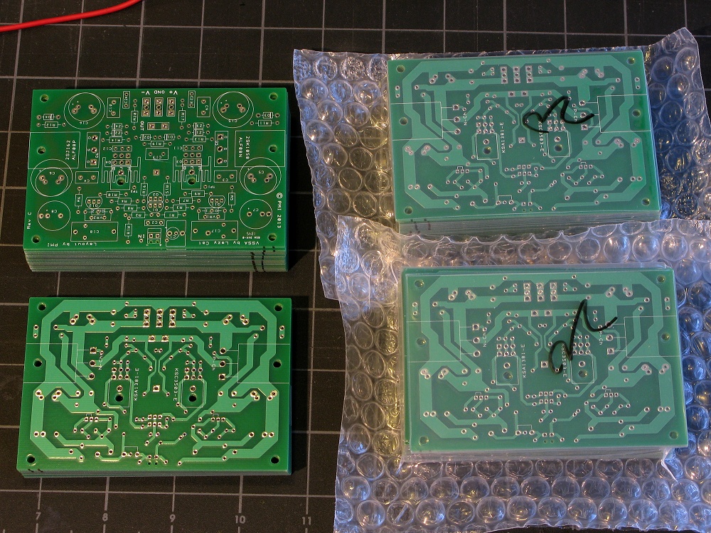

Thanks! Your boards and parts were shipped. Those came from the first batch, same as Terry's.Hope so. Got some outputs on the way, so we should have some action in a while.
@PMI - those alternative VAS devices are on the way via regular air mail.
Good News.!
i have just busted my drill bit, so awaiting another one.
Ref: My DIY Board based on yours, It makes a nice 'Looking' board, but Man are those holes Small & hard to solder without the thru hole plating. ( or more likely, it's just Me ) or possibly the Cheap Boards. This problem was on the.032" 1/2oz board. Was drilling out the .064" board when i broke the bit.

Yes, thanks for asking.PMI , in post 29 I ordered 2 boards to I've to pay now?
I will be sending out payment requests by PM tomorrow, and the first boards from this order will ship on Monday.
To everyone who will be making payments by Paypal:
1) You correct shipping address must be either in Paypal, or in the comment field of your payment. Orders without addresses take more emails, and therefore more time.
2) Please include your diyaudio name, and number of boards you are ordering, so the payments can be matched easily to the list.
