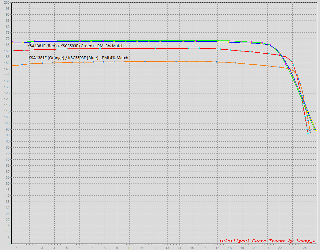

I will run the curves either later tonight or over the weekend on the KSA / KSC devices and see how closely they match up. I am waiting for some components to arrive for these but will post results as I'm able.

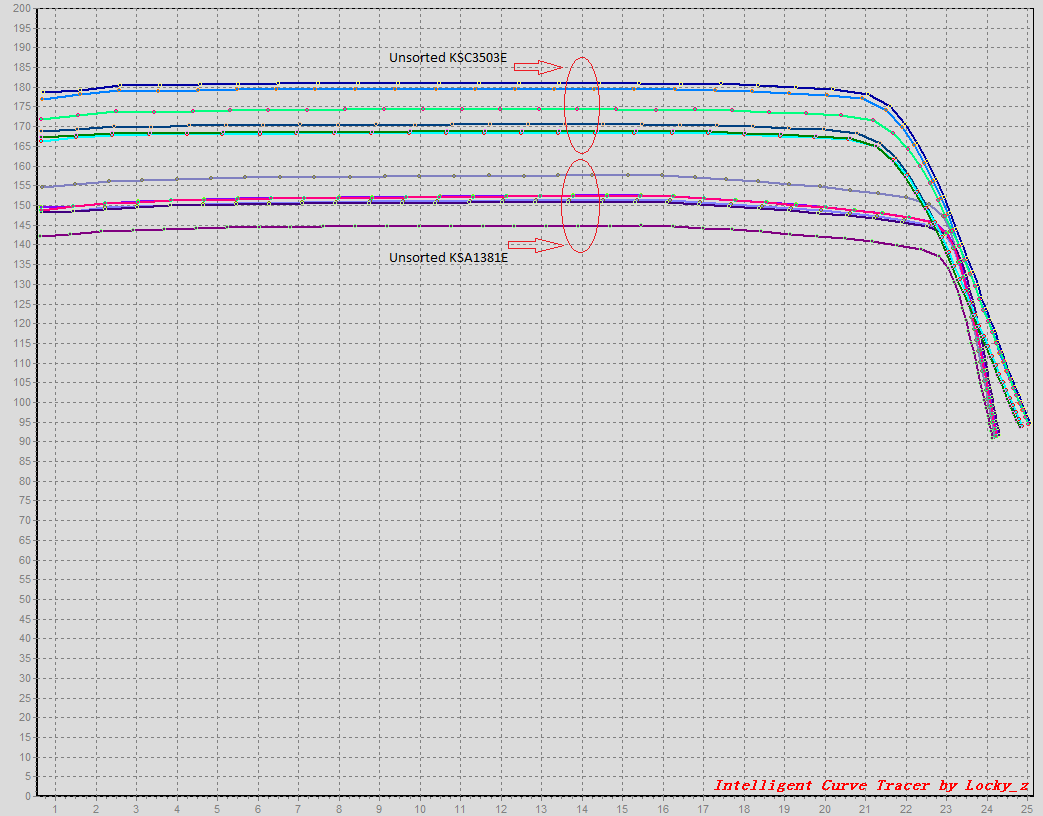

The Hfe is clearly lower when measured cold than when measured after the temperature has stabilized. I also did not have much trouble finding closer matches when measured warm, so perhaps that requires a bit of exploration.The curves for the unsorted devices.
I am really happy to see that the curve is flat over such a wide range of Ic, btw. I have no way of showing that with manual measurement.
This curve tracer seems like an excellent find!
edit:
This also clearly shows we should not be setting the bias above 20 mA. I had pretty much figured that out by experimenting, but did not want to say it because I had no measurements to prove it... now we do!
