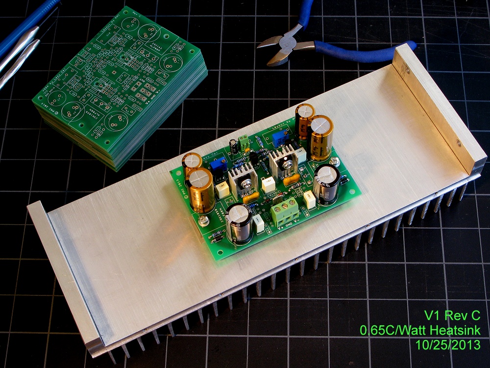

Revision C Schematic, BOM
The schematic and BOM have been cleaned up a bit. Component values now correspond to the boards I have been testing, and schematic and BOM should now be consistent. Please note that the recommended values of some resistors, and a couple small caps in the input filter may change as a result of the discussion started above.
The main heatsink shown in the various pics was selected based on the recommendation in the main VSSA thread for +/-45V supply voltage, and 160 mA per channel total idle current. It came from one of the diyaudio advertisers, HeatsinkUSA. Original size was 10"x4" with one inch fins, 0.65C/watt. It is one of their standard extrusions, cut to 4-inches. I believe the cost of the extrusion, was around $12, plus cutting to size and shipping. The brackets at the ends are 3/8" aluminum, and help with thermal coupling to the front and back plates of the chassis.

One set of boards from the last revision was assembled using an ordinary soldering iron with a medium tip, and no temperature control. No problems, and boards worked fine. (Note that having a fine-tip soldering iron does help, and is quicker.)
Using SMDs in a few places would have made the board smaller, and the traces shorter, but in quantities under 100 pieces, it makes little difference. If I had to make a board in any quantity, it would be no contest.
I think the nx-Amp boards Bonsai designed are a good example of using SMDs where they can be of most benefit, and leaving the rest as TH.
