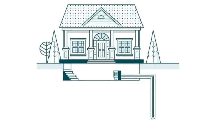

Supposing you have a perfectly insulated house, how deep would you have to go to get geothermal at a comfortable temp ( say if you had thermaly conductive foundations, or just pipes with a computer fan)?

Having looked at this a bit, most companies like to drill down at least 100Mtrs. The problem is that they want £40+ per Mtr drilled. Average homes need between one and two holes. For shallow trench geothermal they go down 1.2Mtrs, but a large area of coverage is required (I was told half to three quarters of an acre), otherwise the ground can freeze. All being said if the property is well insulated it's less likely as the drawer off is smaller. As long as the radiators are oversized (50%) I was told 55 degrees flow temp from the heat pump is OK, thus keeping the COP high. Personally I like the idea of PV's with battery storage (for any extra electricity produced) using an air source heat pump and some heat store buffer storage.
Temperature rises by about 3° per 100 m of drilling depth.how deep would you have to go to get geothermal at a comfortable temp
The average temperature of the earth surface in europe is about 12°.
So without heat pump you would have to drill quite deep.
Not ttoo deep i understand. One of our members (from Duncan) works for a compzny installing heat pumps that use the geothermal cache to generate heat. Once you get down far enuff the temperature is a pretty constant 13° C.

How deep: it depends https://dandelionenergy.com/determining-the-appropriate-length-of-a-geothermal-borehole

Perhaps. I fell over this site which has all sorts of useful information including a formula for calculating yields. It's not for those triggered by complex equations...I think it was because the "chimney effect" of them being vertical helped dissipate heat
