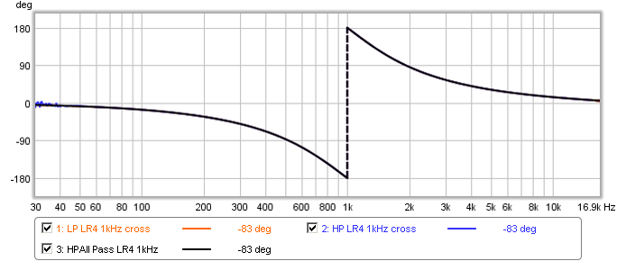

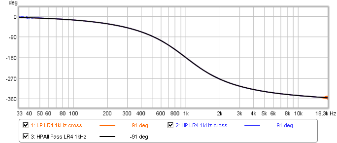

Take a 2nd order L/R low pass and high pass. Individually they are minimum phase. Sum their outputs together and the amplitude response is perfectly flat however the sum is not minimum phase because there is a 180 degree total phase rotation from low frequencies to high frequencies. It forms an all-pass filter.
The excess phase / excess group delay without any change of amplitude response was the whole point of pano's test. 😉
Take Linkwitz-Riley 4th order 24dB/oct 1kHz crossover pair, high pass and low pass have identical phase. All pass sum has identical phase. 360 degrees. It is completely minimum phase system with flat frequency response:
Wrapped display of phase:
Unwrapped phase:
Each order in filter places 90 degrees of phase shift from DC to Nyquist. Typical Cartesian phase plot show +/-180 degrees with vertical broken dashed line showing continuation of plot; this is not a 180 degree phase inversion.

Sorry, but you don't seem to be listening to what I'm saying. The individual high pass and low pass sections are minimum phase by themselves. The summed response of a 4th order L/R crossover (or indeed any order 2nd or above) is not minimum phase. I don't know how I can be any clearer than that.
Please sum the response of the low and high pass sections and show me how it can be minimum phase because it is not. This is basic stuff. 🙄

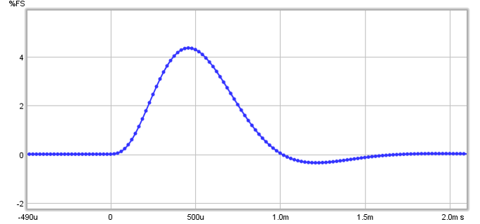

Pictures in previous post are very clear; showing overlays of phase for low pass, high pass, and all pass as sum. Being all the same phase, all starting at the same time

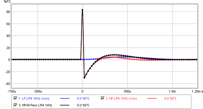

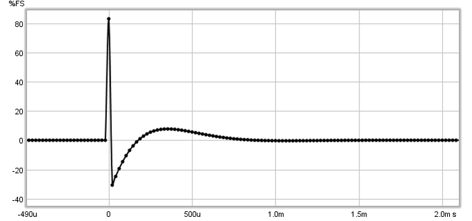

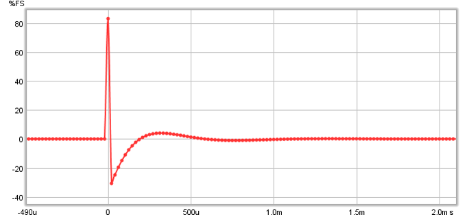

Here are IR responses of Linkwitz-Riley 4th order 24dB/oct 1kHz crossover pair:
high pass:
low pass:
all pass as sum:
above in overlay view:
What about all pass IR pictured above isn't minimum phase?
"what about all pass IR pictured above isn't minimum phase?"

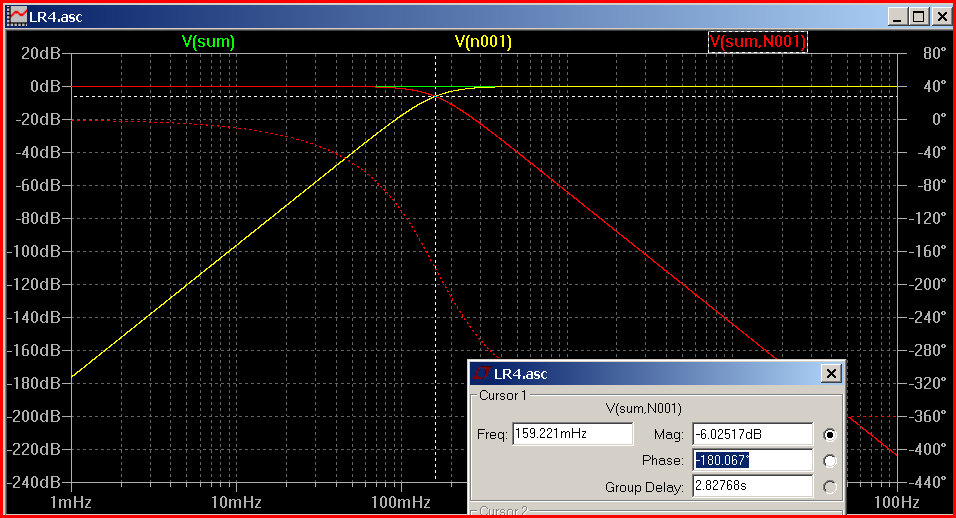

The summed response of LP+HP ( LR4) is perfectly flat in amplitude but phase turns, giving a all-pass. Amplitude and phase in the sum are no longer linked by Hilbert's transform as were, separetely, LP and HP.

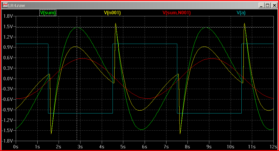

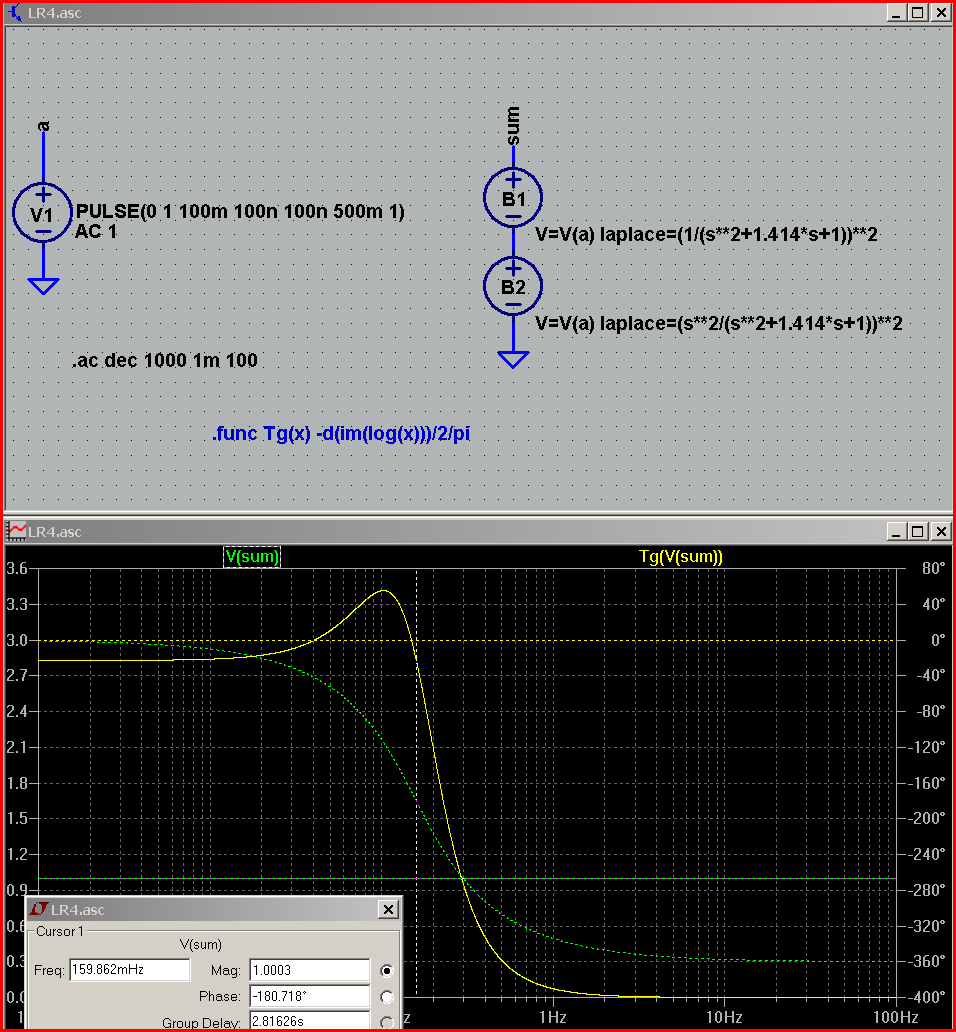

crd
LR4 has 360 degrees phase rotation (right axis, green dotted line)
normalized plot - fxo = 159 mHz (1 rad/s)
the green sum frequency response amplitude is flat at 1.0 - under the cursor dotted line in the 1st plot
Tg=Group delay (yellow, left axis) is in seconds for this low freq - would be x10 ms for 160 Hz XO frequency
the 1/6 Hz square wave .tran green sum shows lots of phase error
red LP is nearly a sine in the .tran plot - but with basically inverted polarity

LR4 has 360 degrees phase rotation (right axis, green)
red LP is a sine - but with basically inverted polarity

Yes, but phase response of LP and HP are identical. Thus sum is minimum phase, identical to LP and HP components. This is beauty of Linkwitz-Riley transform. Convolution of a Butterworth filter with itself, cascading stages, same thing.
Barley, I think you need to do some homework on the definition of Minimum Phase.
There are several possible definitions.
One is that the Amplitude & Phase responses are uniquely linked via various Hilbert Transforms [*]. ie for a Minimum Phase transfer function, there is only ONE Phase response which corresponds to its Amplitude response. For a flat Amplitude response, the unique phase response is 0 (or 180) phase.
All-pass networks are (by definition) non-Minimum Phase.
Bear in mind also what the term Minimum Phase implies. Alternative titles might be Minimum Group Delay, Minimum Smear or Minimum Energy Delay.
A Minimum Phase transfer function will have the least Delay, Smear of any transfer function with the same amplitude response. You can dream up your own definition of Delay, Smear etc and try various phase responses to see if you can get less or better Delay, Smear etc compared with a Minimum Phase response.
[*] Various cos there is Log amplitude, Lin amplitude, Re & Im, exponential versions ... etc.
