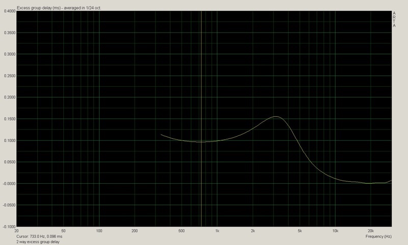

Imagine you measure the response of a driver at a certain distance and our imaginary driver has a nice flat amplitude response.
The further the distance from the speaker to mic, the steeper the phase curve will be, because a constant time delay will cause more phase shift the higher in frequency you go. If there is no group delay the phase shift will be a straight line on a linear frequency axis.
That's why the steepness of the phase curve is equivalent to time delay.
Now imagine what happens when we cross over between two drivers, one of which is closer to the mic than the other. Well into the passband of the closer driver the steepness of the phase curve will be a certain slope, however when we fully cross over to the further away driver the phase curve must be steeper because of the additional distance (delay) causing more phase shift per Hz. This causes a transition from less to more group delay as we transition from one driver to the other, therefore a shelf in group delay due to the physical offset.
It's not quite that simple though because the all pass response of the summed high pass and low pass also causes a temporary increase in phase slope around the crossover due to the way the phase of the two sources sum, even if the drivers were time aligned. The delay is purely electrical but just as real.
So what you end up with time misaligned drivers crossing over to each other is a shelf between the two frequency ranges but also with a peak in group delay near the transition region that goes above the higher side of the shelf.
See below for an example of a 3rd order crossover at 4Khz with the tweeter about 20mm closer than the midbass. The measurement is only accurate down to about 500Hz due to the gating time but you can clearly see the peak in GD as well as the shelf on either side.
The reason why the curve is so smooth despite being an acoustic measurement is that its actually excess group delay, which factors out the group delay related to amplitude response changes.
PS I'd forgotten just how small the group delay is in typical crossover arrangements, its far below the 0.5ms guess I suggested earlier, with the group delay from the 3rd order crossover being less than that caused by the 20mm error in driver alignment. In this example about 0.1ms from the acoustic alignment error and a further 0.05ms from the crossover itself.

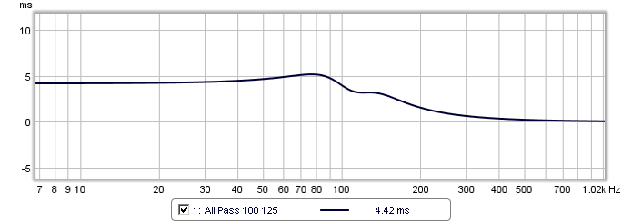

Yes, percussion on track is only sound with hard transient. Pano's Butterworth filtering for this is form of shelving filter, and from group delay perspective looks something like this:

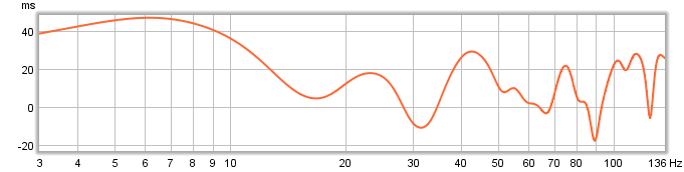

Very mild compared to temporal aberration with speaker in living room measured at listening position:
Above is raw cardioid woofer setup with previously posted DSP correction results in #36

You can't directly compare these two graphs (for audibility) though - you're comparing apples to oranges because the first one is group delay that is caused only by excess phase (the frequency response is still flat with pano's summed filters) but the second one is clearly group delay that is caused largely by amplitude response non flatness, eg group delay that is due to both minimum phase and excess phase components but with minimum phase components dominating.
Therefore you can't tell anything about how "audible" this group delay is in comparison to the first, because most of it is caused by a very non-flat amplitude response which will be audible in and of itself.
As I said in my previous post, lumping together the audibility of group delay and excess group delay (pano's test has only excess group delay) has been going on throughout the thread and only serves to confuse the issue.
The only valid test to determine whether group delay by itself is audible is to maintain identical amplitude responses which means we are really studying excess group delay, not group delay.
Any test where we're altering the frequency response to produce group delay proves nothing except that frequency response alterations are audible...
Out of interest, try showing us the excess group delay instead of group delay on your bottom measurement, you'll find that across most of the bass region the excess group delay will be relatively flat even in a room, but there may be one or two frequencies where it peaks up really high, typically where there is either a notch in the amplitude response or where the reflections are higher in amplitude than the direct signal...this is useful because it shows us where (with the current speaker configuration and listening position) we cannot EQ out the response error with normal minimum phase EQ...

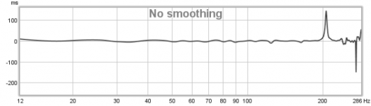

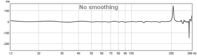

Pano's test with "Josie" is convolution with sum of two minimum phase filters, indexed to causal start of each resulting in perfectly minimum phase filter. Zero excess phase.
Points about excess phase are well taken into consideration with corrections I produce. In case of posted sub setup room response is speaker response at listening position. This is excess phase of raw cardioid sub:
In above first big excess phase event is above range of sub. For main speaker measurement and correction due consideration is given, and excess phase between two measurements is adjusted for when integrating filters from different measurements.
Fully corrected system is basis for comparison, and I find my setup reproduces waveform of source to much greater fidelity than any uncorrected system I've worked with.

here's the modification on the file
it's about 4-5 ms delay below 125 Hz.
it's like the woofer is 4.7 fts stepping back.
24 db/oct recombined.
and the group delay modification
