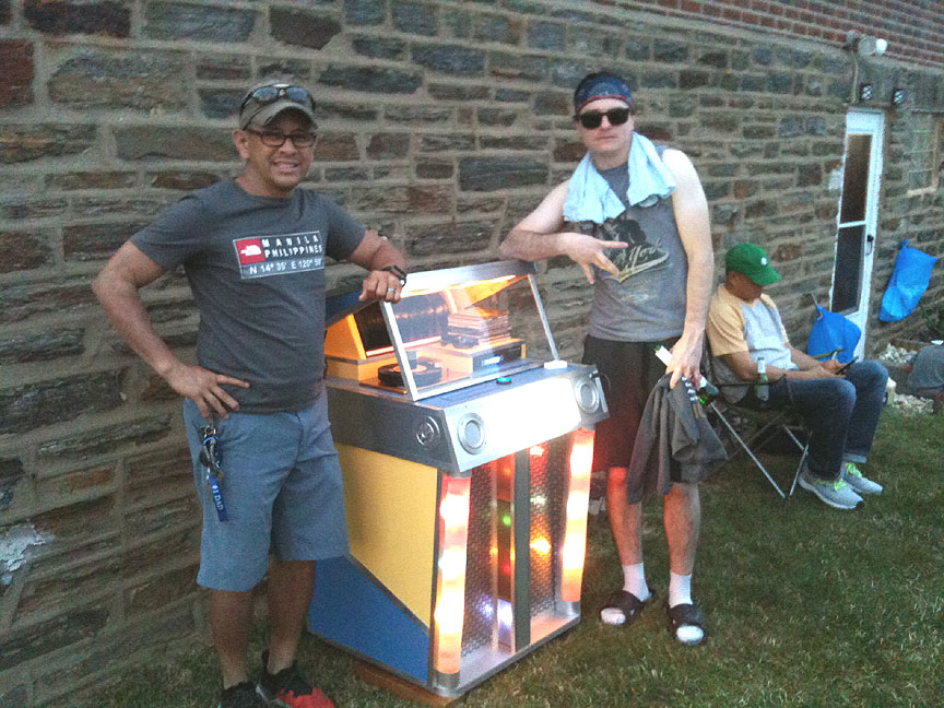

This year's July 4th holiday, us neighbors got together for a cookout in my neighbor's yard, and they begged me to haul out my home-made custom jukebox that's been sitting since 2015 in my garage.
Thankfully, I have casters on the bottom.
200 watts, 4 10" woofers, 4 tweeters.
one "loudness" test that day had the music echoing off buildings down the street, but we kept it at reasonable levels for consideration of the neighbor's ears.
