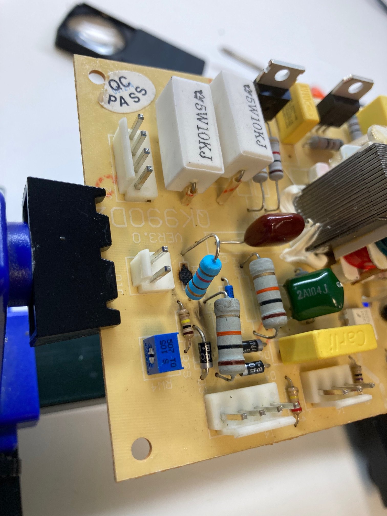

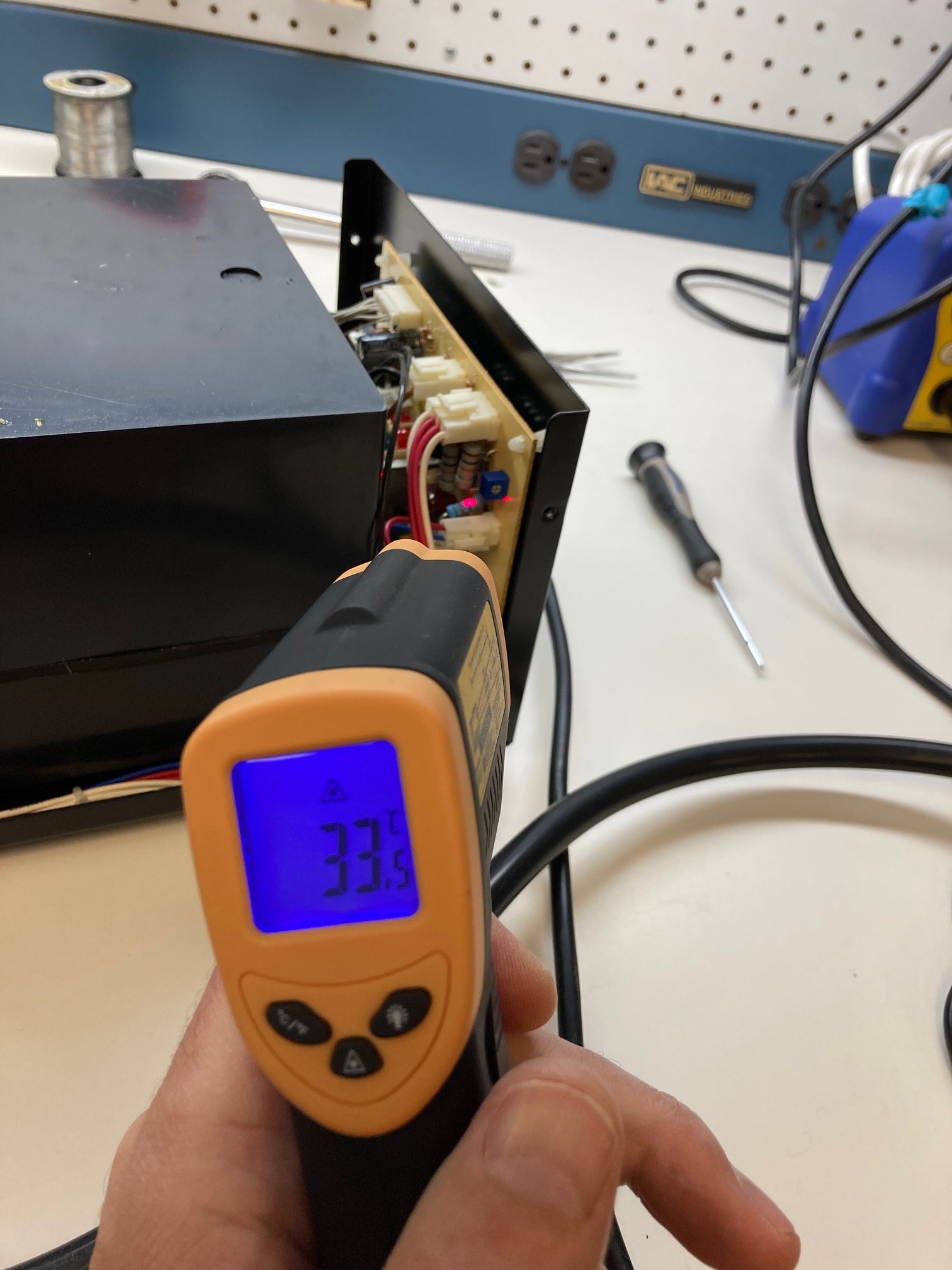

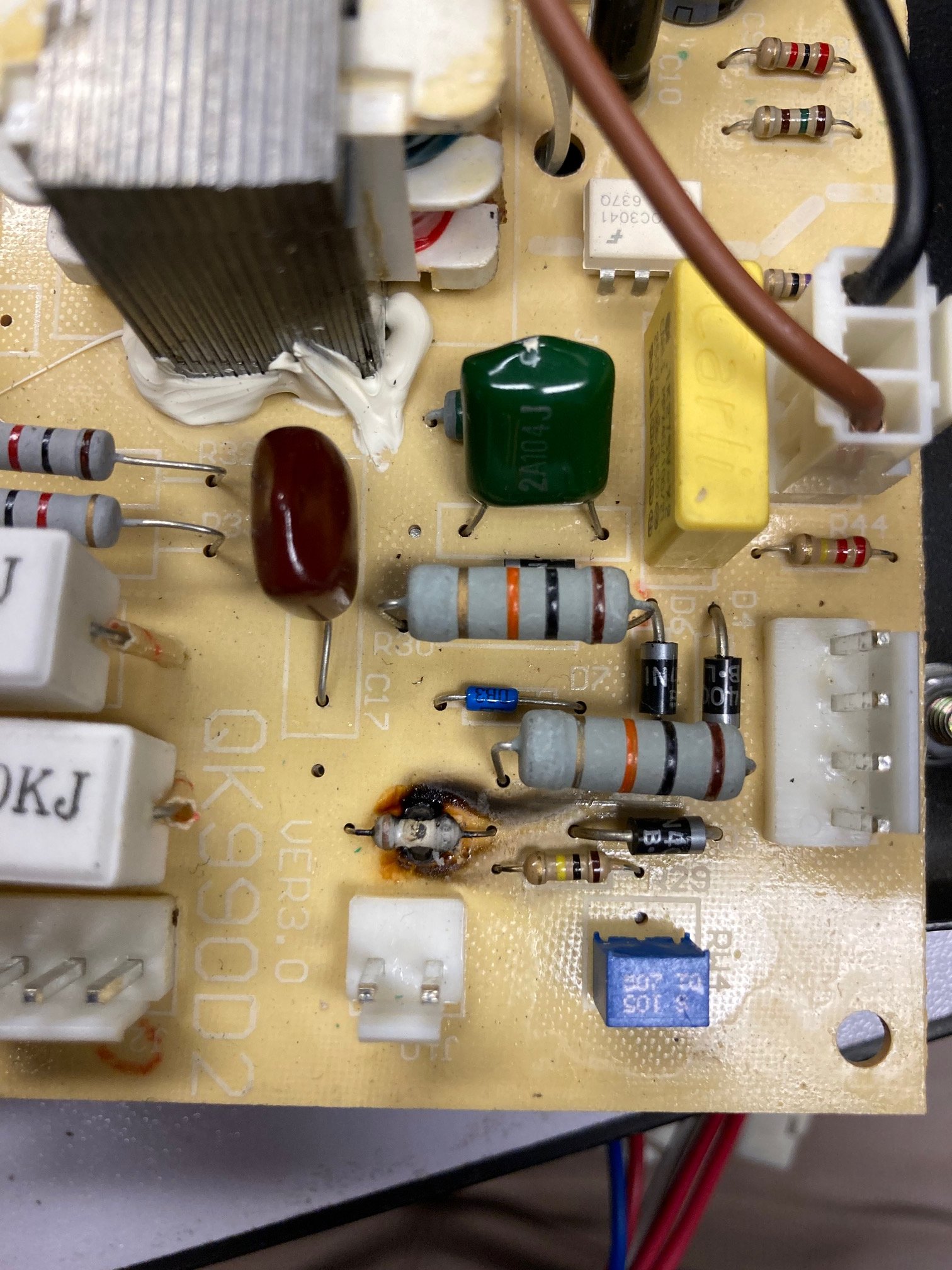

I fixed a hot air pencil today. It wasn't blowing any air, and there was a burnt resistor on a controller board yesterday when I opened it up. I couldn't find a schematic, so I slept on it & decided to put in an 800R 1W resistor to see what would happen. It powered up & the resistor didn't get hot, so I called it good.

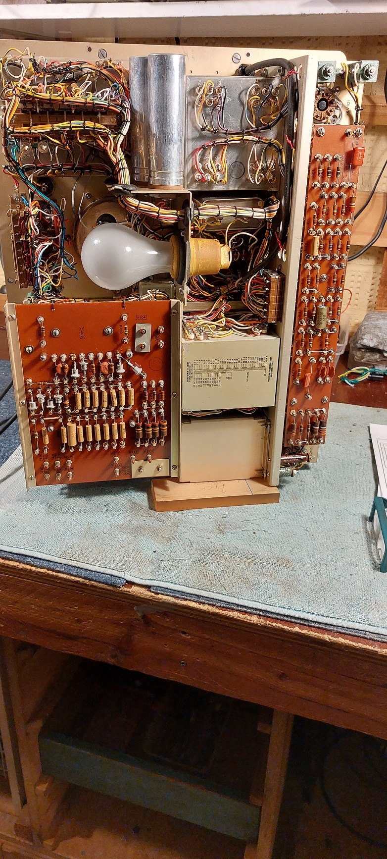

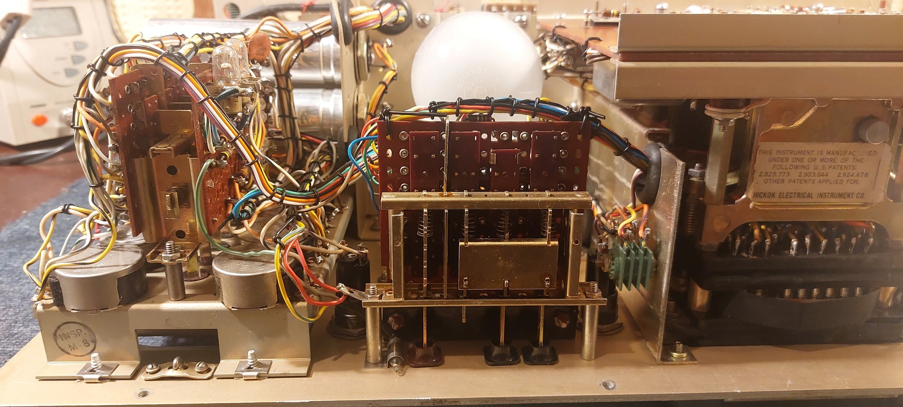

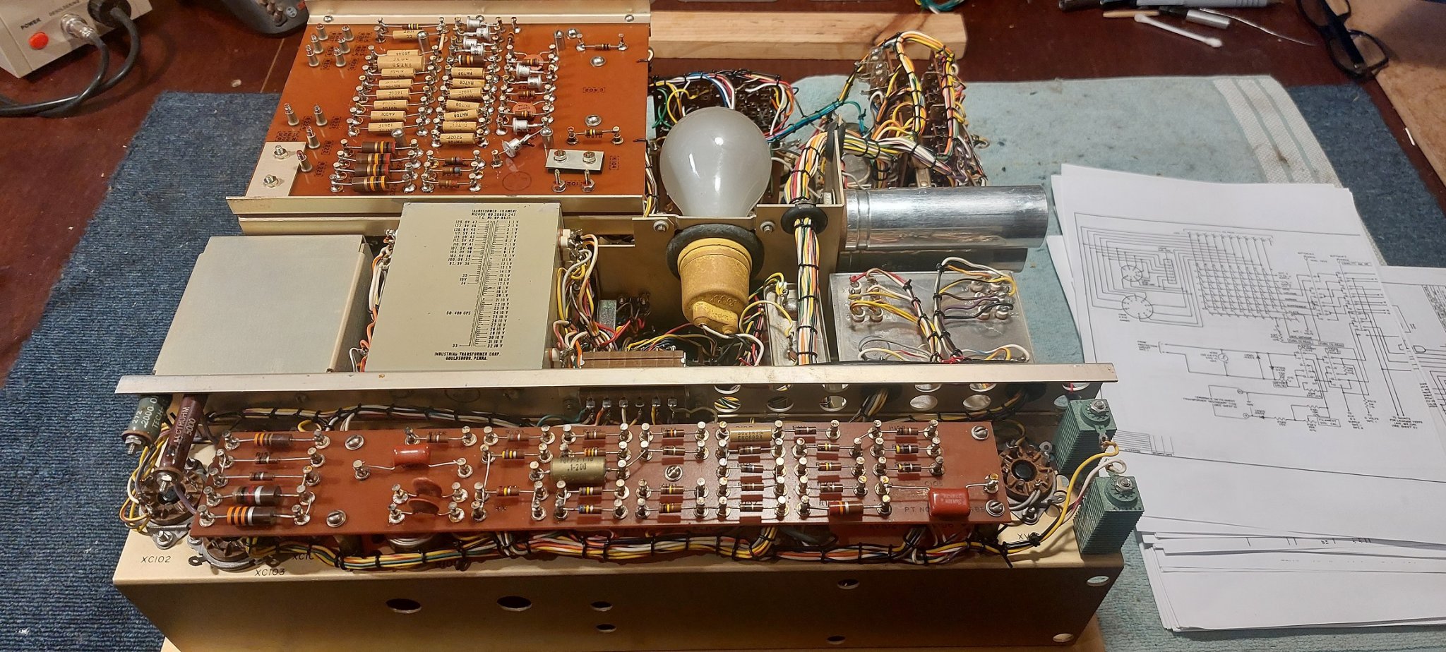

When does the light bulb light up?
The light is in series with a multi tap filament transformer, so it appears to be a form of current limiter.
This tester is pretty complex due to the 'cardomatic' punch card operation. There are almost 200 silver plated connection pins that are activated / not by the holes in punch cards.
All of the voltages for various filament / plate / grids etc are either transformer taps or switched resistors connected through the punch card switch matrix. That switching matrix
appears to be quite sensitive to mechanical setup and dirt etc which was one of the issues that had to be addressed.
It's a very cool piece of test gear - I'd love to own one.
PS The construction is 100% Aluminium for portability, the build quality is amazing. The transformers are all Al. cased and potted in (presumably) some form of Epoxy.

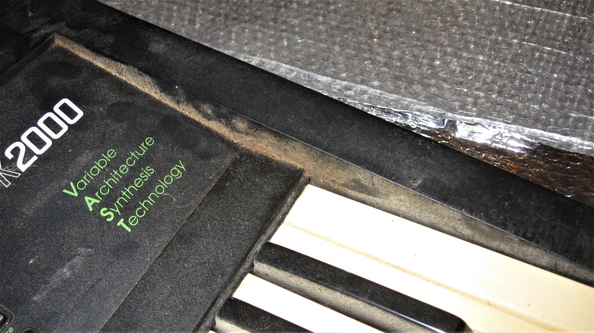

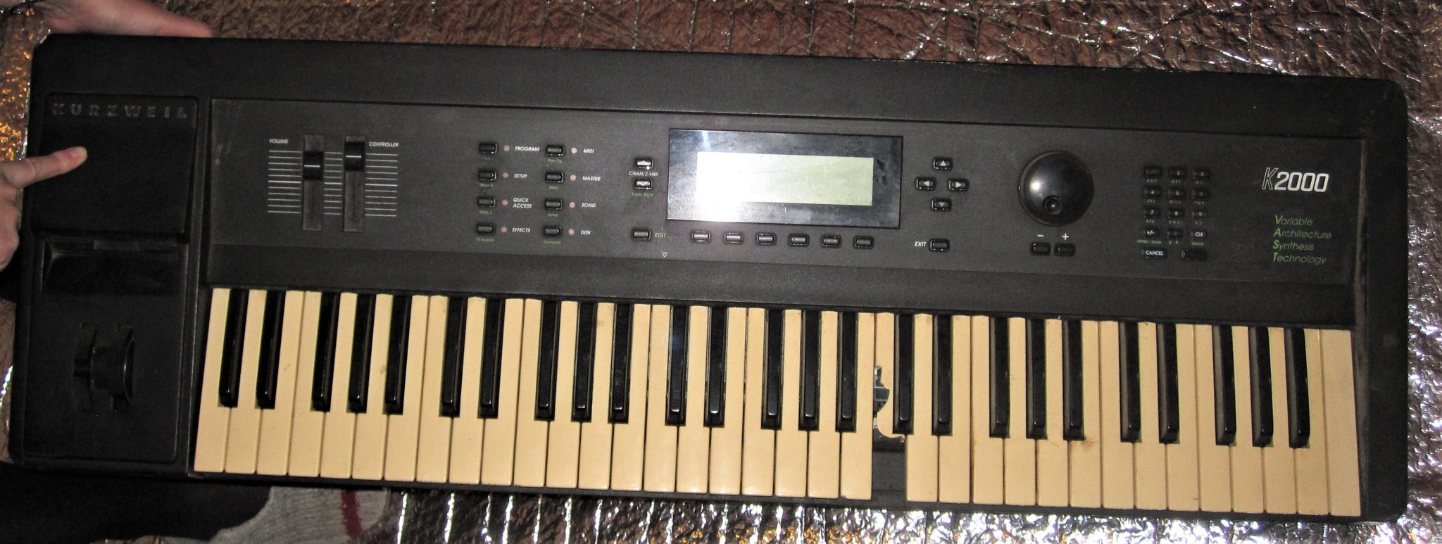

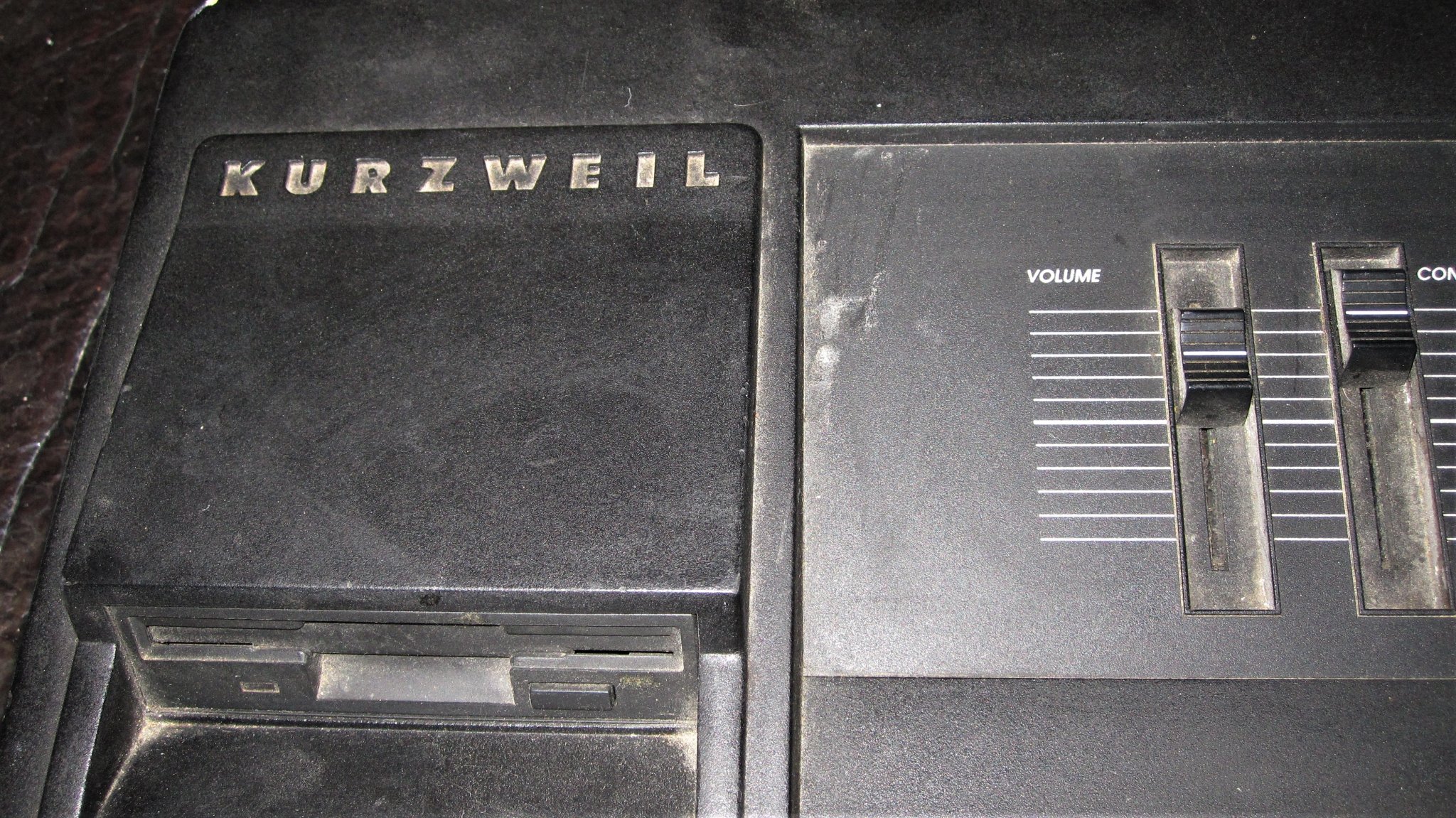

A very old, very battered Kurzweil K2000 v1.0, a rarity. This is a magnificent DSP-synth, extremely versatile, still holds its own 30 years after launch.
Common issue: LCD Backlight is dead. Other issues:
  • someone left a batter inside the compartment, and it leaked, corroding the terminals
  • bulging caps in PSU area
  • broken key, easily replaced
  • dust and grime - cleaned up
  • stuck screw not enabling opening it up easily - caused HDD damage, so replaced HDD with a floppy emulator that takes USB
There may be a chip replacement to be done as there is noise if using the internal Digitech Effects. Direct outs are fine.
There may be additional chip replacements to upgrade the firmware: O.S. + Objects.
