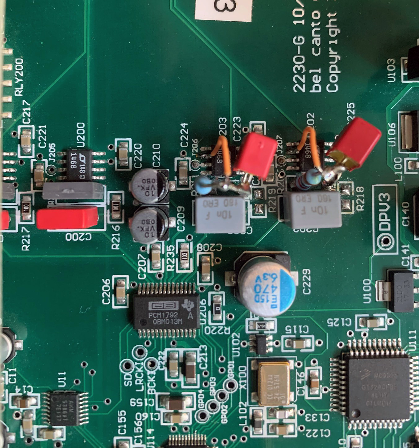

With some proudness I can say that I have successfully modified one channel of my Dac from active into hybrid.
First impression is that it seems to be working properly.
After having performed some tests with positive outcome, I will also modify the Left channel.
