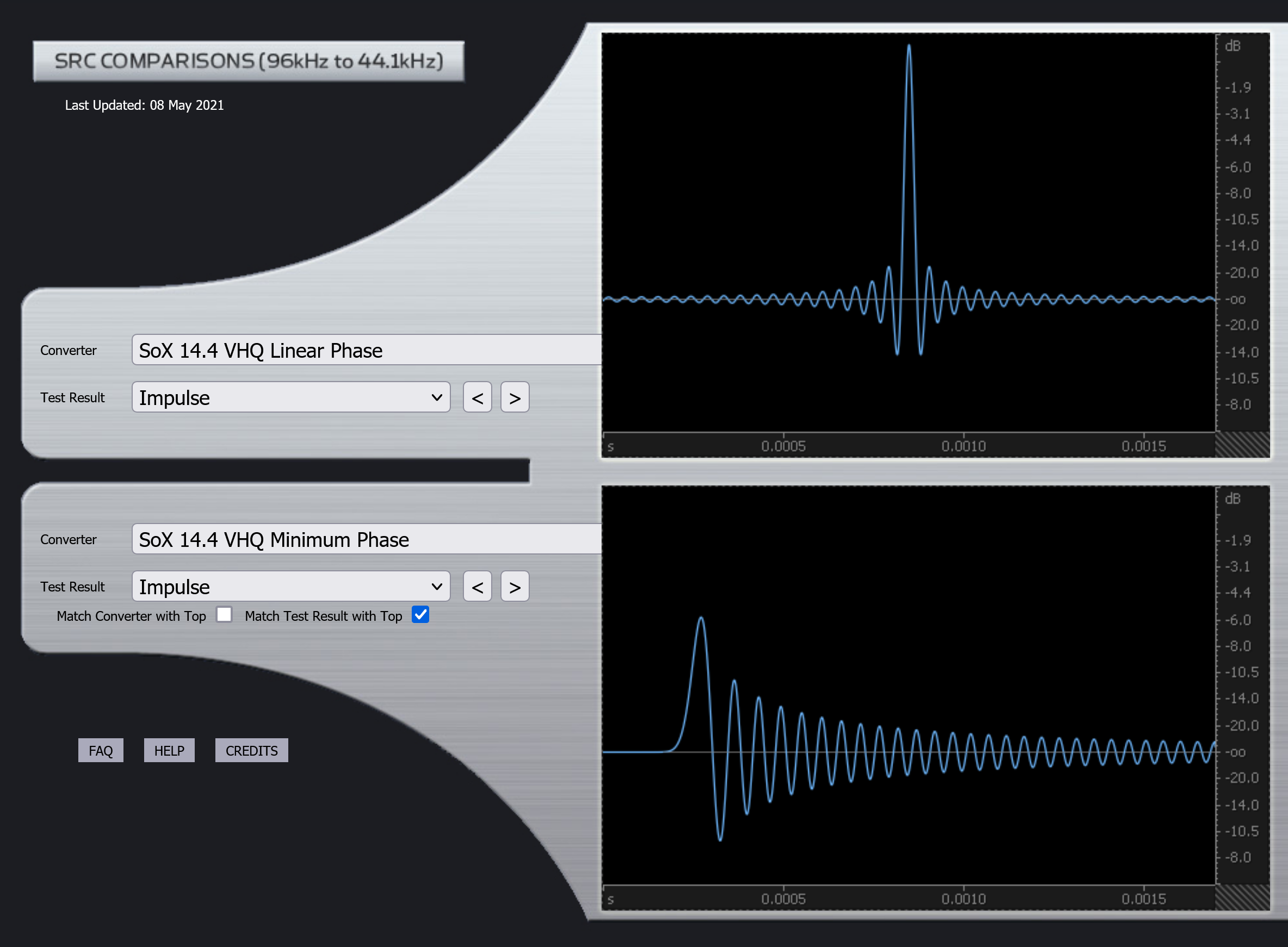

so many variables with upsampling and/or downsampling eg with SOX:

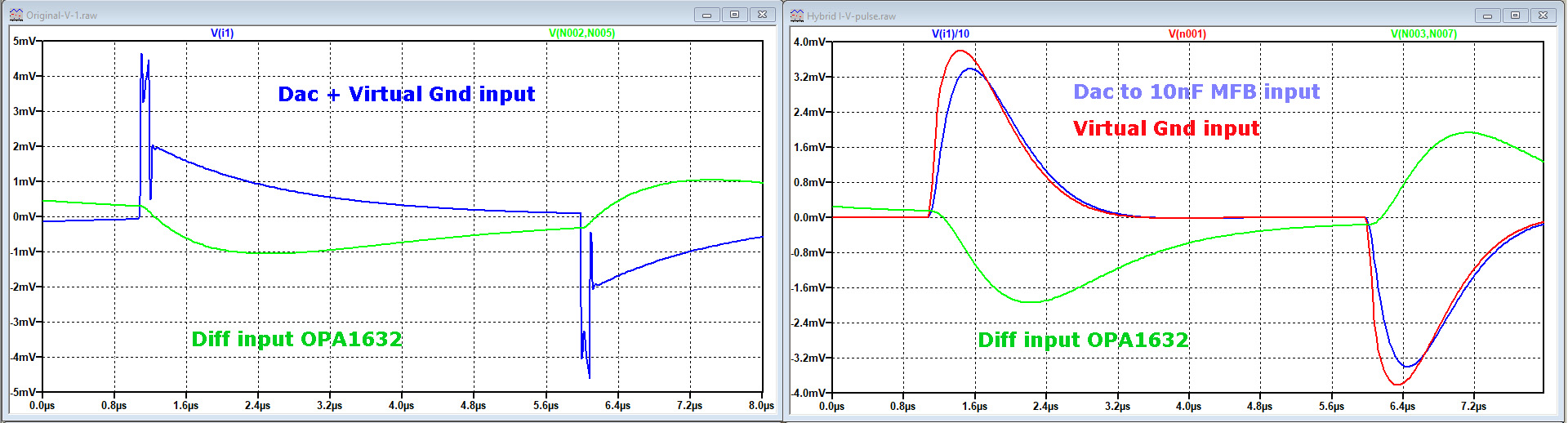

Anyhow, with my PCM1792 DAC, generating an output every 5usec., the biggest current step it will make is some 2mA from the +/4mA it can produce.
So I offered a square wave of that size from the current sources .
In the image below on the left side in blue the somewhat messy voltage excursion of the combined Dac output and Virtual opamp input with the used LT1486, however it stays within +/-5mV.
In teal the diff. input of the OPA1632, nothing spectacular here.
The right part of the image shows the voltage excursions for the MFB version.
Now in red the Virtual input of the LT1486 opamp, that is also within +/-5mV, but much smoother as before.
Also in teal the diff input of the OPA1632, that's again fully o.k.
But in blue the Dac's voltage output divided by 10 just for this image, to enable comparing the voltage excursions optimally.
So the Dac is making a voltage excursion of almost +/-40mV, where I think that the real DAC most likely reacts in a different way as in the sim, because not being a real current source with a high and constant output impedance.
Hans
