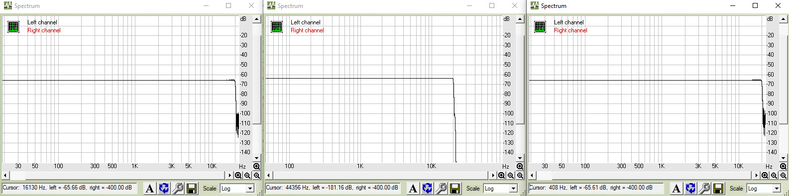

Just for information,
I prepared an impulse of 1 cycle at 44.1/16.
In Audacity I brick wall filtered the spectrum from 20Khz with a passband of 1Khz.
Spectrum of this file is the left part of the first image below.
Then I up-sampled this file to 192/24, see spectrum in the middle part of the image.
Finally back to 44.1/16 gave the spectrum at the right.

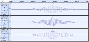

The second image shows the pulse in time, now vertically magnified in a log scale to get a much better view on the small details.
From top to bottom the original file after brick wall filtering, then the 192Khz upsampled file and finally the downsampled version.
At first sight, Audacity is doing a proper job, but Fir Filter length does not seem to be very long.
So a much longer filter would be nice to include in the test.
Hans

In addition to the sinc impulse function, we can see that the filter kernel is linear phase. Nice. I believe that Audacity utilizes the open-source SoX utility for floating-point resampling. While most of it's filter implementation details appear sketchy, I do recall reading somewhere that SoX is based on a Windowed-SINC filter engine. I couldn't quite determine from the response graphs whether or not it is also a half-band (-6dB @ Nyquist) implementation.
The PGGB resampler may prove our most ready alternative for obtaining a significantly longer filter to experiment with than SoX.
Ken,
When zooming further into the 192 file, I didn’t get the impression that it was using a half band filter.
The PGGB filter is definitely a big step forward in upsampling, but needs a dedicated processor, cannot transform a file into a .wave as far as I understood and it cannot downsample either.
So this seems the perfect candidate for comparing NOS to OS.
For the time being it would be nice if more candidates with a NOS Dac are willing to do the 3 file test.
Statisticically nothing conclusive can be said so far, which would be a pitty for such an interesting theme.
Hans
