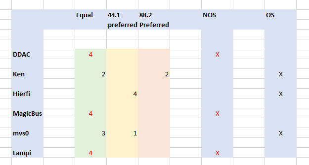

I have tried to summarize to the best of my knowledge the responses on the four 88.2Khz test in one sheet .
Although Lampi did not report on the 88.2Khz file, I have added him to the list because he repeatedly mentioned that a very good upsampler leaves the content intact on his NOS Dac.
It's also remarkable that the other two NOS Dac users noticed no difference between original 44.1 and upsampled 88.2 version, where the OS users had mixed results.
Since an OS Dac is mostly preceded by an SRC, this SRC will get a different job in interpolating/upsampling when starting with an incoming frequency twice as high, whereas the Dac chip may still be running in both cases at the same frequency. So perceived sound differences in that case will be caused by the SRC.
