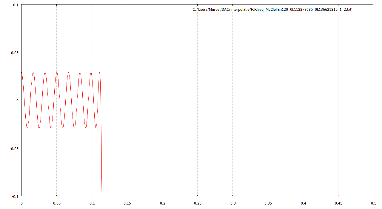

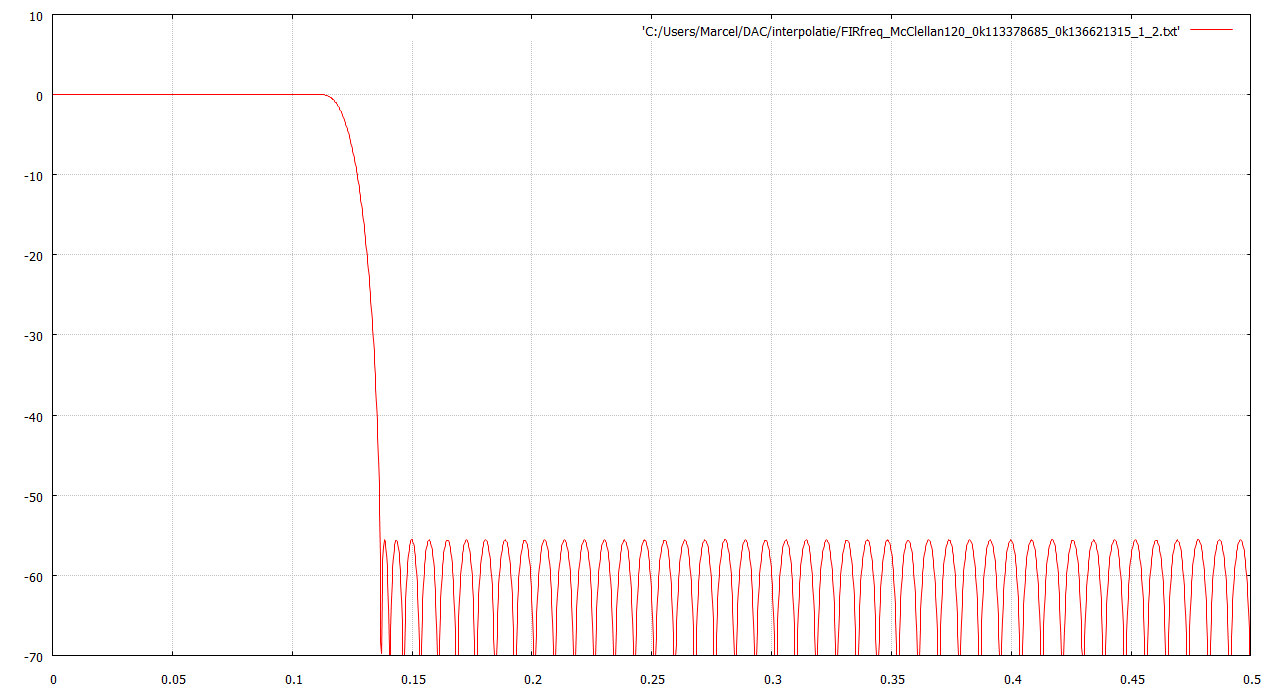

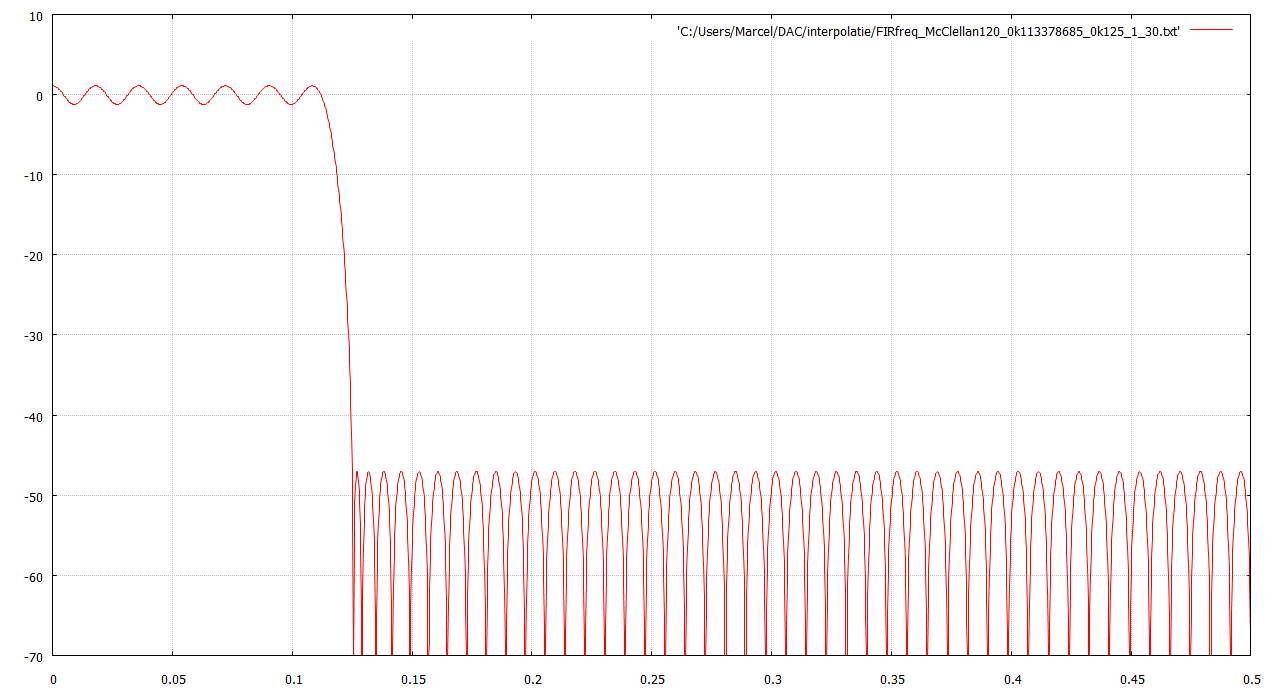

Does anyone know what kind of passband ripple classical oversampling filters such as the SAA7220 have, if any?
The datasheet only says it has a length of 120 taps and interpolates by a factor of four. A CD player I used to own with four times oversampling and TDA1541 DACs suppressed the 43.1 kHz image by about 62.2 dB when playing a 1 kHz sine wave (71.6 dB at 34.1 kHz, 68.16 dB at 54.1 kHz when playing 10 kHz). This includes analogue filtering, so I guess the stopband rejection is of the order of 55 dB.
Guessing that the transition band is from 20 kHz to 24.1 kHz and forgetting about droop compensation and coefficient rounding, that could mean that its response is something like the first two attached figures (vertical scale in dB, horizontal frequency divided by the 176.4 kHz sample rate). If its transition band stops at 22.05 kHz, it is more like the third picture, which doesn't even reach 55 dB of suppression and which has far more passband ripple. All in all, my best guess are the first two pictures (and the text file with the impulse response), but there is a lot of guessing involved.
Thx, Interesting to see.Does anyone know what kind of passband ripple classical oversampling filters such as the SAA7220 have, if any?.
We still had a lot to learn in those days about the damaging effect of ripple in the passband.
Hans
I extracted the coefficients from my SAA7220 and put them into LTSpice based on Kendall Castor-Perry's blog posts about FIR simulations.
The ripple all occurs on the part of the response which is rising to offset the 'droop' of the following Bessel filter so its difficult to get a precise reading. But it looks to be in the range 0.02 to 0.03dB peak to trough.
My sim shows in the region of 50dB but its not even, I guess due to only having 12bit coefficients.
Happy to share the LTSpice file if you'd like to have a play.
