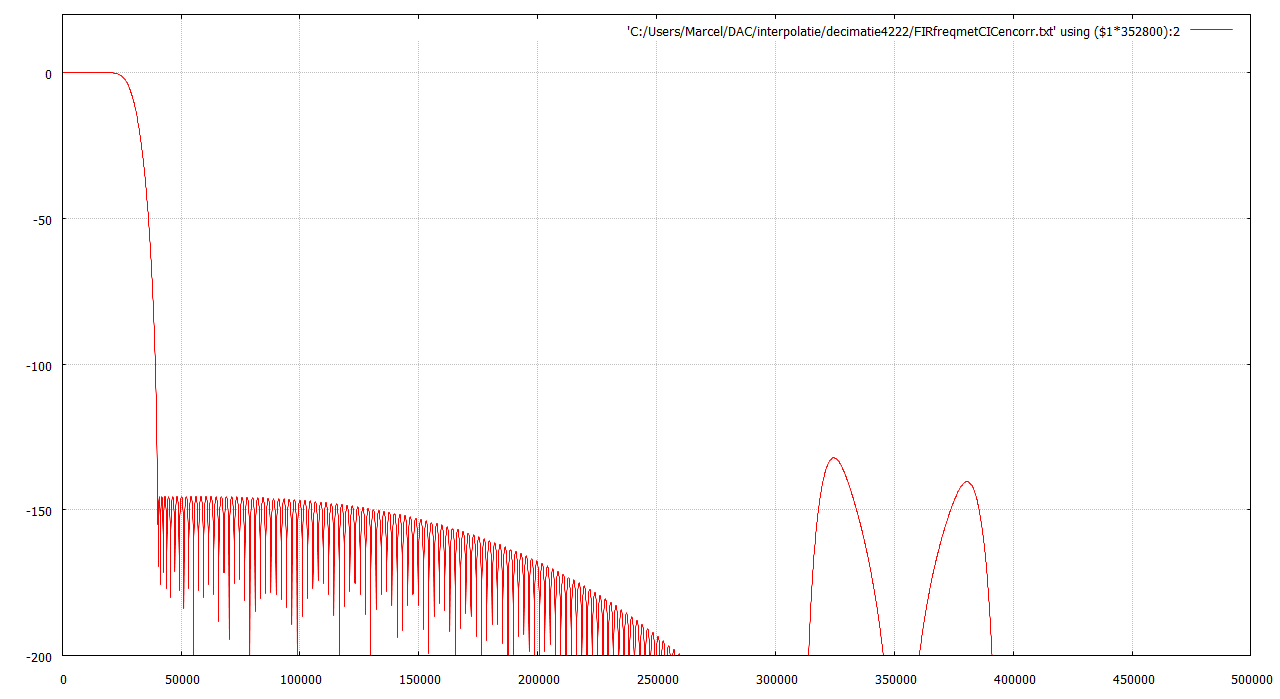

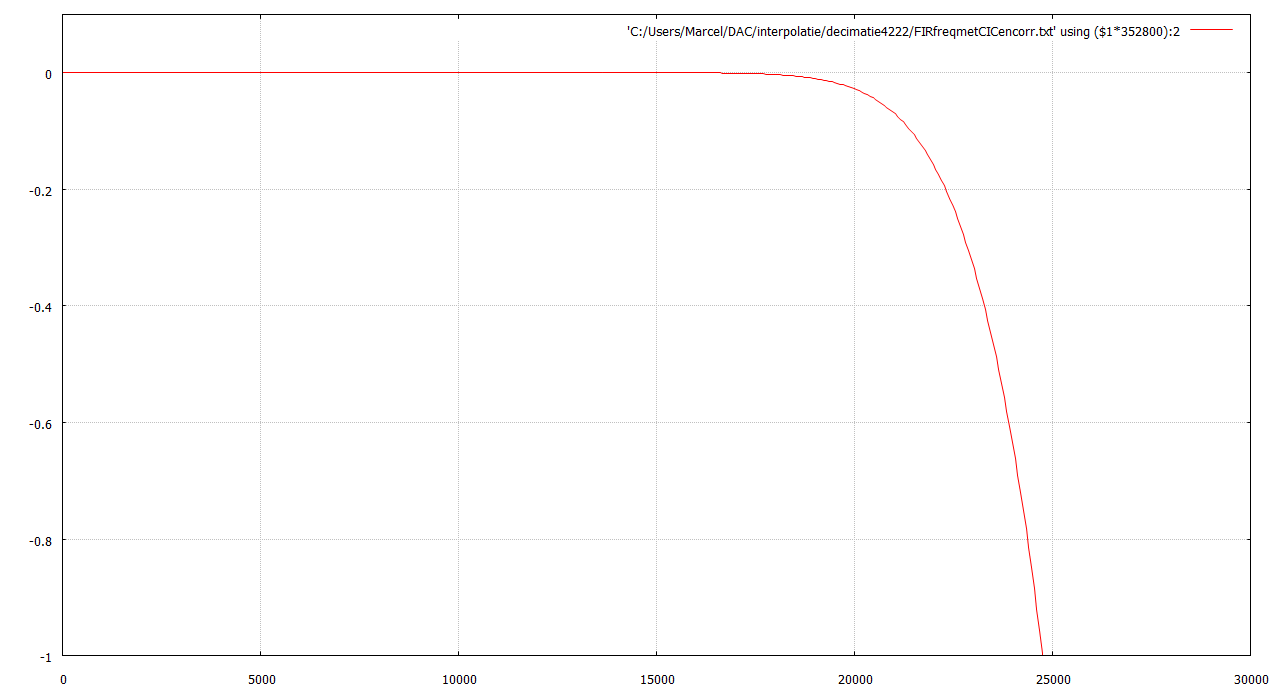

The issue with sampling is that it produces copies of the signal spectrum around all multiples of the sample rate. When you restrict the bandwidth to less than half the sample rate (a.k.a. the Nyquist frequency) before sampling, those copies don't overlap each other and don't overlap the desired signal. This is anti-alias filtering. When they don't overlap the desired signal, you can get rid of them when you convert the sampled signal back into a continuous time signal. You do that with another low-pass filter known as the reconstruction filter or anti-imaging filter.
Using brick-wall filters just below the Nyquist frequency gives you the largest possible bandwidth while avoiding aliasing and imaging, namely a bandwidth almost up to the Nyquist frequency. If you can live with less bandwidth because the sample rate is larger than the bare minimum, you can use smoother filters. For example, this filter is meant for 20 kHz audio bandwidth at 88.2 kHz sample rate.

A typical NOS DAC has a zero-order hold function that already droops to -3.1678 dB at 20 kHz at 44.1 kHz sample rate. If that bothers you, you may need some treble boost to correct for it. With linear interpolation, it would be -6.3356 dB at 20 kHz.

There is also a good reason to filter if you care about the substantial treble loss of a zero order hold. If you should want to equalize out the treble loss without causing phase errors, you have to do it with a linear-phase equalizer, while most analogue tone controls are minimum rather than linear phase.
A "Substantial" treble loss, I can't hear. I wouldn't notice on A/B tests, unless filters are degrading a sound natural properties, like (for me) the last test has proven, or would bring a digital 'glare' to a sound.
