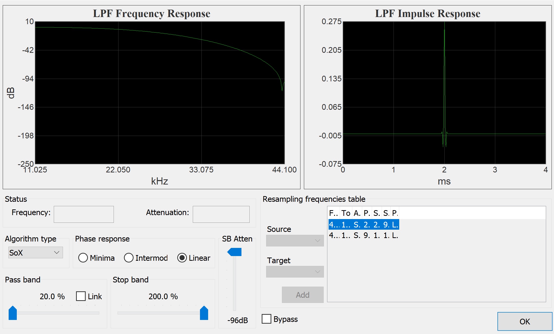

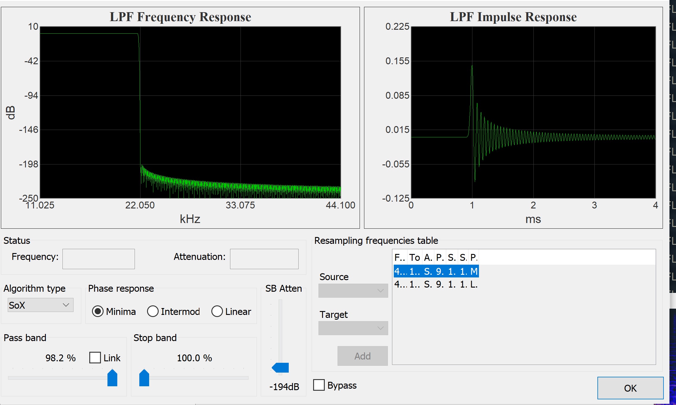

An easy test for someone with a true NOS DAC would be use a software oversampling filter that can let through different amounts of US while listening. Resampler-V in Foobar has sliders to allow that. Easy and free. Indeed resampler-V with Foobar allows listening to SOX, with control over most filter parameters in near real time:
