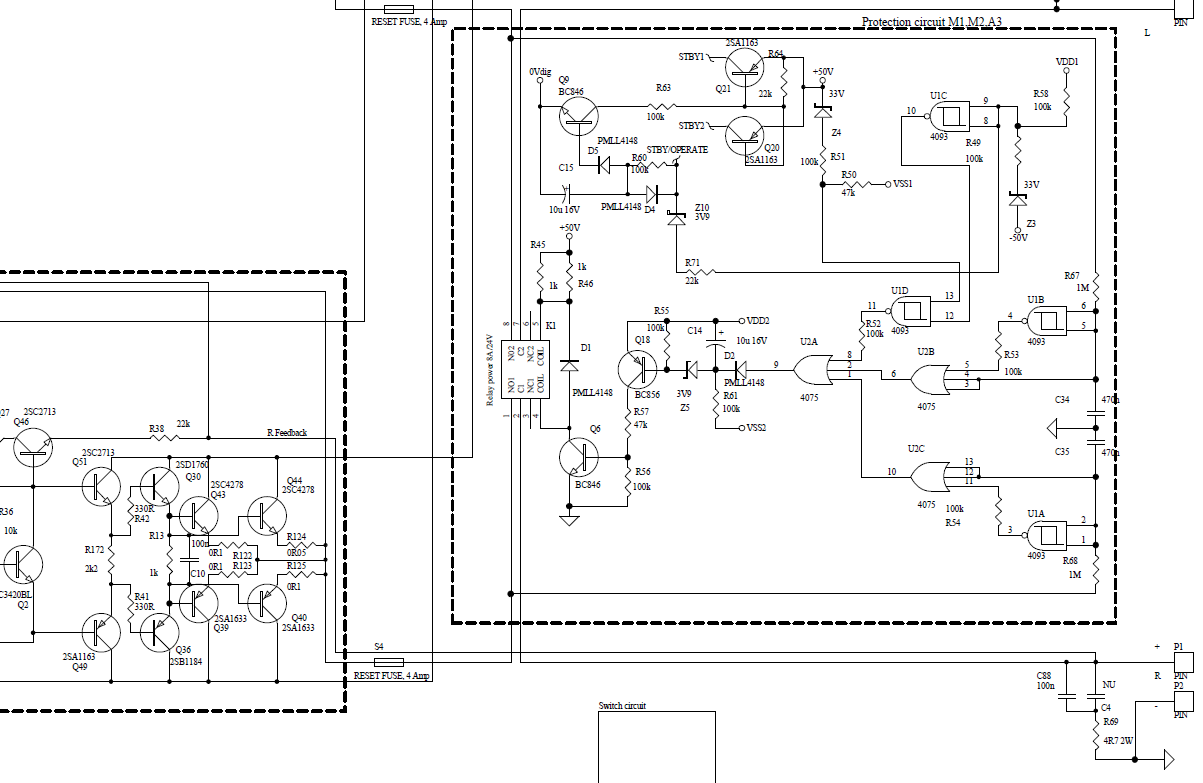

i would very appreciate if anybody could give a hint why Q32 has almost double voltage on collector :confused:
Q32 & Q12 have been replaced, C9 as well. Transistors haven't been shorted anyway, C9 shows 101nf as well.
R5, R4, R80, R81, R88, R89 are all fine too (even desoldered them to check).
I'm really stuck, it looks very obvious and simple, but if you are not skilled enough or haven't had a dozen of repairs, it's appreciably more complicated. I have specified collector and base voltages, emitter was used as a ground. The voltage in brackets is shown for the 2nd fine (I hope) channel.

Vbe multiplier stage Q2 (for idle current adjust only for the output buffer) is not conductive or the cascode VAS stage (Q24+34) is defective/faulty (Q34 collector 0V !!!).
for the benefit of other readers and members who are trying to repair these nasty piece of metal chassis (I have no other words for Thule amps) with one of the worst pcbs I've seen in hi-fi gear (it is only better than 30 year old Philips CD350 I owned), check the pre stage and in particular LM chip that is responsible for volume adjustment. Mine Spirit had the fault there. Replacing the LM chip fixed the problem.
