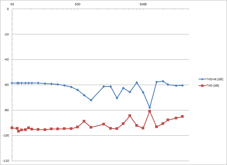

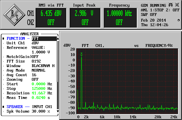

Well, using the same Bink free audio CD test disk, I was able to measure the analog output distortions. All test tones were 30 seconds of -1dB level, the analog autput was almost exactly 3Vpeak (remarkably constant over the 50Hz-20KHz band).
Results are attached (sony_cd_distortions.png). I have no idea if these are good or bad for a 10quid second hand CD player. I found quite peculiar the THD drop at 6300Hz and the corresponding rise in THD+N at the same frequency.
One to another, this player has a THD+N of better than 0.1% and a THD of better than 0.01%. Obviously, the noise dominates the distortions at (almost) all frequencies.
I was though completely unable to hear any noise in the speakers. Measuring bandwidth was 100KHz, so I took a look at the output spectra at 1KHz (attached) in the 50Hz-25KHz band. Nothing really special, the 2nd and 4rd harmonic are dominant, some residues of the rest (50_25000_sony_spectrum.jpg).

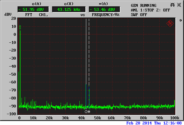

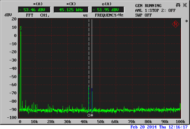

However, the 50Hz-100KHz spectrum reveals the source of the noise: two very distinct out of band spectral components, at 43.125KHz and 45.125KHz (50_100000_sony_spectrum_43k.jpg and 50_100000_sony_spectrum_45k.jpg) Being out of band at 1KHz, they don't count as THD, but count as noise.
I tried another audio CD disk (a Sony) and got exactly the same behavior (and amplitudes) at 1KHz, so definitely these components are generated in the Sony player. I took a look at other test frequencies and concluded that these components are always at the 44.1KHz +/- F (F is the test frequency). These components do not seem to create any major intermodulation products in the audio band, so I don't think they have any audible impact. These spectral lines also explain the sudden drop in THD+N, correlated with an increase in THD: when they fall in band, they are added to the THD and subtracted from the THD+N balances.

Those two extra components will be at 43.1kHz and 45.1kHz. They are the first two images of the 1kHz signal. They should not really count as noise. A perfect reconstruction filter would have removed them.
The peculiar behaviour at 6300Hz is probably an artifact of the FFT. 6300Hz is exactly 1/7th of the sampling rate.

They are not really noise, but are counted as noise by the analyzer, as long as they are out of band.
No FFT artifact, simply 6300Hz generates in band components.
44.1KHz-6.3KHz=37.8KHz which is exactly the 6th harmonic of the 6.3KHz test signal. Being in band, when calculating the total harmonic distortions, the 6th harmonic adds to the THD, but is subtracted from the noise. Therefore, THD+N goes down and THD goes up. The same with 44.1KHz+6.3KHz=50.4KHz, that is the 6.3KHz 8th harmonic.
Haven't checked the inside D/A chip and the reconstruction filter specifics.
