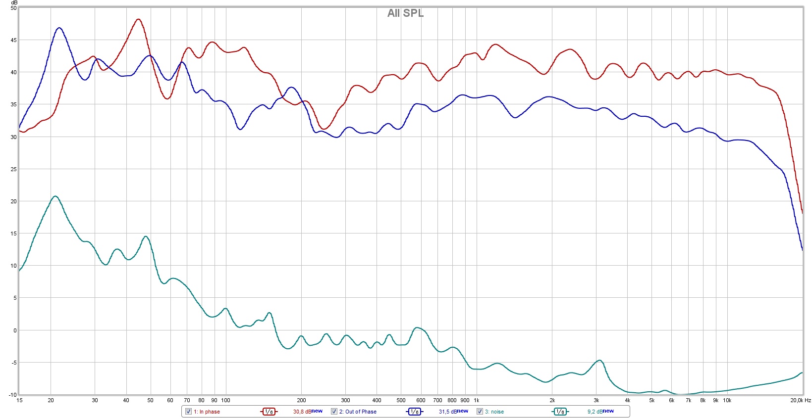

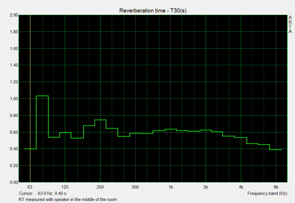

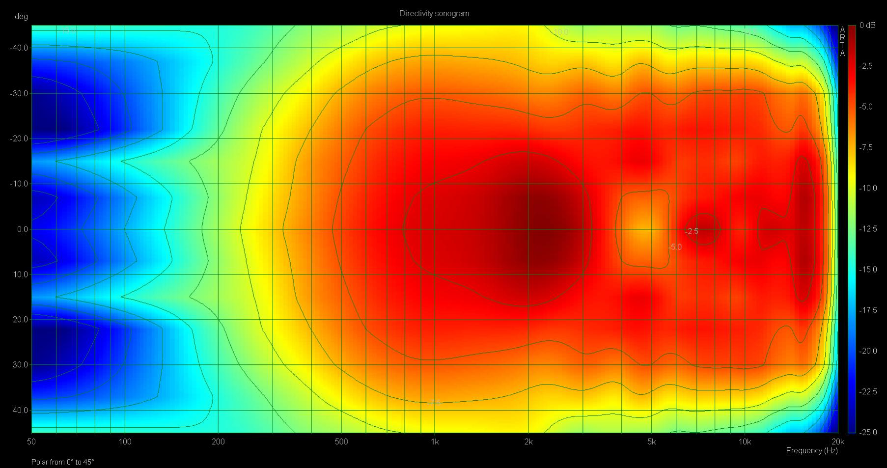

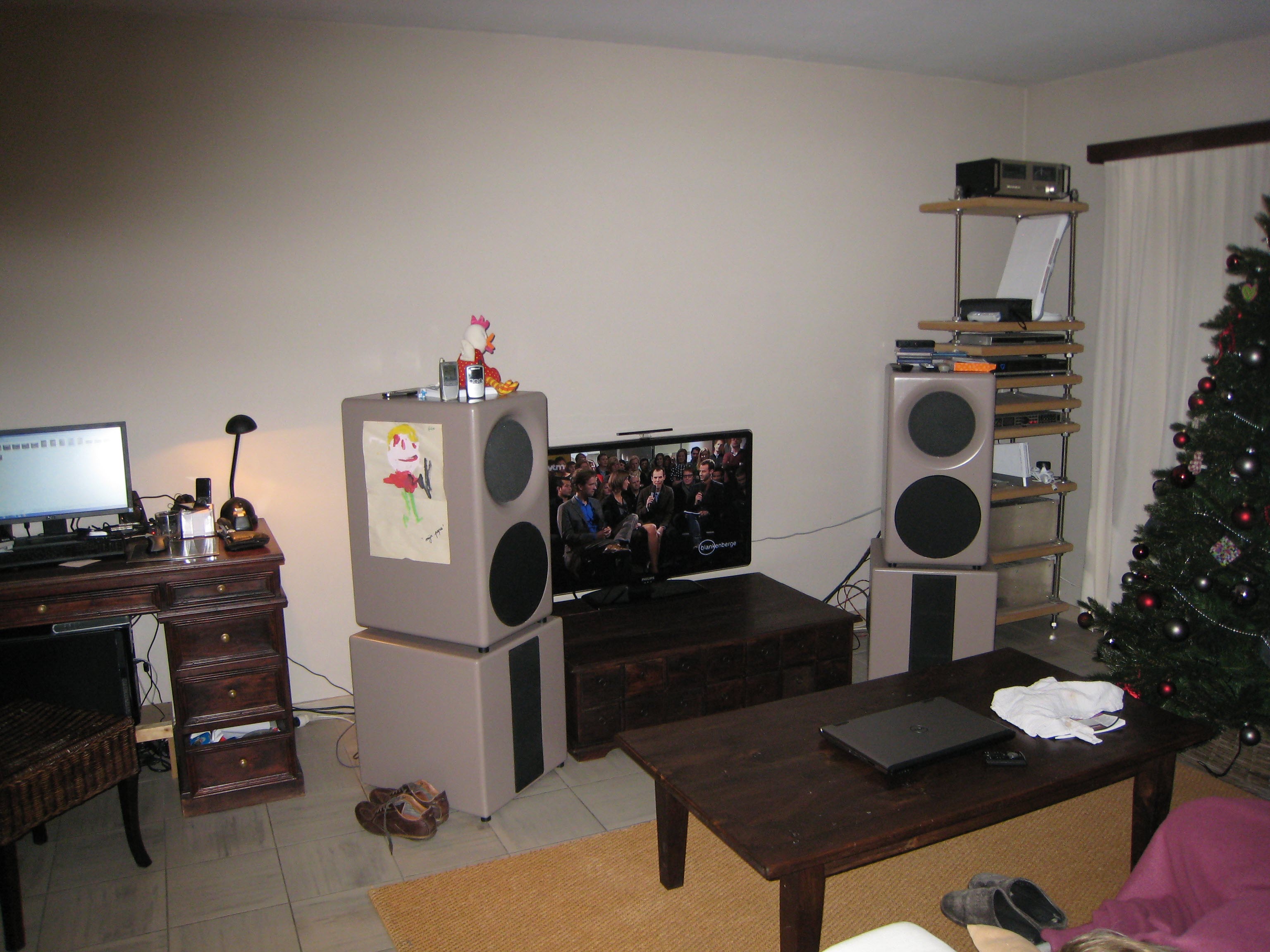

Pretty late, but here is my in and out of phase measurement... Room is L-shaped with brick walls, tile floor and concrete ceiling. RT is around 0.6s. There is no room treatment, but any suggestions that are WAF friendly are more than welcome...
Edit: added polar responce also (remark: only from 0 to 45°, other angles I did not measure... Measured without sub and without gating inside)
Nicely uniform through the upper range. A 0.6 RT is a little lively but the directivity of your horns looks like it balances it out nicely.
This is a point that I've tried to make in this thread: as much as we debate the merits of higher and lower directivity, the room has as much a contribution in the overall direct-to-reflected ratio we perceive.
You have a reverberent room and directional speakers, the next person may have a dead room with very wide angle dispersion speakers. You may both hear the same results from your system.
For WAF, I've hung a nice orriental rug on one wall, and we have heavy velour drapes for a second wall. Let her pick the colors.
