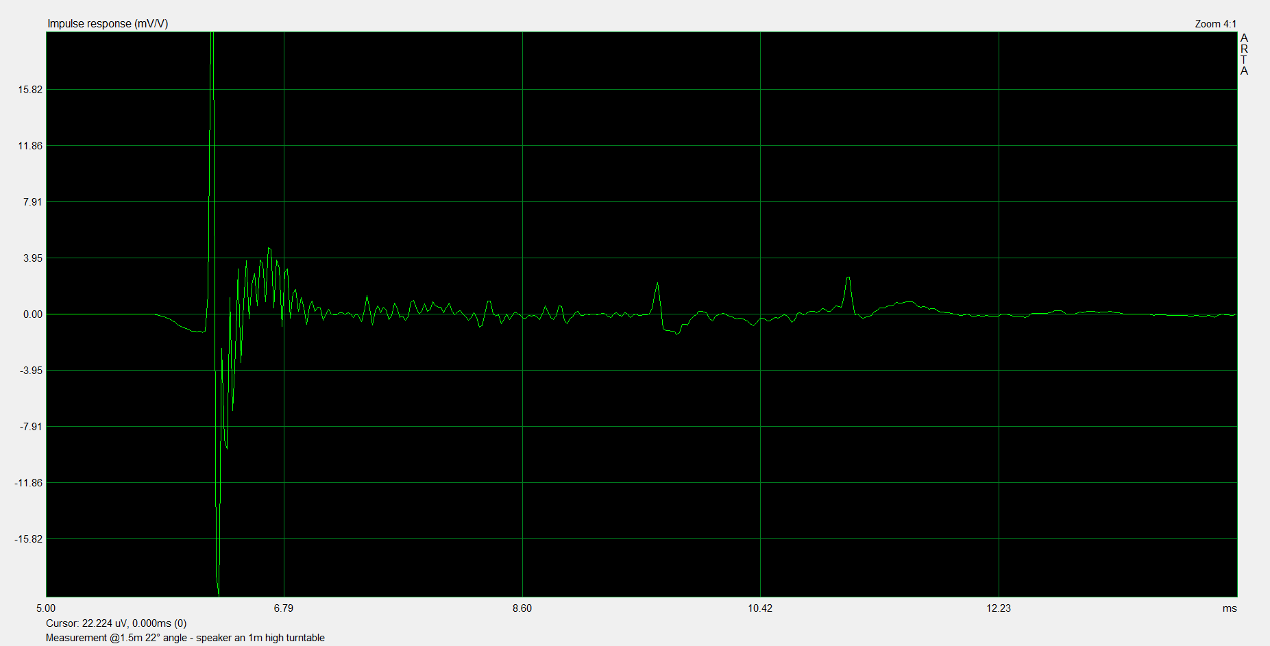

Does your system has a 10ms reflection free zone? I barely get 3.5ms when I place my system in the middle of the room on a stand for measurement purposes (see attached impulse response) At their normal position, it is even worse.
So to really appreciate the effect of (almost) no VERs, we need to figure out how to make good vertical directivity also...

Yes but what I think is important to remember is that the impression one gets is the result of several separable things, the recording, the loudspeakers and chain and the room.
What seems weird is that there are a lot of assumptions made about what is desirable with little or no reference to the condition where there are no room reflections at all.
What does the recording and reproduction chain alone sound like (without the room)?
Set up omni (or any) speakers outdoors and sit in the normal configuration and listen to what NO room effects sounds like as a point of reference. Do this away from buildings if you can, try your favorite recordings and focus on imaging.
In this case, omni’s or any speaker could image superbly or not, depending on the loudspeaker itself because that is another variable. All good Loudspeakers do not image equally well, not by any stretch of the imagination, there is a large variability here to.
So far as room reflections being desirable, I think it’s hard to say that once you spend an afternoon or two with good imaging speakers outdoors with no reflections I bet many would say more like they are only unavoidable.
Directivity when compatible with the geometry is only fix other than large scale room treatment to extend the near field farther into the room.
