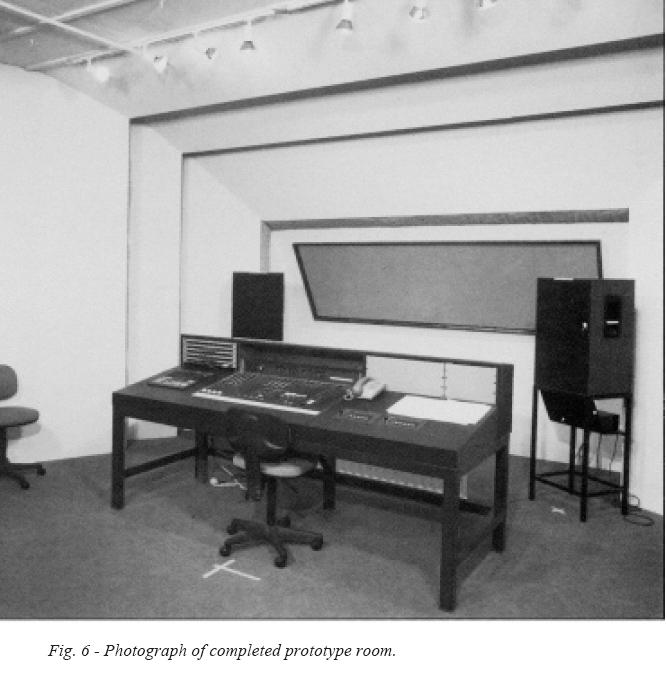

Ran across an interesting paper the other day worth discussion.
http://downloads.bbc.co.uk/rd/pubs/reports/1995-04.pdf
R. Walker of the BBC looked into the geometry of studio monitoring with the goal of creating surfaces around the monitors that made sure all early reflections bounced the sound rays well away from the listening position. He was aiming for no reflections within 20dB of the direct sound for the first 20 msecs. He later found that 15dB for the first 15 msecs was generally good enough.
Since specular reflection isn't a great assumption for lower frequencies he had the computer look for surfaces that kept the rays well away from the listener, outside a surrounding circle.
A big part of his motivation was that the studio users weren't happy working in overly dead studios. This approach let them cut back strongly on the amount of absorption they used.
He verified the results with listening tests, energy time curves and 3D frequency response (FR vs. time).

No takers on building to this concept, eh?
It answers what has been forward as an ideal in this thread: You can have a lively room and speakers of any directivity, including wide directivity, while still achieving a dead period in terms of early reflections.
The author gets lower early energy than you could achieve with diffusors. Probably lower than you could get with especially directional speakers. You could also use the concept with dipoles to good advantage. Since they send little energy to the sides where it would contribute to spaciousness, and much to the rear wall where it can cause problems, this approach would let you redirect the energy in a more beneficial direction.
You also don't need as complex a surface as this. If you have a well defined seating position you can simply put large reflectors at the wall bounce points of the reflections you want to "divert". Plus diffusors at points where you want reflections from (wide sidewall angles).
You could certainly experiment with free standing plywood reflectors, or even foam core.

It's certainly an interesting principle, however I suspect the WAF may not be sufficiently high for many

My ceiling diffusor is basically along these same lines and I can tell you that it works, although its not perfect, but its not very practical or easy to do. And WAF - forget about it!
I don't think that too many of us have "experimental listening rooms" that we can do this kind of thing in. I don't. My room is not big enough to accomodate anything like this along the side walls. And my room is way above average in size. As I said before, great idea, not very practical in a home situation.
