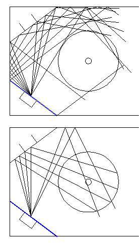

I was trying to combine it with some CD racks in a basement. Basically still try to do some absorption of reflected waves after they have traveled to the back of the room while still applying a similar concept to reduce reflections from the back wall reflecting back to the listening area.No takers on building to this concept, eh?
It answers what has been forward as an ideal in this thread: You can have a lively room and speakers of any directivity, including wide directivity, while still achieving a dead period in terms of early reflections.
The author gets lower early energy than you could achieve with diffusors. Probably lower than you could get with especially directional speakers. You could also use the concept with dipoles to good advantage. Since they send little energy to the sides where it would contribute to spaciousness, and much to the rear wall where it can cause problems, this approach would let you redirect the energy in a more beneficial direction.
You also don't need as complex a surface as this. If you have a well defined seating position you can simply put large reflectors at the wall bounce points of the reflections you want to "divert". Plus diffusors at points where you want reflections from (wide sidewall angles).
You could certainly experiment with free standing plywood reflectors, or even foam core.

I was doing some tracing yesterday and as you can see from the attached image, by doing little more than extending the flat baffle out until it touches the side and rear walls I could be redirecting the rear and both sides.No takers on building to this concept, eh?
You have the plane of your reflector sheets pointed back at the speakers, ie. they are not broadside toward the speakers, is this correct?My ceiling diffusor is basically along these same lines and I can tell you that it works,
I would have assumed the opposite, but then that would produce a Freznel style reflector (with frequency limitations) and I guess yours wouldn't be acting that way?

While I do like the concept - and my room is of a very similar size - but I ain't sitting anywhere near that close. So I'd have to figure out how and if it would work for my listening position in my room. I do not want to sit that close to the speaker wall. Would you?
